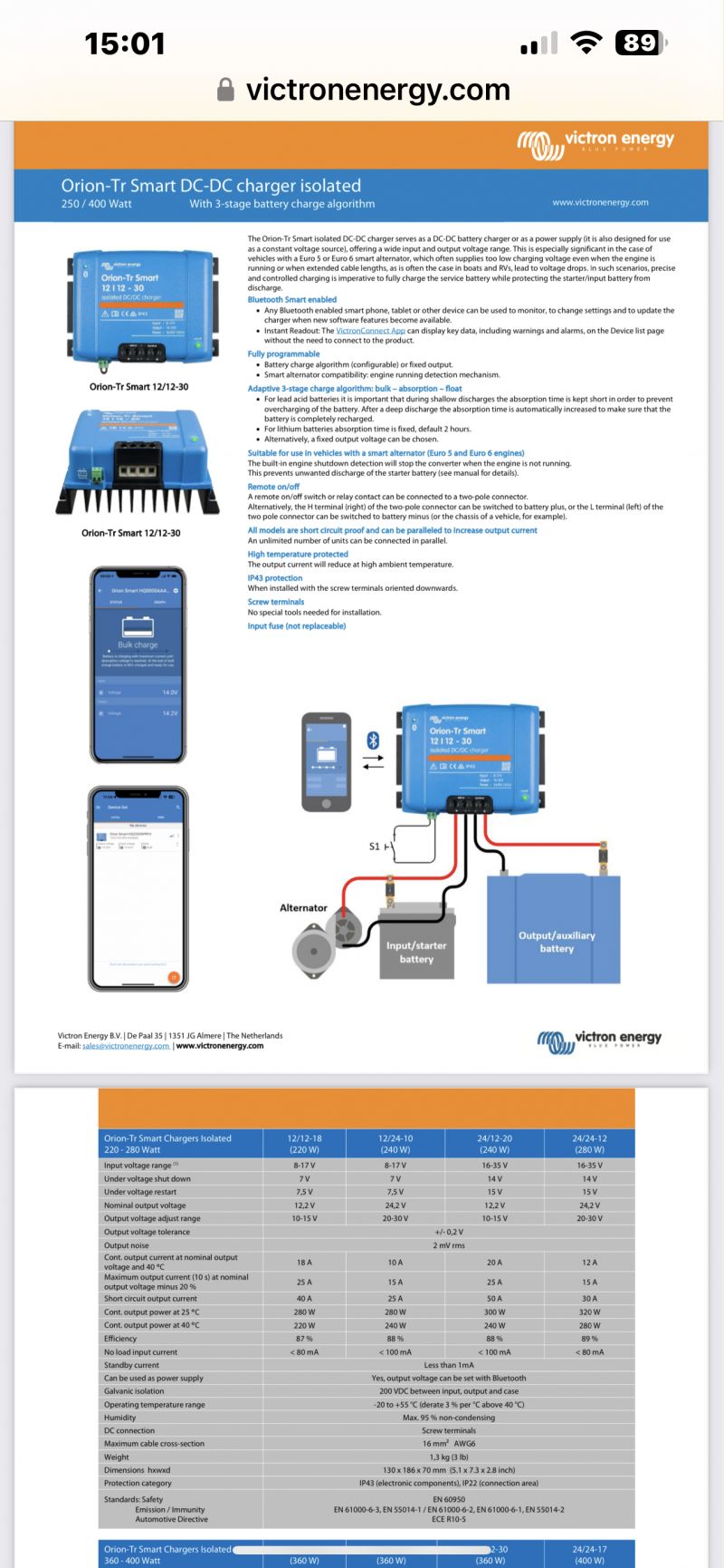

My present van camper has tthe hd factory alt option and a 50 amp limited Victron DC-DC that works very well with the vehicle alt. $300 but I don't need to bother with carrying a generator, plus have rooftop solar.
# Posted: 6 Oct 2024 10:22pm
I saw that Victron car charger that looks like it does both bat types. Still at the cabin escaping the unusual heat wave going on another day. Did a couple things, first I moved the Meanwells charger the gen uses and it’s loudish fan from inside next to the bank (and bed) to outside, no noise except for the outside gen of course.

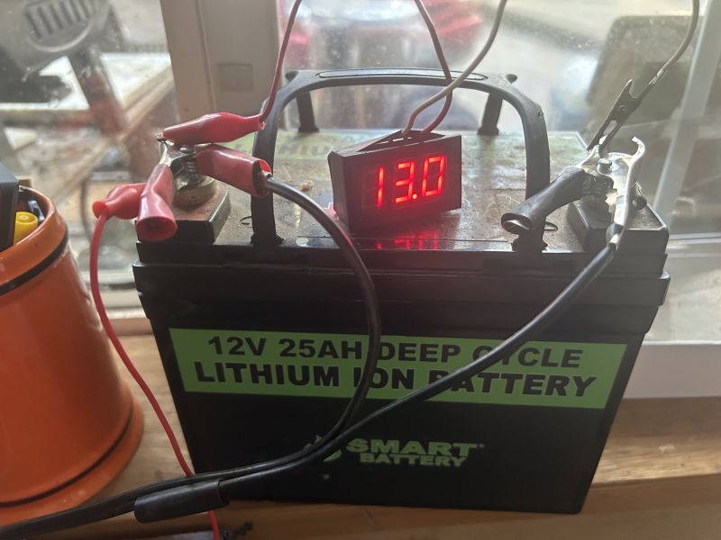

While I had the 500AH bank disconnected, I jumpered in this 25AH spare Li battery I have just sitting around for a test run, in case one day I’m stuck with that for whatever reason. It did pretty well, ran the TV and fridge for about an hour and still at 13v afterward, though it did go down to about 12.7 when the fridge ran.

That 25ah will run a lot longer if you don't run the fridge or other high draw devices off it. A fridge will stay cold for quite a few hours if you keep it closed.
It will do as much and more than my Ecoflow River 2 in terms of battery, just without the internal charger, inverter and various receptacles.
Will it fit in a plastic ammo can (Harbor Freight cheap)?
If so add some 'ports and posts', etc to make it an easy hook up. Lots of info online of such.
Be sure to fuse it!

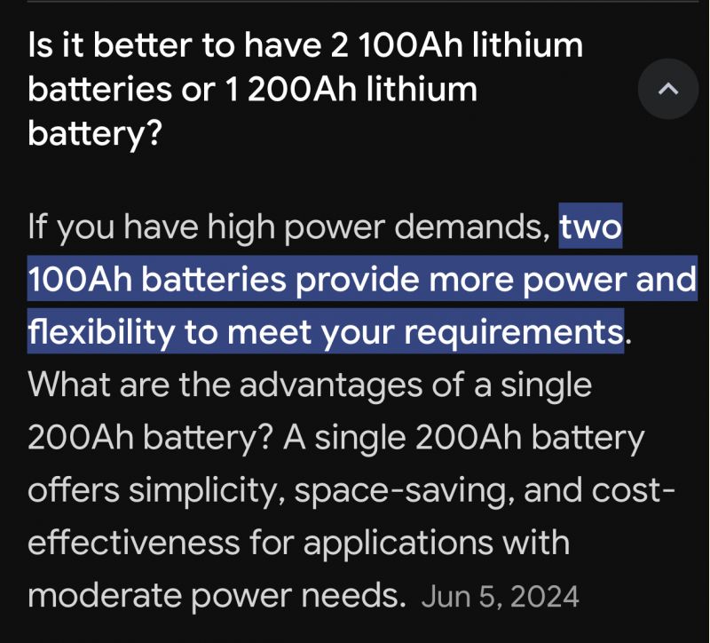

I get the flexibility part but why would 2 100ah batteries give more power?
# Posted: 19 Oct 2024 01:22pm - Edited by: ICC
more power
Depends. Depends on the battery and how one defines more power.
More instantaneous power? If I use SOK, for an example, they have 12 V 100 AH and 12V 206 AH batteries. Both have a max recommended continuous discharge rate of 100 amps. If we connect 2 of the 100 AH batteries in parallel we would have the equivalent in total capacity of a 12 V 200 AH battery. But we could theoretically draw up to 100 amps from each of the batteries at one time for 200 amps total. The single 12 V 206 AH battery could only supply 100 amps.
However the two 12 V 100 AH contain basically the same watt-hours of total energy as one 12 V 206 AH battery. (OK, the 206AH battery has a slight advantage of 6 AH)
If you have a bigger inverter and need the greater amp draw, 2 parallel batteries make sense. For smaller maximum loads a single battery is simpler. If redundancy enters into your thinking that changes things. And if you search you might find batteries with different discharge rates that could work better for person A but not person B.

OOoppppssss a Math Error snuck in !
@PaulZ I believe that is likely more of a reference to Wh as opposed to deliverable Amps.
12V/100AH = 1280Wh/1.2kWh.
12V/200AH = 2560Wh/2.5kWh
A 100AH Battery (with 100AH cells) can ONLY deliver 100A continuous discharge & accept 50A Charge.
A 200AH with 200AH cells can deliver 200A Contiuous & take 100A Charge.
-* BMS limitations excluded. Most BMS' will allow for some limited (a few seconds) of Burst Discharge sometimes that is a factor of 1.5 or 2.0 X the default continuous output. Again, dependent on the BMS used.
2x 100AH Standard Battery Packs can output 200A continuous collectively & take 100A Charge collectively as well. Their Collective Surge handling is also improved (helps with motor starts like a well pump/AC/Freezer etc).
NB: Surge Handling by a BMS is generally capped @ 1.5X normal Rating for 5 Seconds only. Some stretch that capability a bit or do other things to allow for large surge handling.
The BONUS of 2 Battey Packs is that if one shuts down for any reason the other keeps going (unless they are both at Low Volt Cutoff).
More packs in Parallel divides both the Load & Charge by the number of packs. It is also far gentler on the individual packs which increases lifecycles considerably.
