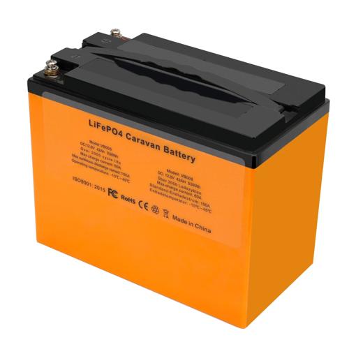

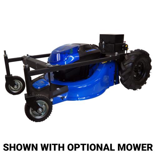

I am a little concerned. The RC lawnmower I bought says to do not leave it unattended while charging. Do these batteries ever have problems when charging?
Shenzhen 12.8V LiFePO4 Battery 42Ah

This week, One charged up, the other has been on the charger for 24 hours and is not charging. It's only a year old. I switched chargers, no luck.
Edit: If I have to buy a new one, did you guys who have LiFePO4 batteries use a manufacturer other than Shenzhen? Other Chinese or USA made?

I cut the goop off of the battery posts and did a voltage reading. 0.20 and dropped to zero fast. Did that three times. Connected the charger, checked voltage at the posts, 14.6 Vdc. So it is charging without the jump. Hobotech did say in his video some chargers will send a charge with the Batt at zero volts. I will check to see if charged in a couple of hours. Got a feeling this Batt may have given up the ghost. Shame, if it only lasted one year. Be back later. Thanks guys!

Dave, are LiFePo4s the battery type recommended for your setup? Does the mower run on both batts (24v)?
# Posted: 30 Jul 2024 12:41am
The 42AH LiFePo4s are an upgrade to their standard configuration, 11AH. Yes the LiFeP04 is the only choice. Yes it runs on both batts, 12Vdc motors, one for the right drive motor the other for the left.
Charged the right side battery for six hours today, still dead, charger still supplying 14.4 Vdc. The battery is dead, or the BMS.
I sent an email to Super Droid Robots asking them to replace the battery since its only two years old.

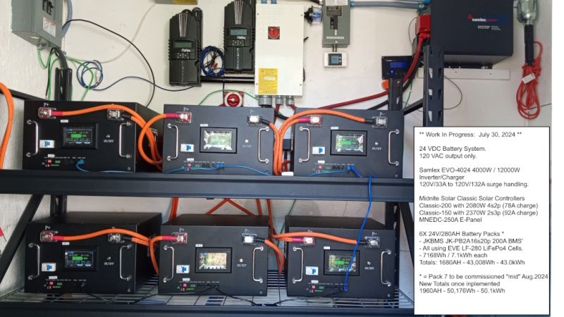

I thought I'd toss a Photo with details in about what I have been finalizing up in my Powerhouse. This is still a Work In Progress as I still have a 7th Pack to be built & commissioned to go in. I still have to setup the 24V->12V converter & 12V Fuse Block, the EtherSwitch and a few small items to go with it all.
Dunno if I need to start a thread here on this. I will of course do a major update with extended details in my DIYSolarForum "About my System" page, which will be a little while before I update that.
Hope it's of interest, feel free to ask questions of course.

# Posted: 30 Jul 2024 09:54pm
So that’s how the pros do it. I had to do some wire repair on mine this morning, no photo.
# Posted: 31 Jul 2024 01:30am
Nice. Work light at the ready on upper right. I have a primary cell headlight with a wide even beam hanging on a hook.
