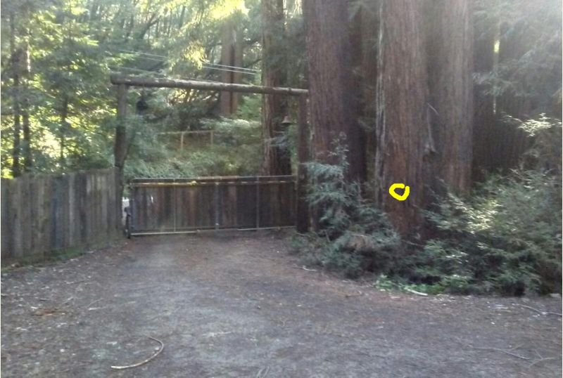

Going to take mine out to the cabin gate today and give it a go. The mounting hole in the bottom is 1/4-20, think I'll screw a lag bolt in a tree with an angle plate and bolt it to that.

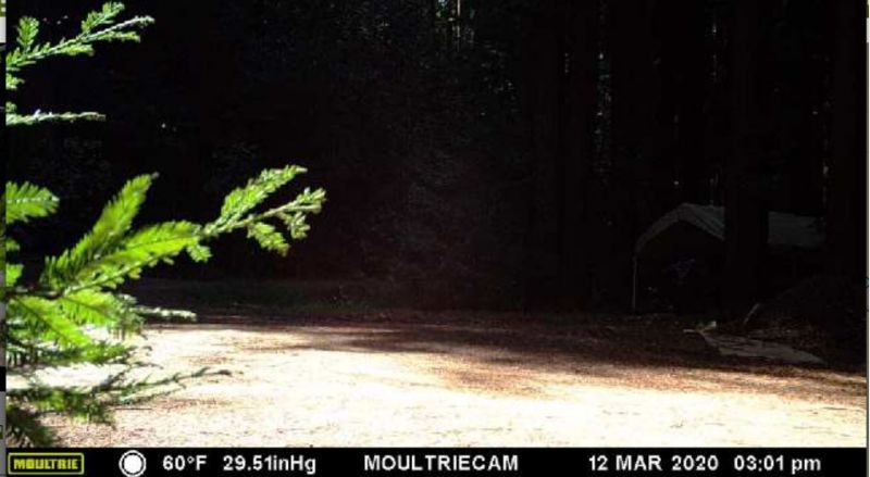

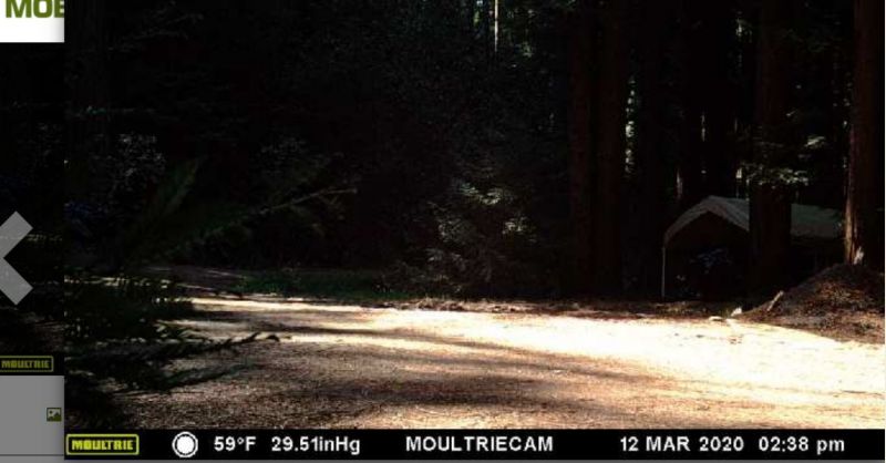

I haven't played with suspending it...yet. Thought I had a pretty good spot for placing it, near my gate, as shown in the photo. I was able to get the license plate of a friend's truck as he drove by. Pointed the other way, towards the gate, it gets the cars passing by on the road.

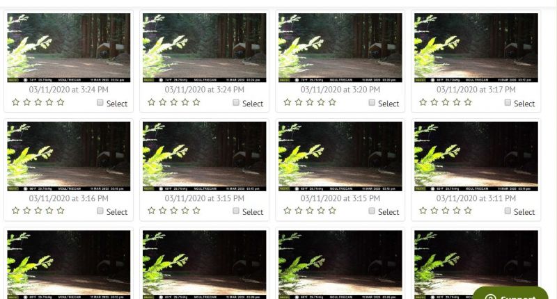

But now everyday around 3pm when the sun hits I get 3-6 empty photos. Might just be that branch (it's in both photos, one in the shade).

I get a lot of pics like that paulz on normal trail cameras. I have tried not facing then into the sun but it will still pickup shadows of tree branches and other things. I'm not sure there's a way around them.

On my Spypoint, I found setting the sensitivity from medium to low will cut out a lot of false positives from brush movement in the wind and shadows from trees and clouds.
It still quite a bit of wildlife, even small things like squirrels from a few yards out. Big stuff - deer, people, cars, works exactly the same.
