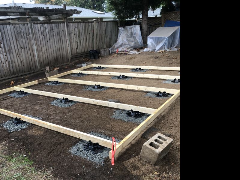

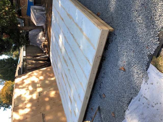

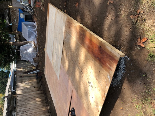

This is the shed I am allowed to rebuild...from the floor up, per the grandfathering rules.
so we got the first part on the foundation built on Tuffblocks... 2x4 on the blocks.
next is 1/2" plywood, then 2x6 joists for floor, insulated R20 fiberglass batts between joists and 5/8 T&G plywood...then the lumber log walls go up.
will put stain/oil over the exposed plywood edge and we will have 2' roof overhangs to help protect it from the "wet coast" of BC.

Ime you do not want to have any (ANY) exposed plywood edges

Grandfathering rules are a gift. 2' overhangs will save that plywood edge. No kerf here, just stain.
# Posted: 5 Oct 2026 12:16pm - Edited by: gcrank1
Ime it will save some but not all. The Only Way to save all is to have NO exposed edges.
Can you incorporate some edge flashing?

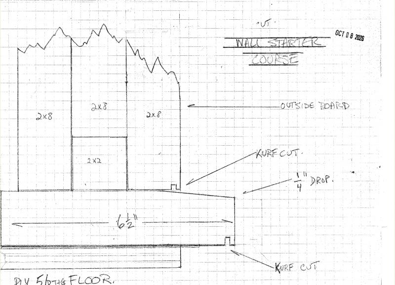

In my booklet I describe building the floor within the first course of logs. This way there no exposed plywood edges exposed to the elements. Problem solved.

Yes Stoney, the book does deal with floor well, however I wanted to insulate the floor w/R20 batts and 2x6 joists on top of my "Tuffblocks" frame w/1/2" ply then joists and 5/8 T&G ply...then do walls [see drawing]...think this solves the water falling off the wood.
