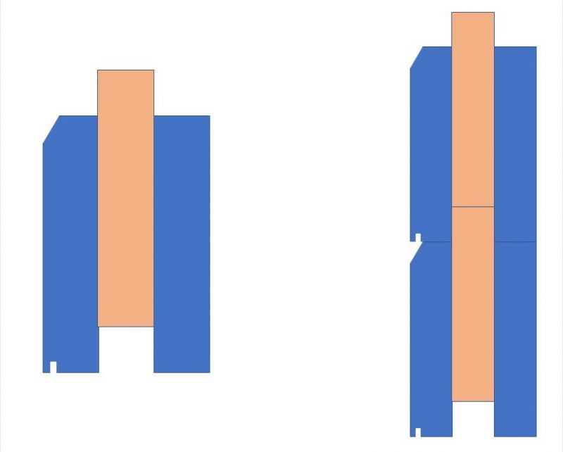

I just found this forum and read through this post. I've been kicking around a similar idea for a couple of years, but this is far superior to what I was thinking about. On the topic of water intrusion, rather than ripping all the boards and trying to make all the angles match up, I would think a pretty simple solution would be to just knock the corner off the top edge of the outer 2 By and cutting a shallow groove in the bottom near the outside edge. The middle and interior 2 Bys would not need to be touched.
Water running down the face of the board will always try to follow the board into the seam due to the surface tension characteristics of water, but water won't run back up hill. The notch at the bottom of the log would cause the water to stop following the surface and drip onto the sloped surface of the log below it and run off.
Of course strong winds could still blow some water into the seam, so it would still need to be sealed, but the vast majority of water intrusion should be stopped in it's tracks . . . shouldn't it?
You would loose a portion of the contact surface between the outer 2 Bys, but I wouldn't think it would be significant to the strength or structural integrity of the system. But then, I'm not an engineer. Just throwing the
idea out there. What do you think?
Of course, the corners would still need to be sealed with calk, glue, silicone or whatever . . .

Zen, This is exactly what I was thinking too. I noticed the same groove procedure is used in the step of an outside door frame. I also think this would reduce water infiltration greatly at the seams.
