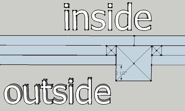

I have a question though. I can't do slab. It is unlikely I could even do a footer, since we can't get a ready-mix truck up to our site. So the logical method is post holes and sonotubes with dimensional 2x framing for the floor deck. But since I will have help for the post digging (into very rocky soil) these guys would be bringing up the 6x6 posts and after visiting the site mentioned they could bring 20' or 24' posts for the same costs (hourly hauling). So I'm considering taking my 6x6 posts up "balloon framing" style up through the "floor decking".
"your wall" would sit on the decking between the posts.
Questions: What are your thoughts about creating a tongue on the sides of the posts -shown with the 1.5 x 1.5 in the attachment on the sides of my 6x6 post, so your middle 2x8 is shorter? What if I want to extend the "inside 2x8" so that it laps the post. This way only "untreated" lumber is in the living area?
As part of "building the shell" I'd either tvvek over the outside 2x8 or put up 2" insulation board on the outside of "your wall" - the insulation will run 'between' the posts. So I'll have some thermal bridging at the posts, but being at 8' o/c and being 7" of wood (1.5" + 5.5") it's not the worst situation.
what say you? would the 'common seam' of the butt-joining of the innermost 2x8 on the post be a problem? 2x2 tounges on the sides of the posts?
Also, anyone try this without nailing the inside 2x8 and doing only clamps, adhesives and 4" nails from the 'outside' direction pointing in? [my wife's not keen on seeing nailheads on the inside]

There shouldn't be any problem with building on posts. However I am concerned with your method of attaching them.
With your idea, most of the weight will be on one side of the post and not directly over the post. My suggestion would be to shorten your posts and set your logs directly on top. This way the weight is centered over the posts and the weight is evenly distributed.
Also your method of attaching to the post seems weak to me. The inner boards would be toe nailed to the post or some sort of joist hangers would be necessary to support the weight. I am not convinced that the 1.5 by 1.5 would support the weight long term.
If you decide to place your logs on top of the posts, you can then build your floor within this first course of logs and attach them with joist hangers.
I also considered nailing the logs together only from the outside. I found out that four inch nails were hard to find and the engineer that approved my drawings said that they had to be nailed on both sides so that is what I built. Four inch screws would also have been expensive.
