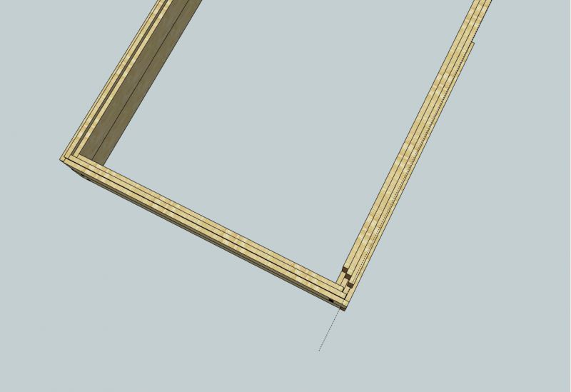

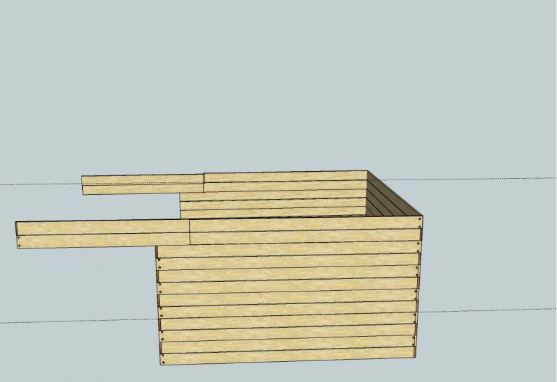

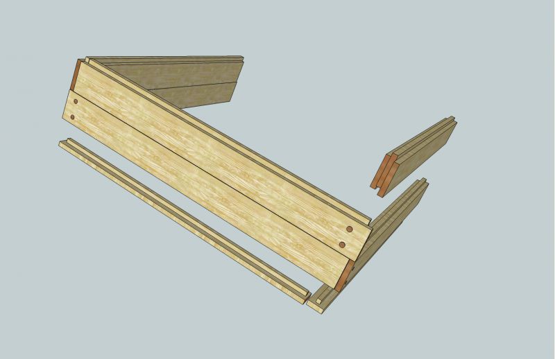

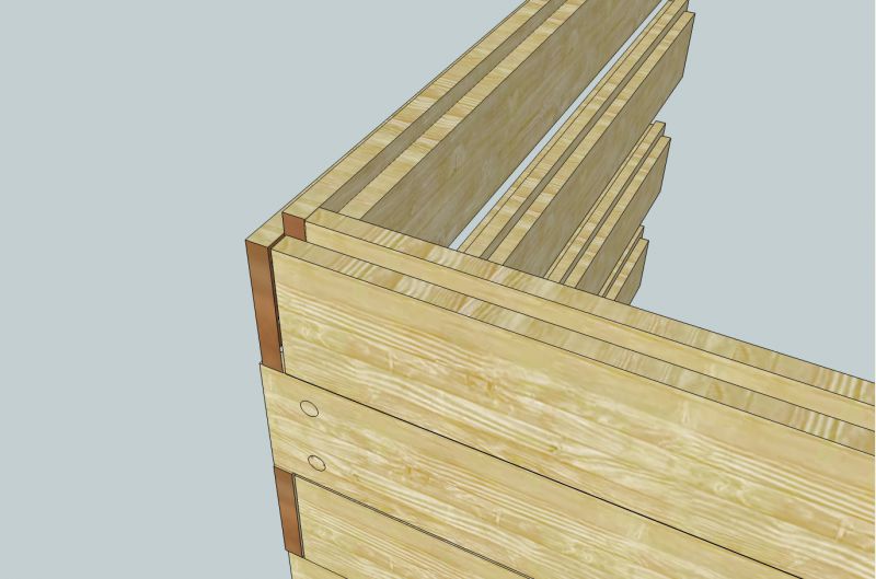

# Posted: 16 Jan 2012 10:30am
Hi Stoney and others,
I've been intrigued by this build option and, like a few others, have done a cost estimate to find that it is surprising how reasonable it is for a 3 season cabin. This is based on the fact that the isolation and thermal mass will be suitable without any other insulation, the outside and inside is complete in one go (less staining) and it looks good! It would certainly take longer than stick building but the fact that it is complete in one go (none of this "I'll do the insulation later" stuff) it is very appealing.
For a couple of reasons that I will explain, I have been considering a modified version and am looking for comments along with some suggestions. Without going into great detail, the cabin will have a 16 x 16 main floor plan with an 8' deck including a loft extended over the deck. The walls will be about 10' giving a 2' extra height (extension) for the loft area (all these measurements are approx as they will be adjusted based on the dimensional lumber size used). As such, the majority of walls will be 16' long except for the extended section. 16' 2x10' dimensional lumber is not much more than something like two 8' pieces but does not offer the extensions used here for looks. With the aim to reduce the number of cuts and complex extensions, I am considering building each gluam board out of 3 16' 2x10s with each of the 3 boards cut to provide an interlocking corner staggered. Outside board would be 15'10 1/2" in length and the next two would be 3" shorter (put together symmetrically with 1.5" in on both ends). Picture is worth a thousand words so I started to do something up in google sketch (still learning it). These are not really to scale - only used to start to get an idea on the cuts.
Each corner would alternate between end grain (well sealed) and a flat side. For both looks and added strength, I was thinking of drilling through and inserting hardwood dowels as shown. Along with nailing the tongues together, this should provide a good solid corner. Using 2x10s would allow for a larger tongue (3 1/2" to match 2x4 lumber).
So here are my questions:
1. Comments on the modified method?
2. What about the crowns on the wood (especially using 16' lumber)? All pointing up/down, alternating or some other trick?
3. Given the longer single boards, would it be wise to add other fasteners in the middle (or more) besides just the glue/nails to prevent any risk of de-lamination? Perhaps carriage bolts and counter sunk bolts on inside? This would obviously increase the build time.
4. Use top plates or just use 2x6 as tongue in top row to provide a flat surface (thinking top plate - why not?
I have other things I'm working out related to the best option for rafters/trusses and how to provide the rafter tie functions when adding a loft. Much of this is a balance between what I can do myself vs how much time it will take me. I'd love to build all the cabin but any time I spend on building is also costing me by being away from work (self employed) so sometimes the cheapest thing to do is pay someone else to do the work. Not to mention, I don't have years to do this - the family wants to move from a tent trailer into a cabin relatively quickly.

Stoney
# Posted: 16 Jan 2012 04:19pm
Razmichael,
I don't really see any serious problem with your modification other than the logs that you are proposing are very heavy. 16 ft logs would would be very hard for two people to handle after you got above the third or fourth course.
For the logs to remain as straight as possible I recommend that all the boards to be laminated with crown upward.
It is pretty easy these days to get labor for the job that you may not want to do yourself. (I covered some of these issues in my booklet.) However I suggest that you get skilled contracters and not just anyone who can swing a hammer.
Best of luck with your cabin.

razmichael
# Posted: 17 Jan 2012 08:41am
Hi Stoney,
I had not considered the weight factor (dah). I was considering 2x10s to reduce the number of rows but the difference is not really much and your point of getting the laminates up to the higher levels is an excellent consideration!
