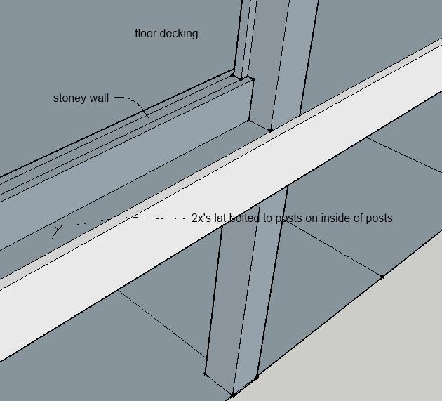

interesting - i wasn't thinking about the weight on the inside side of things since to me the 1st floor deck (built about 4' to 2' off grade) would actually bear the weight of these stoney-walls, which of course is attached to the posts. see attached.
i guess there would be a 'moment' generated on the post below the 2x decking area, trying to "bow them out", but no different than a load bearing 2x4 or 2x6 wall that bears on a beam/stringer that is lab bolted to the outside of a post, which then tries to "bow in the post" below it's attachment point(s).
yes, the half-lapped innermost board would be face nailed into the posts. the 1.5"x1.5" post tongues would be glued and screwed into the posts. the 'wind load' (wind blowing against the wide face of a wall) would, until the stone exterior is done, using later footers, would transfer to the 1.5"x1.5" tongue and face nailing. the posts themselves will have plenty of shear support via the loft floor and interior walls. so the hmmmm is these "infill walls" being strong enough from wind until the stone is built up. I guess I could alternate "butt joints at post" and "not" every other course. I couldn't pre-build the "not" courses though, seems like i'd have to place the 2x8 that spanned on the inside of the post after the fact and glue, nail, clamp in place. but that would make it stronger.

re did attachment for clarity

hakalugi,
I see how you are doing it now. It should work. I agree that alternating the butt joints at the posts would be a good idea.

10-4. obviously:
1) i cannot spell "lag" (bolts), seems i wrote it wrong twice above
2) the middle 2x8 in the Stoney wall is not shown protruding higher than the others, it should be making a horizontal 1.5" tongue, but that obscured the inner 2x8 on this view so i dropped it flush with the inner/outer ones.
