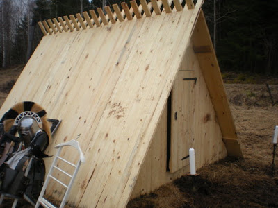

Here is what would be a much cheaper approach to building
a smaller cabin using any size 2X lumber or even a mixture of
sizes. You might need to use a lot of caulk to make it water tight
unless you put shingles or steel roof on top. The way I figure it
approx 14 2x4's equal a 4x8 plywood sheet so it would not be too difficult for the lumber approach to be a lot cheaper than sheathing on one or two sides of a framed wall.

That's a cool looking design, but I'm having a hard time seeing the practicality... for one thing, it looks like the caulking details needed at the top where the two sides intersect would be a nightmare... and the only check for preventing a leaky roof. If the sides were sheathed, I suppose one could completely envelope the top (upside-down triangle) and make it a ridge vent of sorts.
The other thing is that the 2x4s would really need to be a good quality to stay together like that. I would think the typical warping in either direction would be a beast to contend with.
Lastly, cool Spartan helmet!

I 've looked further at that "woven" 2x4 roof and I realized that
there is no need for the sticks up in the air. All those 2x4 ends could be cut off flush with each other and still keep the alignment
function of the boards. Then it would be super simple to run
a piece of bent flashing from one end to the other over the ridge
to make that part of the roof watertight. Further you could put as
many horizontal "bracing pieces on the back side to keep it all
square and straight.
Jabberwocky
# Posted: 26 Jun 2017 01:30pm
True.
With the armor in the pic it looks like this was designed to be a modern mimic of a more ancient building type. It looks a little reminiscent of a Viking long house, but the Grecian Hoplite helmet wouldn't suggest that.

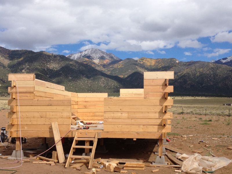

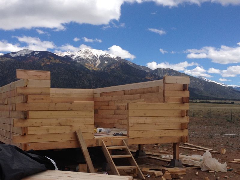

I'm building a cabin with this method so I can add my experiences. I like the method. I've built the entire thing solo and not sure if I could have done that stick built. It looks good. Everyone asks what kit it is. Make certain you get quality lumber. I live in the middle of nowhere and only had one choice to deliver. The quality was horrible so I have some big gaps. The best, cheapest, and fastest way to fill them was using canned gap foam. Painted a layer of tire bond over it and think it will last a while.

# Posted: 2 Jul 2017 09:35am
Rickkrus
It would be interesting to see some close-up pics of the issues you had.
How did you build the logs? Type of glue, screws, a jig, etc.
Are those 2x8 or 2x10
Foundation spacing for the loads since you are on piers and not a poured slab.
Beautiful location.
