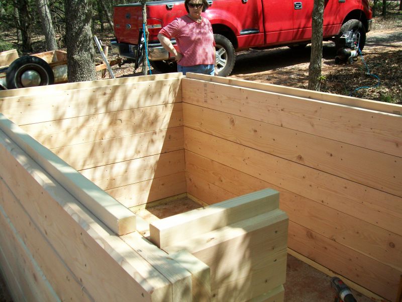

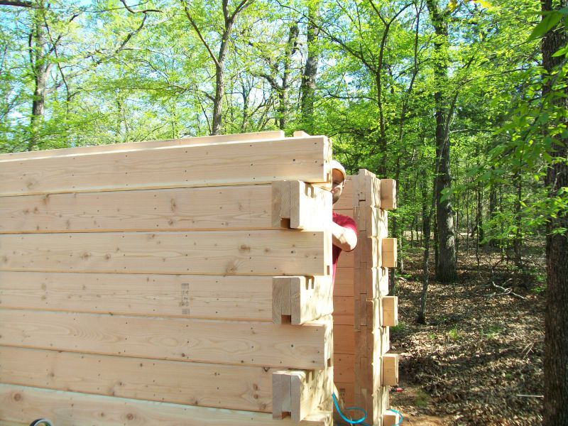

My son and I are planning on using Stoney's method to build a cabin. We ordered Stoney's book and we were very pleased with the detailed information. We built a small (6X8) wellhouse to get a feel for what was involved in lumber log construction. Could have built a less expensive wellhouse but wanted it to match the look of our cabin. Still need to finish the ends and a few other details but are well pleased with the results. I'm attaching a few pictures of the wellhouse.

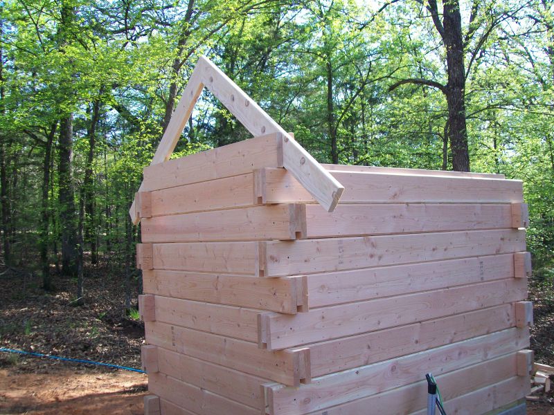

Grunau

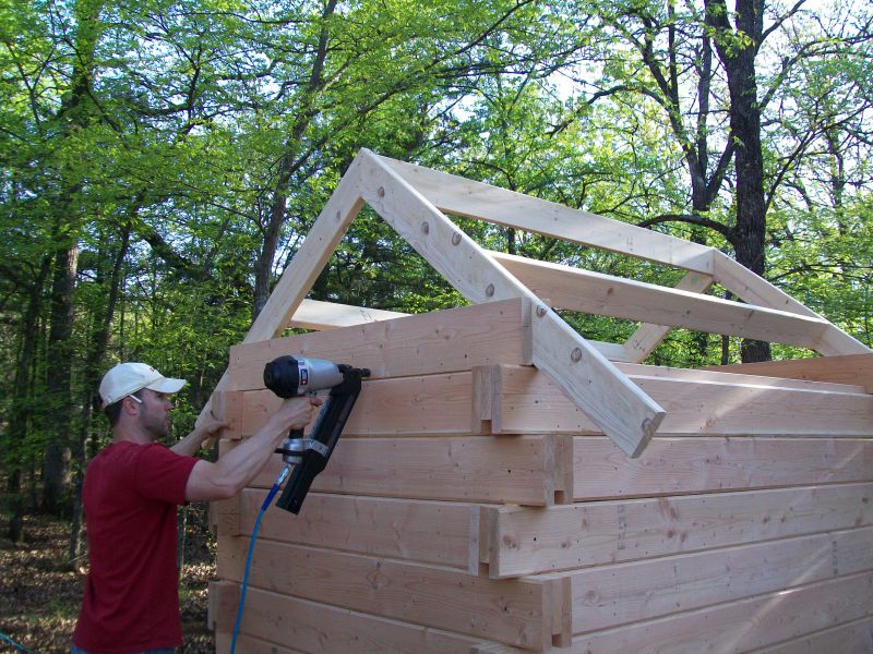

# Posted: 4 Sep 2013 08:27am
Rick004
We made the rafters like the logs only we used 2X6's in the middle. Then we nailed 2X8's on the outside so it looked the same as the logs. The rafter fit over the middle board on the log just like another row of logs would have. Not sure how we will do it on our cabin. I attached a couple of pictures of the rafter.

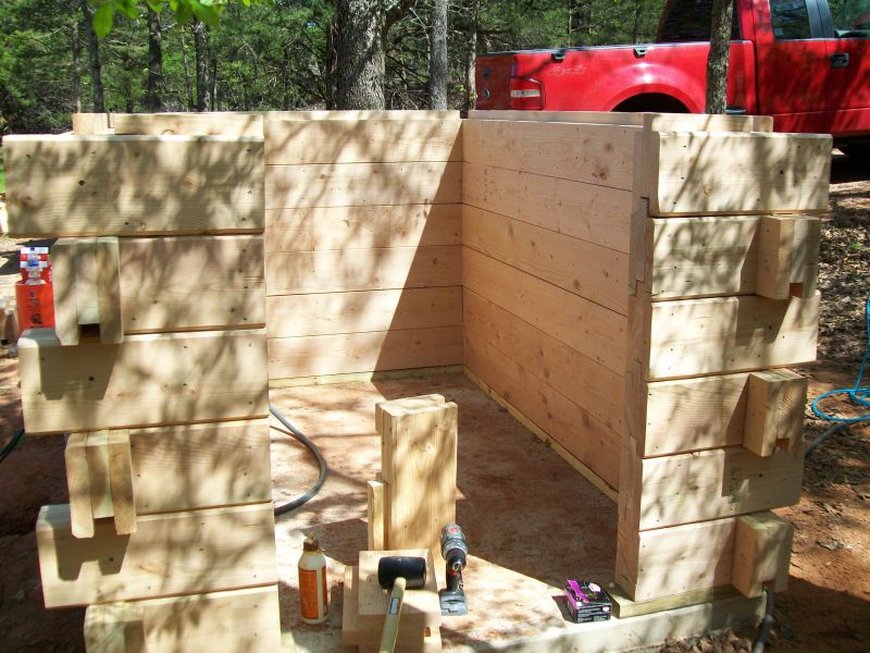

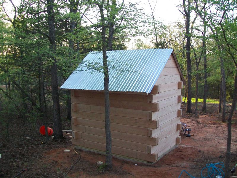

Grunau - awesome job on the well house, looks great! I have a question because I can't tell from your pics - part of Stoney's genius design is that each log interlocks with the opposing perpendicular log, with an added piece at the ends that holds the opposing log in place. I couldn't see this feature in your pics of the well house. Not important for the well house but would be for your cabin build. It looks like you just butted the logs to each other rather than interlocking them but I cant quite tell. Did you do something else to interlock them? Thanks.
Grunau
# Posted: 16 Dec 2013 08:43pm
mapdude - each log is interlocked with the opposing perpendicular log. We followed Stoney's manual on how the logs interlock. The only thing we did was shortened how log the log went past the wall so it was proportionate to the building size. Thanks for the complement on the well house. I attached a picture but not sure it shows what you want. Also a picture with the roof and snow on it. Thanks
mapdude
# Posted: 16 Dec 2013 08:56pm
Grunau
I see it now, pics did the trick, thank you. Looks really great with the stain and snow. I hope to build a cabin with this method in the spring. Thanks again

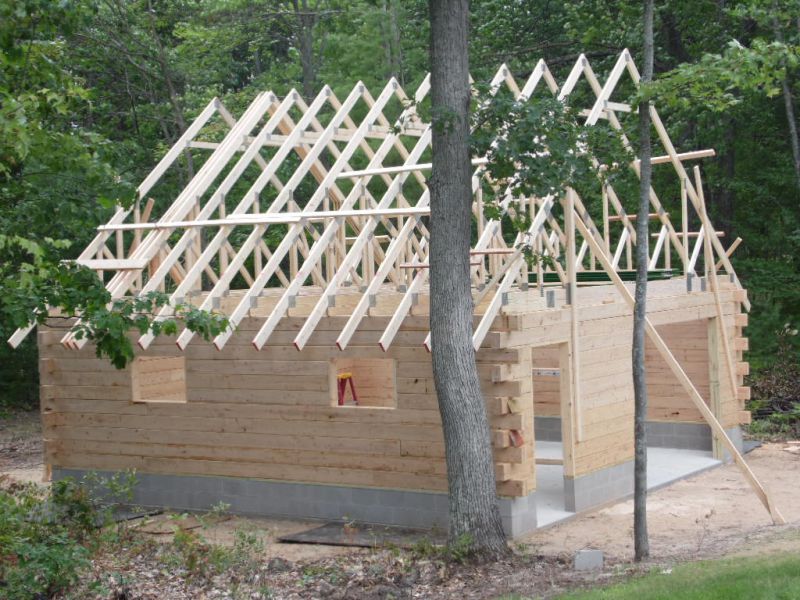

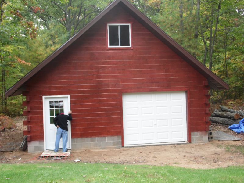

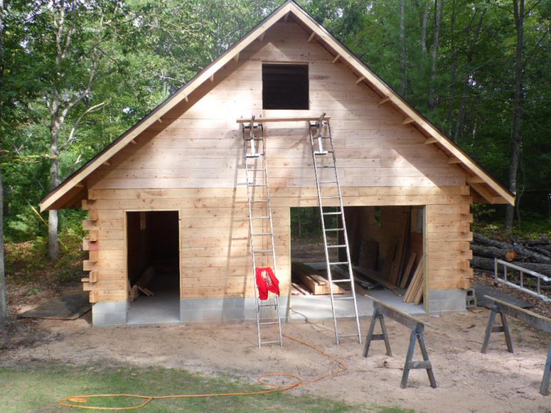

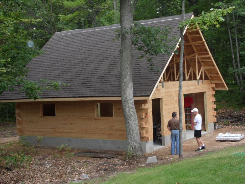

# Posted: 13 Feb 2014 10:55am
Hello everyone. Here are some photo's of the garage that I completed last fall. I've had several people ask for these so I finally got them posted.
Anyone else that has photo's please post them. There is a lot of interest.
Thanks
Nirky
# Posted: 14 Feb 2014 12:06am
Good call on the cinder blocks. At first when I saw the thumbnails I thought "oh he took off the truss roof?" lol but that's a different garage! Living quarters above? Still using 2x8's? I'd be interested in your total materials cost on this project.
