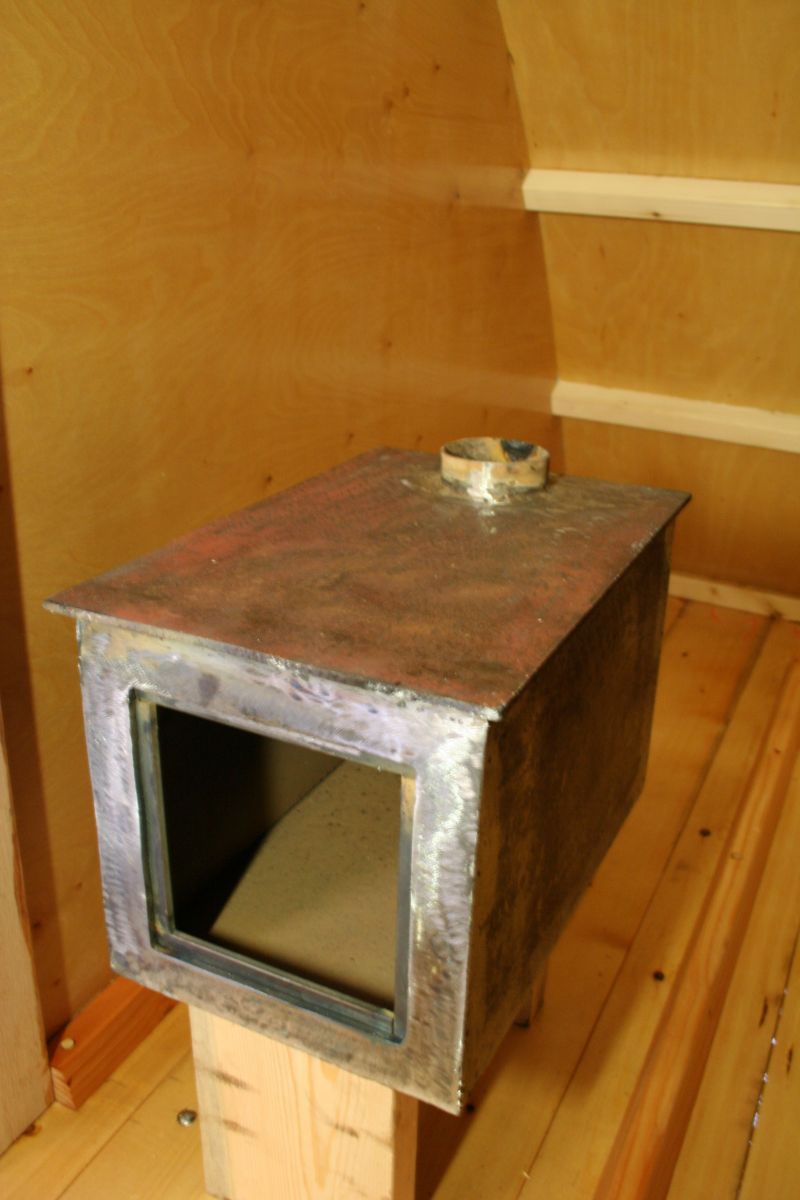

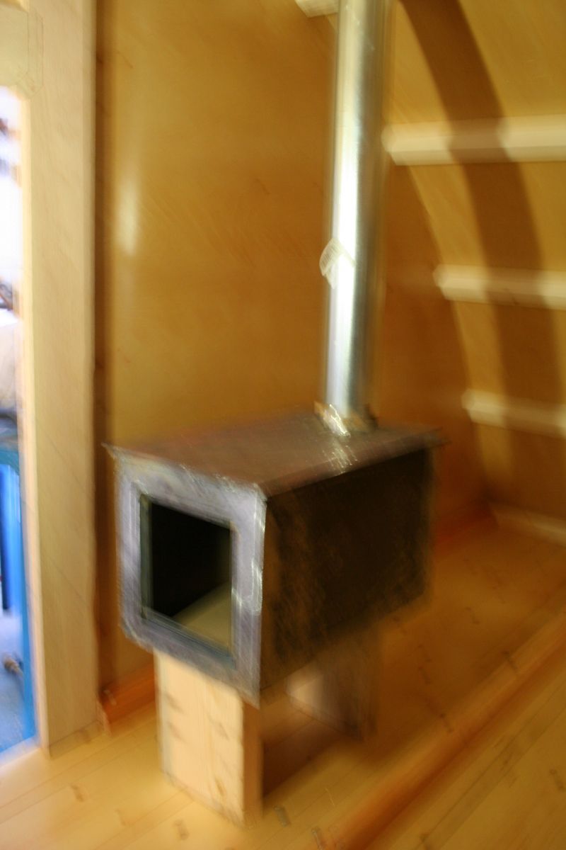

I just made this one for a small trailer I am building. The stove measures 9"x9"x14". It has a 3"flue. Not shown are the air disk and the spring handle for the door. It is fully installed in the trailer now but I don't have a picture of it. I also fabricated a double wall roof jack using 3 and 4 inch exaust pipe I obtained from a muffler shop. The stove is made of 1/4 plate and on the wall side I have a 1/4" heat shield mounted 1 1/4" off the stove as well as the 1/8" stainless heatshiled on the wall.
Jocko

I have some three inch double wall stove pipe but have been told three inch is not enough for proper draw if the fire is two large. How is yours working ?
lawnjocky
# Posted: 1 Jan 2010 08:14am
It works geat. This stove is about the size of an ice fishing shack stove and they commonly had 3" flues. 3" double wall for gas fired appliances is common but the stuff for wood stoves is harder to find. The flashing I made had the curve of he trailer roof and was rigid so as to support the flue while the trailer is in motion. It extends about 8" into the interior. The flue pipe is single wall.

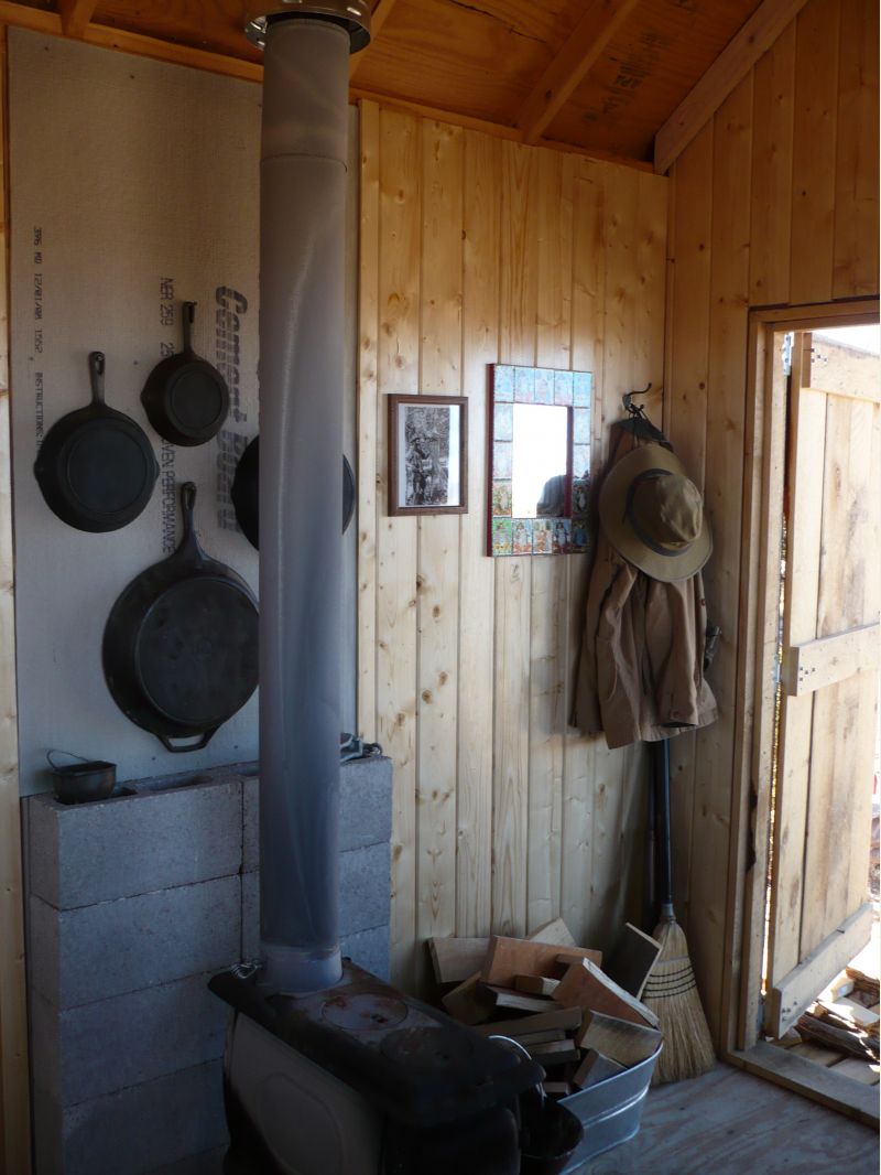

Here is my stove set up. Under the stove I have 12 x 12 pavers on sleepers. Behind the stove I have wonder board going all the way up the wall. Right behind the stove are cinderblocks held in place by thinset. The blocks and pavers are set up so there is air flow from the front of the paver to the top of the blocks. This system works great. Eventually I will tile it with some Mexican tiles.
Jocko
dk1393
# Posted: 27 Jan 2010 08:19pm
That is a great spot to put the cast iron pans. I think I will borrow your idea

# Posted: 27 Jan 2010 11:21pm
Interesting solution with air flowing through the hollow cinder blocks!
lawnjocky
# Posted: 28 Jan 2010 05:03pm
Thanks. The cinder block and paver idea was cheap, fast and it works great.

Sphinx
# Posted: 21 May 2010 12:19am
Nice, Jocko! I can't see the bottom of the cinder block stack...do you have it sitting on the pavers or up off the floor to get an air gap?
