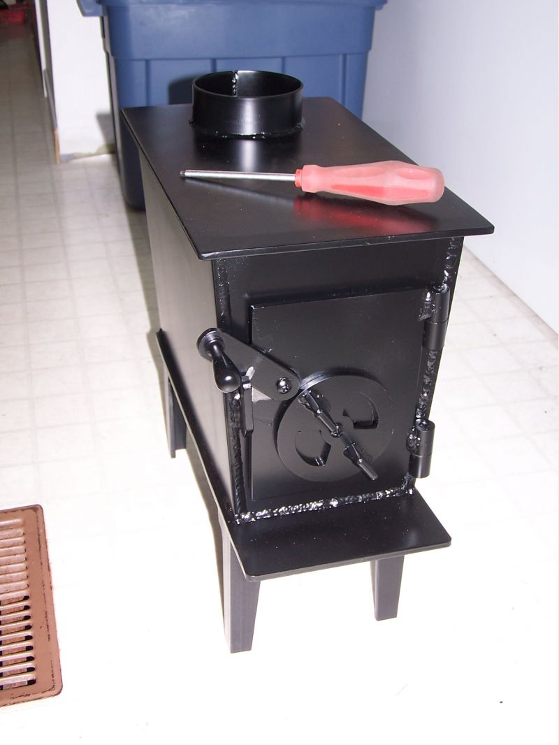

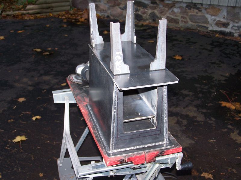

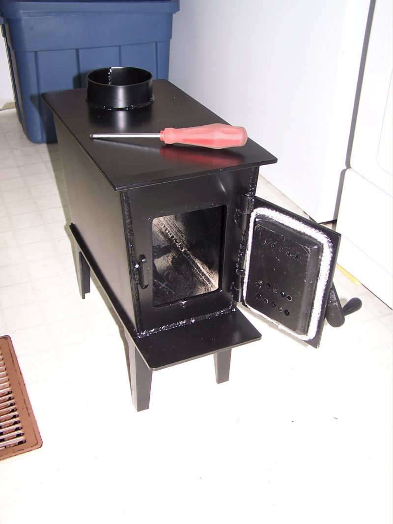

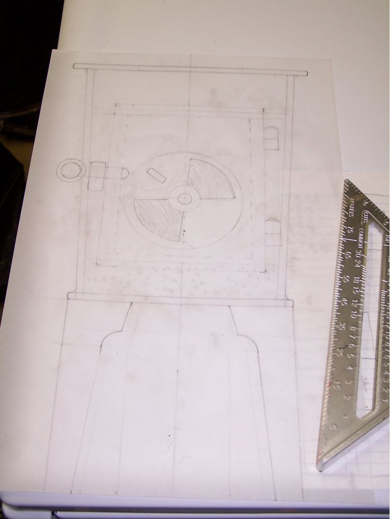

Hi, I built a small (100 sqft) cabin and had similar problems as other posters looking for a wood heating solution. Eventually, I just built my own small stove. Mainly out of 1/4 inch plate, with a four inch stack and conventional chimney I found on kijiji for $40. It burns cleanly at proper operating temps and uses little wood. Left alone it will burn down in about 3 hrs. I don't damp it down, have a window cracked at all times and have functioning CO/smoke detector. It is doable to go the DIY route provided you respect clearances and stick to code

Well done!, even a top baffel plate. I am wondering where is the water heating coil? the slide out ashbox?

Thanks, I didn't incorporate a heating coil or water jacket because I think that for occasional use a pot of water on top is more practical, both from a cleaning and a safety stand point. As a steamfitter I can assure you that the last thing you want in a tiny space is a failed pressure releif valve. Also, complete emptying is needed when you leave do to freeze up and corrosion. I did consider an ash drawer, but wood burns best on a flat insulated surface (fire brick) rather than on a grate (better for a multifuel stove). The stove only accumulates about a half inch of ash a week which only takes a minute to shovel out. The only things I might consider if I built a second one would be an oven on top and preheated secondary air to the combustion chamber (I get a clean burn but efficiency might be improved).

Thanks, Tom I didn't add a window for a few reasons: cost for the tempered glass, the opening is pretty small (4x6 inches), but mainly because I found when running a small radiant propane heater in the cabin early on that in such a small space it seemed very bright once my eyes adjusted to the dark (it kept me up). Also I built a preheat baffle into the door that heats the incoming air (maybe) and adds turbulence, so no room left in a tiny door for a window.

OK yes I see your baffle.

Hi Tom, I agree that being able watch the fire is nice (and handy for feeding purposes). If I'd found some cheap glass at the time I'm sure I would have added a window (it would only be about 3x3 inches though!). I think of this stove a more of a utilitarian heater/cooker and in such a tiny space there's really no room to gather around it and enjoy a fire. I figured that since I sit out by a camp fire most nights in the evening I would get my fire watching that way. I did make a steel screen that clips in with the door open for a fireplace effect but haven't had much desire to use it
