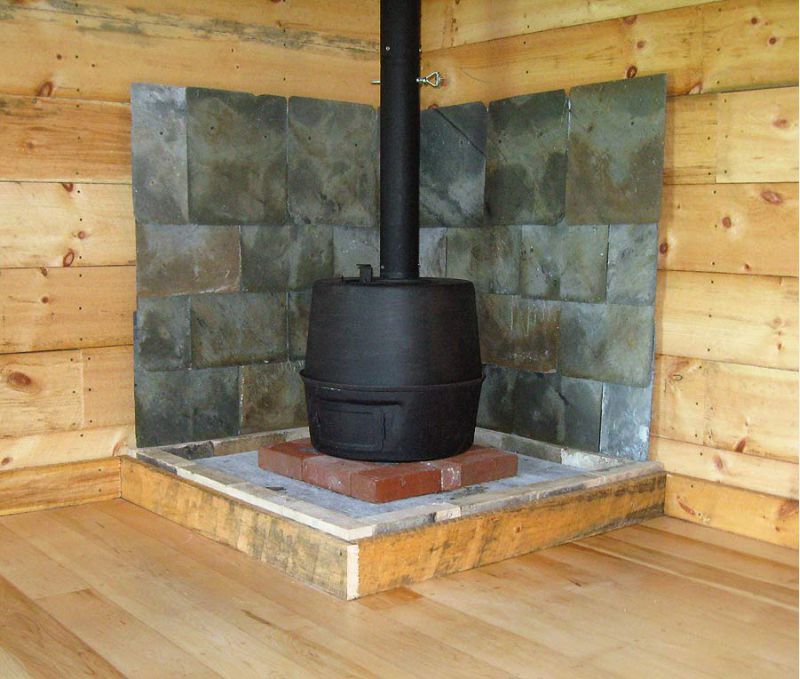

I purchased some 22 gauge steel sheets, i plan to space them off the wall 1-2" with air gap on the bottom/top.The stove will be in the corner of two walls. With the stove around 14 inches off the The wall... This is a tiny potbelly stove..The walls are tongue&Groove boards behind the steel. Do you think this will be enough protection from the wood walls?
I also planned for 1-2 layers of cement board with a piece of steel over that, and then a couple patio blocks for temporary. Until i can build my hearth with stone collected from my property next summer. Can i lay all of those things right on the floor, or will i have to build it up a few inches and allow for air to travel from the front to the back, meeting the air space with the sheet metal/wall set up?

sounds good to me , i think the most important part is the well ventilated air space between the walls and floor and the fire proof shields . [ie. the steel and cement board ] be safe !!!

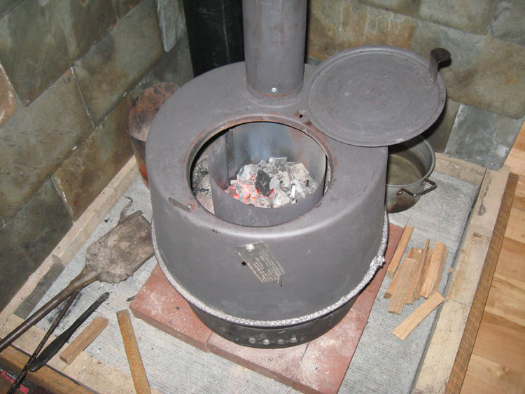

Turbogeno
# Posted: 20 Nov 2014 08:41pm
NhLiving , that sounds like a safe setup. Mine is not as protected and has had no issues with hot fires.
I recently tried something different with my stove as it's way to powerful for my 220 sq. ft. cabin. With wood if I don't monitor it every little while it's either to hot or to cold. It'll burn out in 2 hrs. It was about 22°f the other night. Around 1800 I put a 6" piece of stove pipe in the middle of it and lit some nut coal in it. After an hour I closed off most of the air and put some more coal in. I had to fill it up once around 0230 and shake the ashes but it kept the place comfortable all night. A little more testing and I'm thinking this is the way to go for overnight heat and comfort.

# Posted: 20 Nov 2014 09:06pm
Turbogeno, i dig your set up in the corner like that. Is the cement board under the patio blocks suspended off the floor? If so, what did you use?
I am also worried about overnight burns in such a small stove. I don't mind waking up once in the middle of the night to load it up. I hope that will be enough to keep it going.
Turbogeno
# Posted: 21 Nov 2014 06:07am
The cement board under the stove is on bricks and there is another layer of cement board behind the slate with an air space behind it.
NhLiving
# Posted: 21 Nov 2014 02:03pm
Oh alright, i might use bricks or just 2x4s on their sides. I think with a layer of sheet metal, then 1 or 2 layers of cement board ill be fine. I'm concerned about weight so who knows.

Turbogeno
# Posted: 21 Nov 2014 02:25pm
Quoting: NhLiving
If you stove is on legs that should be OK unless the bottom falls out I wouldn't make it any thinner than the store bought protectors. You can't take any chances with a stove. Without legs I went with some extra non flammable material.
NhLiving
# Posted: 21 Nov 2014 02:35pm
ahah good call, let's hope the bottom doesn't fall out. The bottom of the stove appears to be structurally sound and is 8 inches off the ground. So i feel i should be safe enough. 'd rather do overkill than worry about my place burning down!
