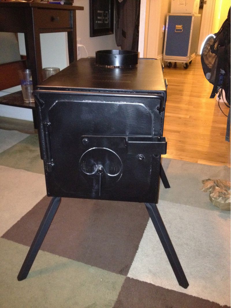

Hi guys,
Great discussion, as usual. We just bought this little guy for our 10x12 little cabin in VT (see picture below).
http://www.small-cabin.com/forum/6_1121_0.html#msg14028
We plan to install it next weekend and just bought the kit and all the necessary pieces today. Our question is: How long do you think this will take us to install, start to finish? From putting down the cement blocks and putting up the cement board to being able to actually burn a fire in the stove? Neither my brother or I have ever installed a wood stove, though both know a little bit more than the average Joe. Just a ballpark idea would be helpful.
Are we talking 3-4 hours of working together straight or are we talking about a day and a half of working straight together?
Thanks for the thoughts everyone and I hope this question doesn't hijack the thread too much.

Quoting: sabiggs
Hard to say for sure. My last stove install was moving my shop stove from my old shop to the new one. All the pipe was all ready cut and drilled I just had to cut a hole in the roof and reassemble. Total time working solo about 2 or 3 hours.
I did one for a friend starting from scratch and being very careful cutting through old plaster and other slow downs. I think I had about 9 or 10 hours into that. Again working solo for the most part.
