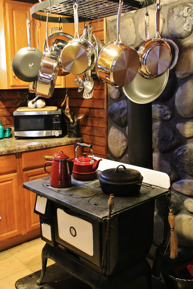

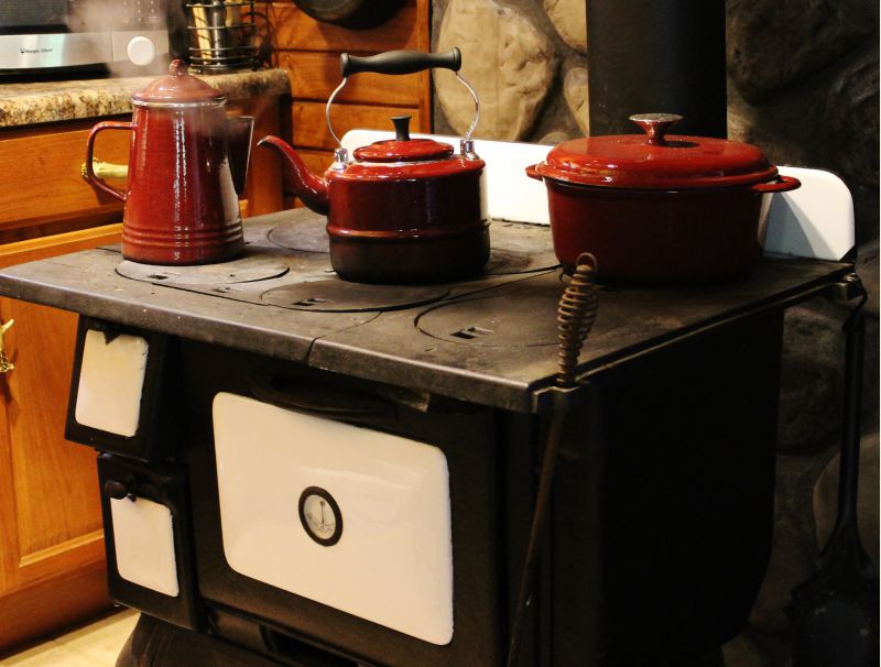

# Posted: 25 Apr 2012 09:47pm

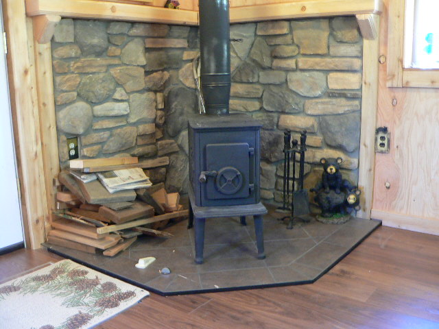

I found my little wood cook stove on Craigs list for $200. I purchased all my double wall stove pipe from Menard's using stainless steel through the wall and along the outside wall. I highly recommend shopping around for a used stove but not cutting corners on the piping. stove
|  chimney
|  stove hooked up

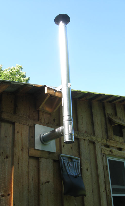

Thought I would share our set-up for our cabin in Northern MN. It is only 420 sq ft, so this little boxwood stove heats it right up and keeps it warm. The stove is probably 40+ years old. I pulled it out of my aunt and uncles old storage shed where it had sat for at least 25 years. It is nice thick cast iron. I disassembled it, sand blasted everything clean and then reapplied the stove black, sealed and reassembled it.
I also cut four windows in the door with my die-grinder and cut-off wheel, built a frame to hold a couple of pieces of pyrex fire glass.
I put a piece of copper roofing on the floor to protect against stray embers. The stove pipe is a straight shot up and through the ridge of the roof. Most of the pipe is just single wall black 6" stove pipe. The part that passes through the roof is double wall insulated stainless steel pipe.
I built the heavy gage plate that is screwed to the rafter box framing and supports the weight of the insulated pipe section.
I also built a copper chimney cap with flashing and screen for the outside . It just slips over the stainless steel insulated pipe.
Here is a little better shot showing the details and construction of the chimney cap.
And finally a shot of it burning. The glass windows really make it nice since we can see the fire. You can also the custom copper heat shield that I made to reflect some of the heat and protect the window and trim from getting to hot.
It is not the most efficient stove in the world, but it keeps us plenty warm and we have plenty of firewood on our property. It will do an even better job once we have the cabin fully sealed up and some storm windows made.

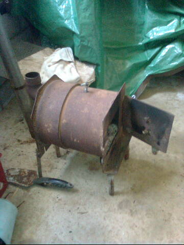

Quoting: PDK73 I just built my own small stove. Mainly out of 1/4 inch plate, with a four inch stack PDK73 any chance you can post some pecs and what you may change about your stove? This look like what I am looking to build except with and air tight door and a second combustion at the top below the top plate . Thanks, John

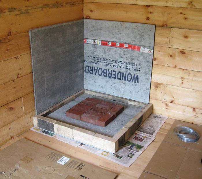

# Posted: 5 Jun 2014 08:58pm - Edited by: KinAlberta
Space shuttle tiles!!!
I wish I could just buy space shuttle tiles and stick them right on the wall and put the stove right against them with zero clearance!
Some random comments/thoughts on attaining as near zero clearance as possible to a wood interior wall (clad both sides with very dry, very old knotty pine boards):
I'm looking into all this because our cabin has old unrated stoves in it. I believe the code says 48" from wall and half or 2/3rd less if a heat shield is used. Even that seems excessive for our old wood cooker/oven so I'm thinking I could somehow make a double or triple or more layer heat shield with wall protection to safely bring the distance down to about 6" - 8" from the stud wall (once the knotty pine boards on the stove side are removed).
One thing I've read is that the backer board, cement board will heat up and simply transfer the heat through to the wall so it too should be spaced out from the wall. Also any spacers must be around the perimeter and not close to the heat source and not go though any more than two attached layers together or they defeat the purpose of multiple layers - they need to be staggered. This makes sense. You don't want the heat to simply go along a connecting bolt and into a wood stud.
So moving from the wall towards the stove:
Maybe aluminum wrap inside the cavity and covering the studs or galvanized tin cladding spaced out 1/4" lining the stud cavity and protecting the studs. (Maybe heat proof paint on the studs and inside the cavity.)
Maybe rock wool in front any cavity lining. But, but, but... that could trap heat so maybe the 4" deep wall cavities are best left empty for improved air circulation. Need openings of a couple inches top and bottom for convection air to enter and leave.
Maybe two layers of cement board with only an 1" spacing between them but then several more tight 1" spacing layers of metal shielding going outwards towards the stove.
Maybe a layer or two of extruded steel mesh to allow further dissipation of heat then add the solid metal layers just before the stove.
Layers closest to the stove: I've learned that copper and aluminum convect heat away the best so a layer closest to the stove could be made of one of those, then maybe a steel layer further from the firebox.
So in the end from stove towards wall: Laer of Aluminum sheet 1" space Layers of extruded steel tight together (2 sheets) 1" space Layer of steel sheet 1" space Layer of steel sheet 1" space Cement backer board 1" space Layer of cement baker board again 1/4" space Layer of tin on studs 4" space in cavity
Since moving air is all important I would lift the stove a couple inches to allow air to be drawn in under the front and then flow up the sides and back. Maybe use square aluminum tubing (aluminum fence pickets or something) as a spacer under the stove's platform layer. Could also drill a couple holes in the base of the opposing bedroom wall as an air source from the very back of the stove.
Any thoughts?
Also, this is a good and interesting how to video:
Obadiah's: Installing A Cookstove Safely In Tight Quarters https://www.youtube.com/watch?v=2DBUdaPmN4Q

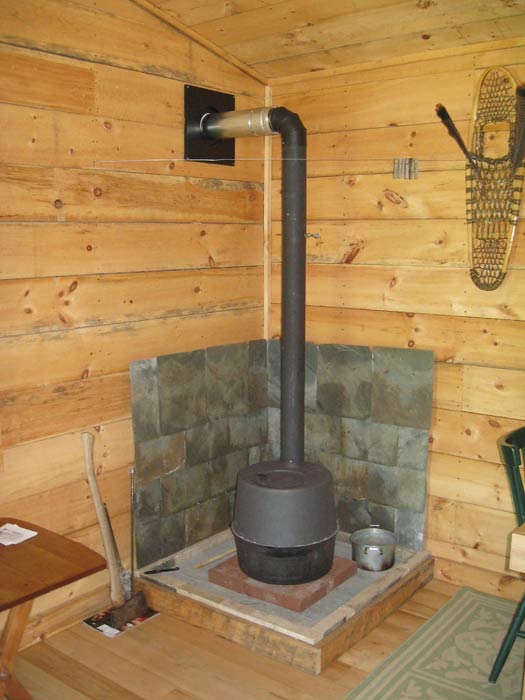

OK, looks like I haven't posted my wood-stove set up in this thread.
# Posted: 18 Jul 2014 08:51pm
Very nice

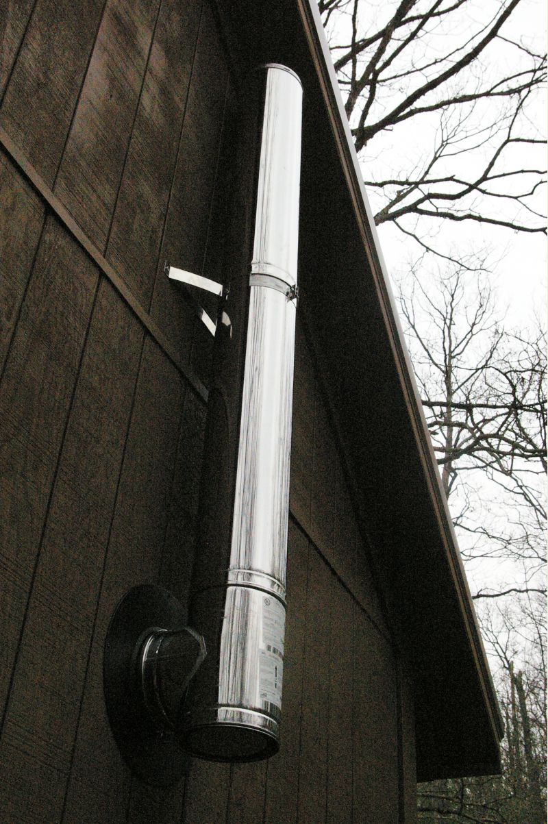

Here's my take on a wood stove install. Well, one where there's no official inspection or permits required. The stove is a military surplus tent heater, the cement board is spaced 5/8" off the wall and covered with roof slate.The thimble and 4" double wall pipe are from Duravent. I insulated the thimble with 2, 1.5" layers of ceramic wool. My 1st attempt used single wall pipe throughout with an insulated through wall connection. The outdoor section cooled off so fast I had poor draft while I was getting everything hot and there was lots of condensation in the outdoor section. Unacceptable and potentially dangerous. I haven't tried the new setup in the winter yet but I'm confident it will perform better.
