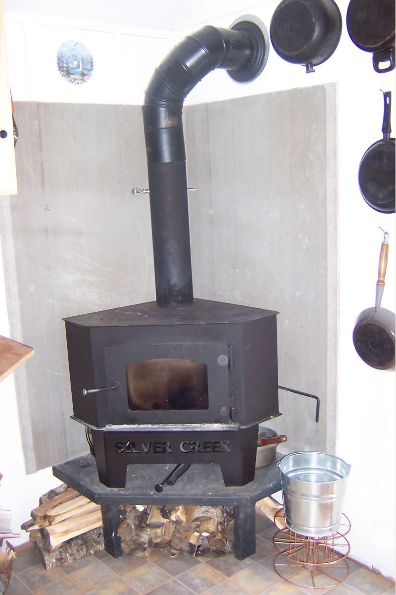

# Posted: 16 Aug 2011 01:25pm
Here is our woodstove. The cabin is 12x16 and a small fire is all that is needed. Our son built a woodstove for his ice shack and we said "perfect...build us one please." It is not code but we didn't care cause our cabin is suppose to just be an accessory building-otherwise we could not build a cabin that small where we are. We keep a fire extinguisher in the cabin.
Homemade woodstove
Homemade woodstove

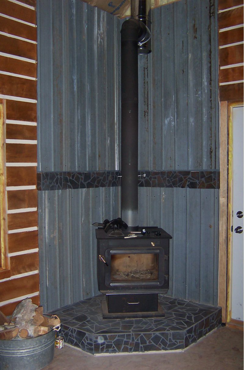

Hi I'm trying to find a solution to reduce wall clearances, without adding a lot of weight (ie/ brick), as my cabin is on a trailer frame and needs to stay fairly lightweight. I was thinking that because using insulated stove pipe can bring my pipe clearances from 18" to more like 2", that maybe I could find/make a similarly insulated heat shield to reduce wall clearances. Could something like this reduce clearances more than two layers of metal with air gap, or is the air gap an essential part of how that system works? Thoughts/ ideas?
# Posted: 26 Sep 2011 02:24pm - Edited by: trollbridge
In our "big" cabin we put up sheetrock first. Then steel studs with that cement board over it to create an airspace. We left that up off the ground a little too. Over that we put galvanized tin also leaving that up a bit from the bottom. We also needed to stay as lightweight as possible otherwise I would have done stone top to bottom.
All clearances for our stove were met doing this.
Here is our wood stove.
