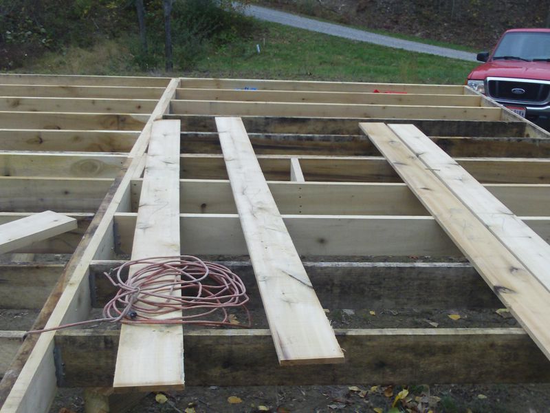

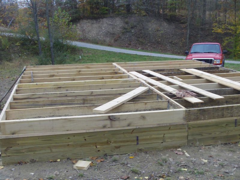

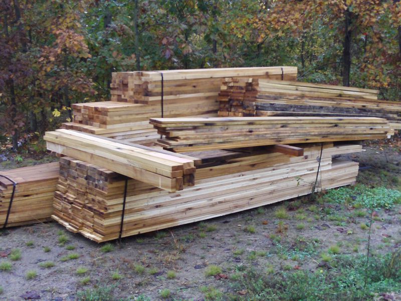

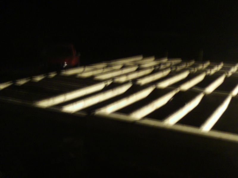

Your wish is my command! My rough sawn lumber finely arrived!
|  Floor joins almost all in place.
|  More floor joists

Jr, The foundation is 6X6 posts. I drilled a 12" hole down 4' and poured a cement pad in the bottom. After that set, I placed the posts and poured dry cement around them and back filled. Here is a drawing of what the house will look like, and a picture of one that is simular, but our ridge line will run the opposite direction from the one in the picture.

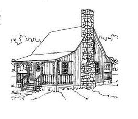

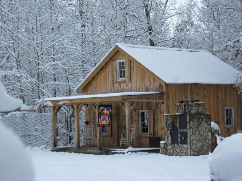

Oooops....here are the pics! what ours will look like
|  sided like this one....

How many posts down each side? The middle? It's hard to tell from those pictures. What kind of wood?
Tim
# Posted: 18 Oct 2011 10:47am
Reply Quote
3 on each side and 1 in the middle. I will also be crossbracing the middle 1 to the center 1 on the outside.

3 posts per side on a 20 foot length? I was thinking there would be more?

Here we go again! These posts are each sitting on a concrete pad. The 10' span is the equivilent of a tripple 2X8 beam. If a 6"X8" hardwood beam can't pan 10' there are far more problems than that!

Quoting: Tim The 10' span is the equivilent of a tripple 2X8 beam.
Does that mean three layers of a 2x8 nailed together in a vertical sandwich so it's 6 inches on the topside? Sounds sturdy but how do you calculate that? What kind of hardwood?

If it is oak of sum kind and nbr 2 grad a 6x8 fails my calculations for bending, deflectiun and shear. Looking at the pictur "Floor joins almost all in place." I don't see how you arrive at it having a 6x8.

Quoting: curious almost all in place Ok, just what part of this do you need me to punch into your computer program so you can puke out numbers that make you happy? And...why don't you sign in so we know who you are and we can see the incredible castle you are in the process of building?

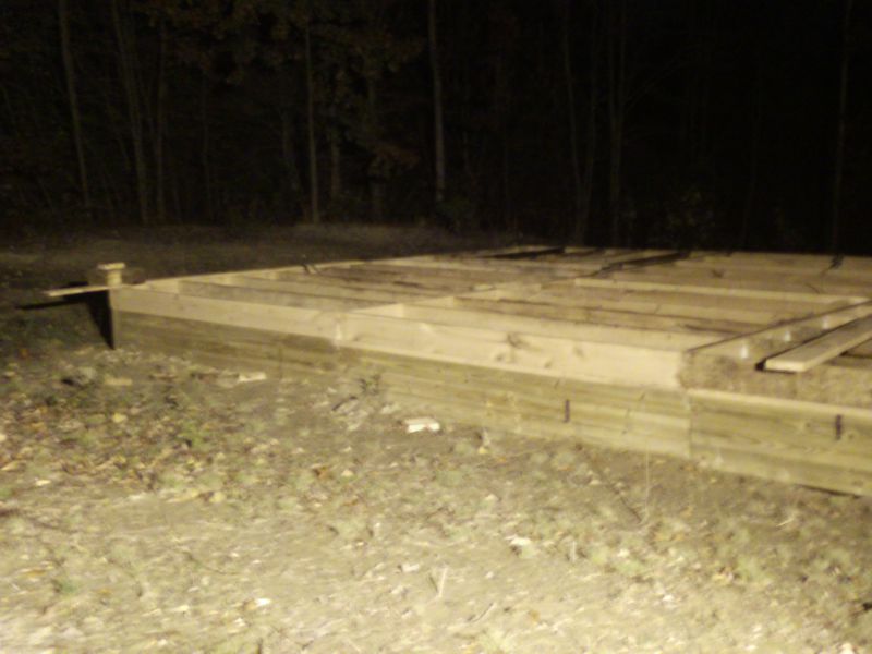

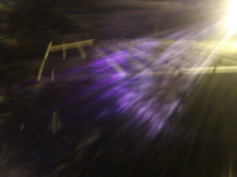

I worked until about 8:00 last night. Yeasterday afternoon, the neighbor was kind enough to drop by with the offer of a loan. He had with him a huge light, set up to be run on a generator, with a power cord coming off of it to run a saw. Awesome! The dark can't stop me now! lol
