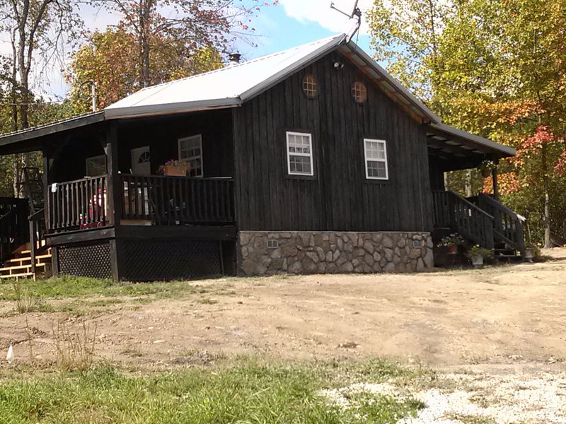

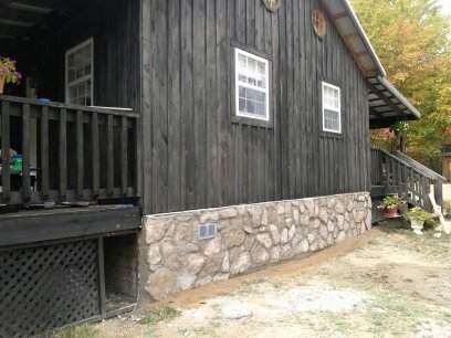

The stain on the house is done, as is the stone on the foundation. Here are some pics or our projects so far.

Oh boy does your place look GREAT or what???? I love how the stone foundation anchors it all. It really looks super-as does your stain!

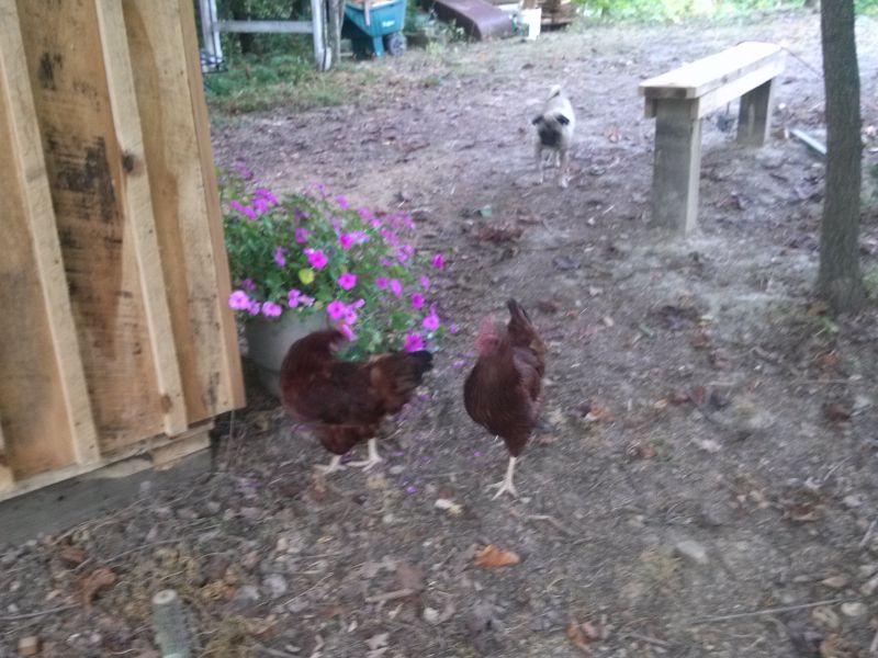

Chickens look happy...dog looks like it wants to make friends! "Aw...come on guys (actually gals, right?)...don't walk away...play with me..."

Looking better and better Tim.. Is that rock skirt mortared from the ground up with just really big stones or did you put a plywood wall behind if first ?? Interested because I would like to do that someday.

There are several youtube videos telling how to do it. I put 1/4" cement board up first instead of plywood. Then covered that with metal lathe. (the same type used for stucko). Then apply a "plaster coat" of mortar and scratch it with a leaf rake. Then the stone is mortared to the "scratch coat".
It goes on pretty easily.

I looked at your website. Now I am more clear on what you were asking. My house sits on 6X6 wooden posts. On the posts, I have 2X6 boards as a skirt around the outside. It was over the 2X6's that I applied the cement board. You will need to create some type of skirt before applying stone.

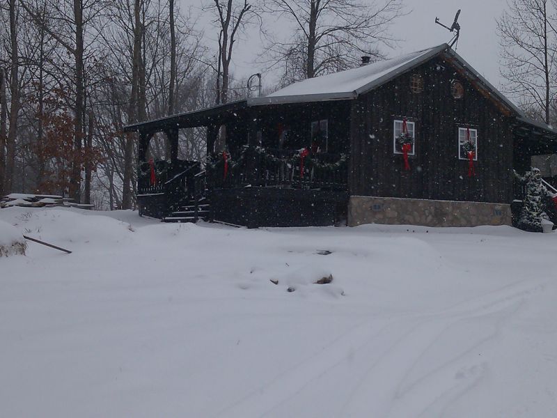

This morning, Dec. 26th, we got a little snow. Here are some pics......

Love the blanket of white Tim!
