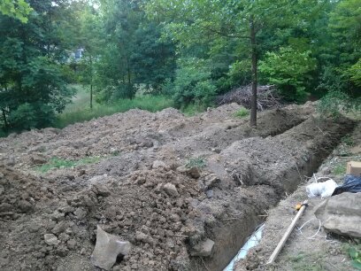

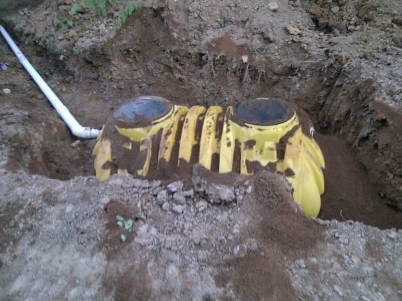

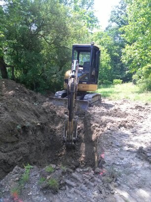

I started putting in the septic system today. I am beat! I feel like I dug the whole by hand. lol
MJW
# Posted: 19 Jun 2012 22:05

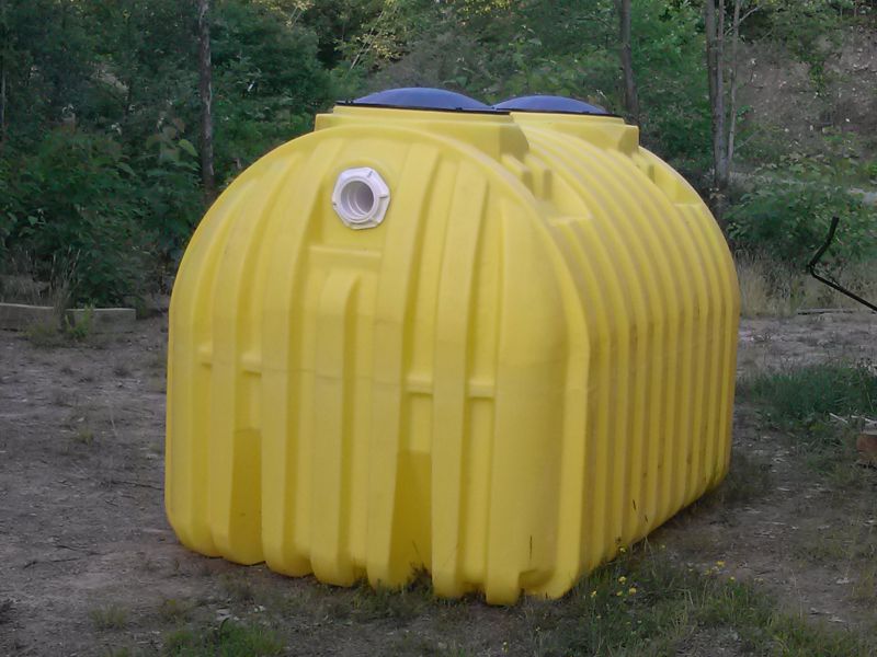

Is that a plastic tank? Never seen that before.
Tim
# Posted: 20 Jun 2012 05:35 - Edited by: Tim
Quoting: MJW

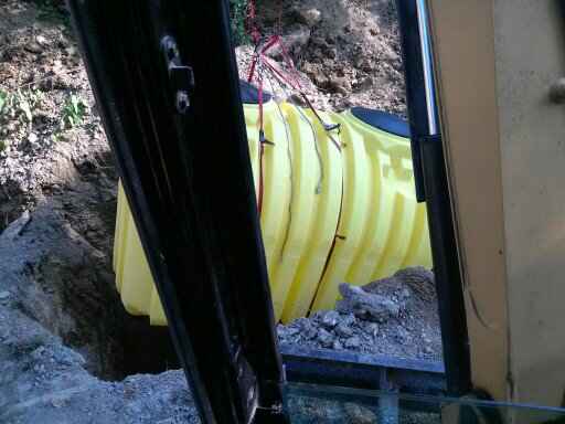

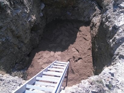

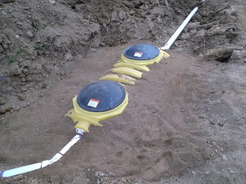

Yep! It sure is easier to deal with than the old concrete ones, that is for sure. Code requires it to be surrounded by sand, so the hole had to be dug a foot deeper and a foot bigger in all directions. Then I will put sand in the bottom and backfill with sand around it. That is to protect it from sharp rocks.
It also has to be filled with water SOON after being burried to prevent it from floating out of the hole if we get a big rain. It comes with the Inlet and outlet "T" baffels already installed.
Total weight, about 200 lbs!

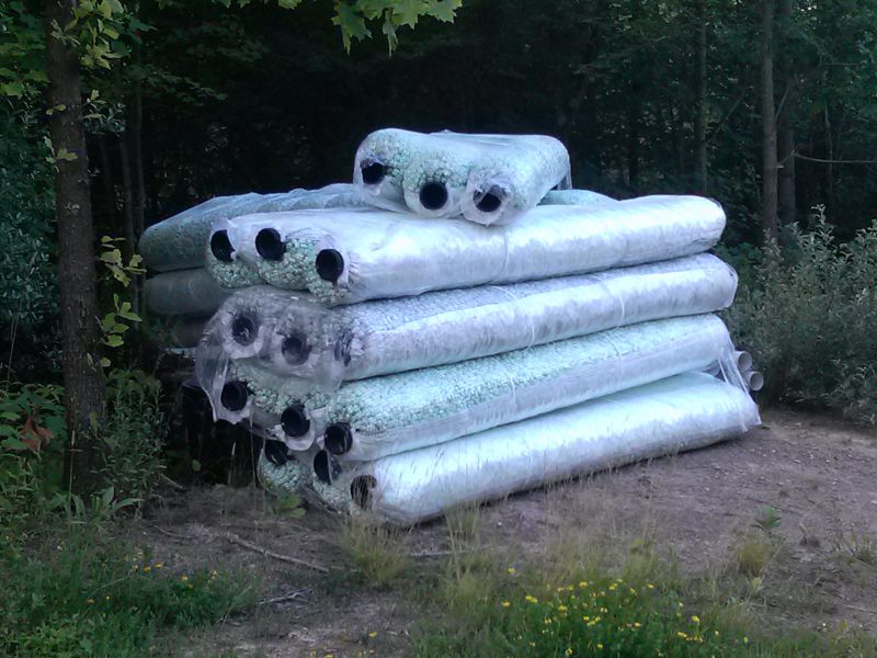

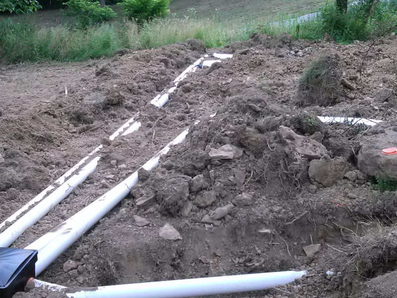

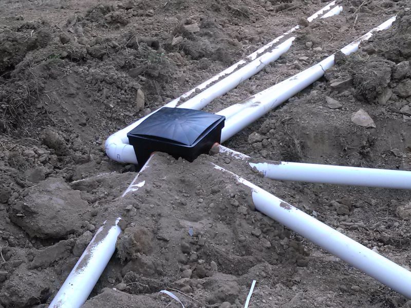

The pipe in the last pic is called "easyflo". No gravel in the trenches, just lay in the pipe and backfill! (after inspection of course!)

Do you have to have some certain soil to use those or is that something new anyone can use?
The last septic I had installed (4 years ago) they used those large curved pieces (the name escapes me right now) for the drainage. I thought that was the latest thing but I guess not!

As far as I know, anybody can use them, but check your local health department.

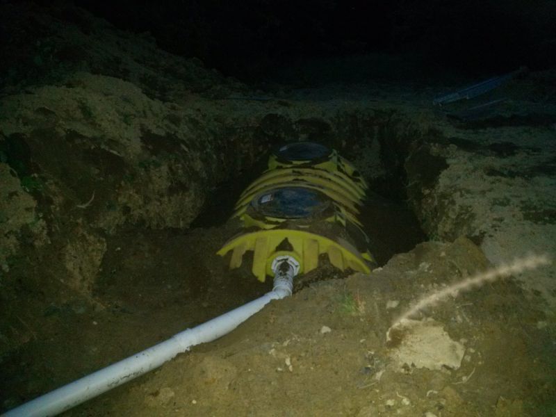

STUPID! STUPID! STUPID!
OMG...... I am so stupid, I just can't believe it. I have done something really, really bad! No, even worse than that.....this is about as bad as it gets!
The septic tank has an inlet, and an outlet. I had it sitting the right way, but somehow when I hooked to it and swung the hoe around, and reversed the way it was sitting. I have set the tank in the hole, filled it with water, and burried it with the outlet tward the house. The fittings are all glued in and the sand is all in place around it.
Someone once told me if it isn't death or dieing, it can be fixed. I have to keep telling myself that before I cut my wrists!

It is going to have to come out. I will have to cut away all the plumbing and carefully dig down around the sides of it, lift it out, relevel all the sand in the bottom, and set it back in the right way.
I basically, have to start all over again.

I got the septic tank dug out and set back in today with less trouble than I thought it would be. Thanks for asking. The inspector is tentatively scheduled for Monday and it looks like I will make it.
