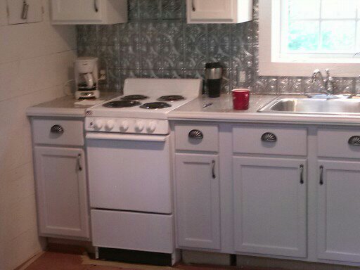

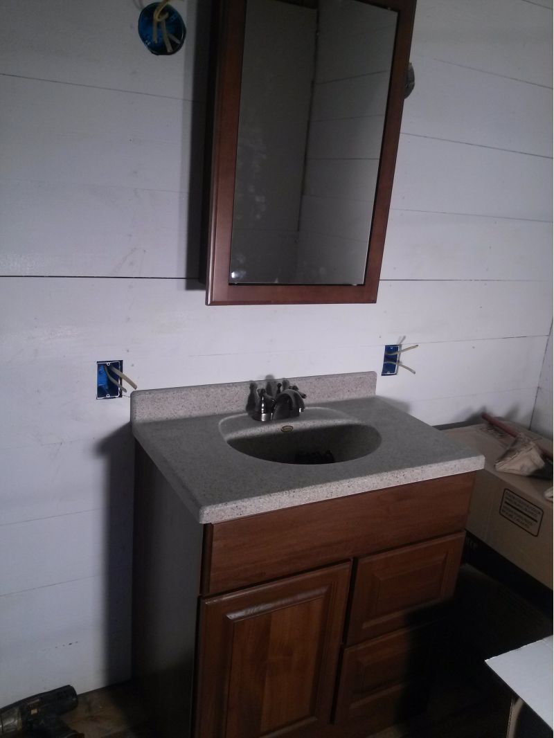

OMG.....we are exhausted! Today we went to Lowe's and Menards. Between the two places, getting the best deals at each....we spent over 6 hours shopping.
We got the bathroom vanity, vanity top (which was cracked when we got it home), medicine cabinet, toilet, back splash for the kitchen, sconces for the bathroom wall, hot water heater, some misc. plumbing and some misc. electrical stuff. Damn....no wonder we are tired! That should keep me busy for a couple of days anyway! lol

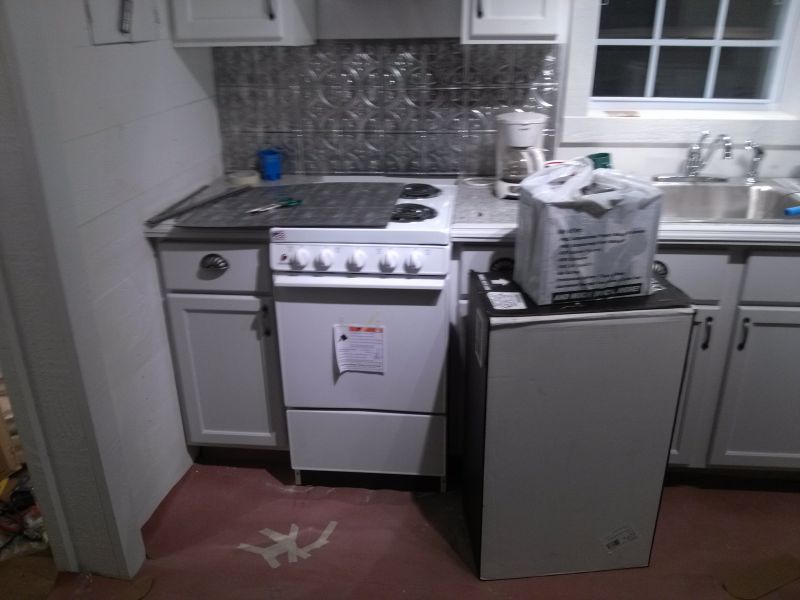

Oh yeah....here is something else! I know better.........I know better..........I know better, but I did it anyway. I trusted Lowe's! I asked them two different times to measure the 20" stove and make sure it was EXACTLY 20 inches! I know, I should have made the trip and measured it myself. When I was installing the cabinets, I didn't want to take the time to drive clear in there, so I called. "Yep!" they said, exactly 20 inches. So, I made the opening exactly 20 3/16" wide. Guess what! The stove is EXACTLY 20 3/16" wide. I litterally had to spray the sides of the stove with WD40 to get it to slide into the opening. But hey, nothing will get between the counter top and the stove, that is for sure!

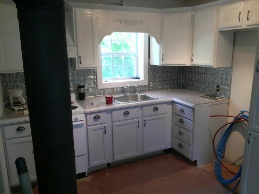

Today, I got the backspash finished, the kitchen stove installed and hooked up, and most of the hot water heater installation completed.

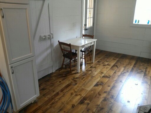

Tonight, I took back the cracked granite vanity top and exchanged it. On the way, I passed an antique shop so I stopped to look for a kitchen table. My wife and I had found a different one that was missing the drawer, but we both loved it otherwise. This one was identical so I felt safe to go ahead and get it without her there. I scored it for $40 bucks which I didn't think was too bad.
# Posted: 4 Jun 2012 22:18
Quoting: Tim
What a deal! The table looks great!!

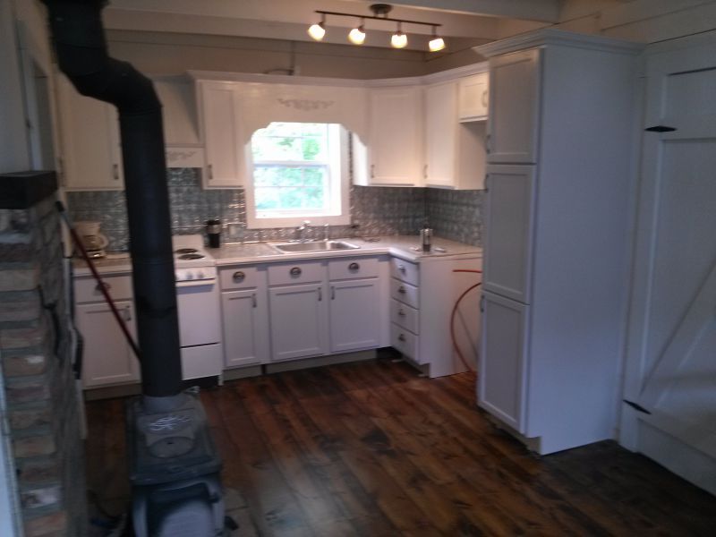

# Posted: 5 Jun 2012 21:23
Coming along................
Tim
# Posted: 5 Jun 2012 21:24
more pics............

Wow Tim! Looks awesome! Are you happy you went with the back splash? It looks great!
Love your table-great find! and felt your frustrations over the tight stove fit! LOL! If ya want something done right ya gotta do it yourself huh???!!!! Glad you were able to make it fit!

I am SOOOOOOO glad you sorta talked us into that. I love the look, and it took about 1/10th the time to install as tile would have. Looking back on the stove thing, it was kind of funny. It would NOT have been near as funny it I wouldn't have gotten it in though! lol

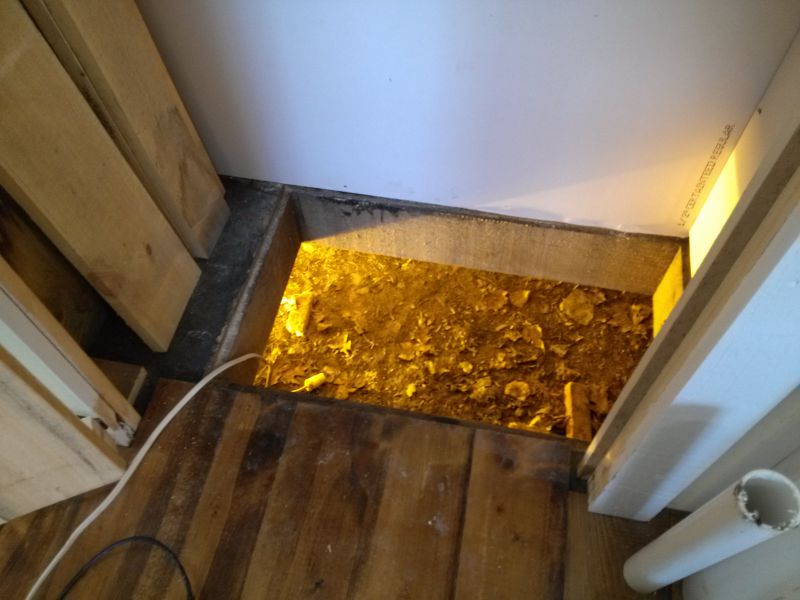

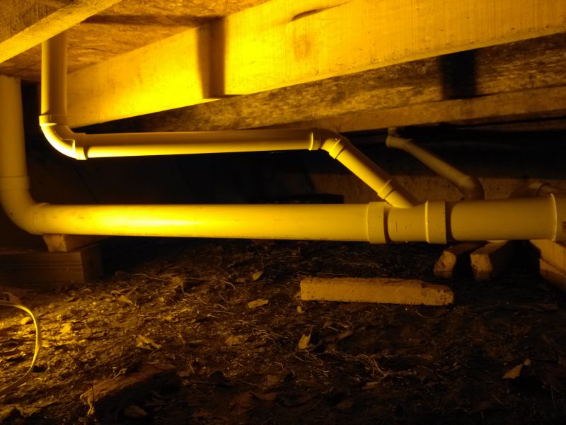

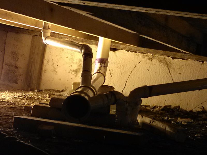

Welcome to the "belly" lol....Yeasterday, I did the "DWV" (drain waist vent) system. It took about 4 hours to plumb the entire house. lol
Come with me to the "underside".
Oh yeah, we also ate our first meal at the new table. It seemed to work just fine! lol
Trap door in closet to the crawl space
Pipes all "dry fitted"
Glued together and ready for service
Leslie eats the last piece of pizza!

Tim,
How much space do you have in that crawl space? My old house had a four ft crawlspace: my dad loved it when he added shut off valves to my water lines. And when we added heat pump, the guys could have kissed us. Now in this house, it's under three ft. I have to hire skinny plumbers.
I LOVE the back splash. I have been eyeing it at Lowes for my current kitchen.
Tim
# Posted: 10 Jun 2012 20:36
Quoting: ErinsMom
yep, it is about 30 inches from dirt to floor joist. Not much room to move around down there, that is for sure.

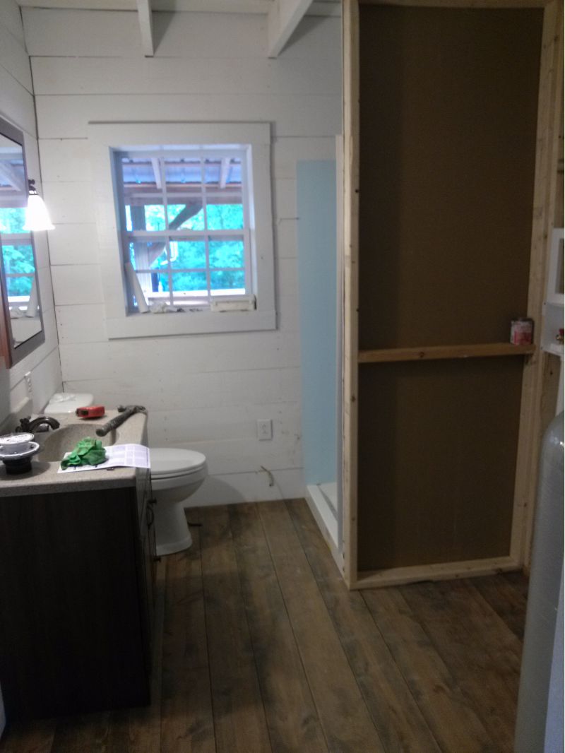

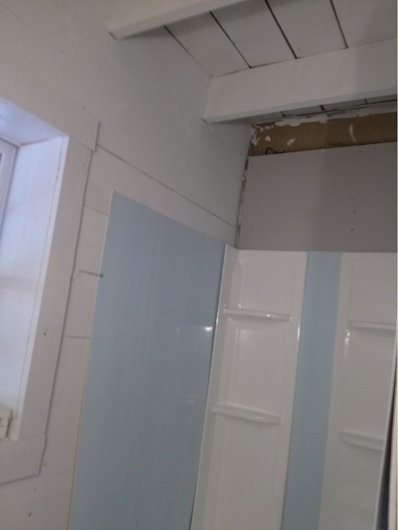

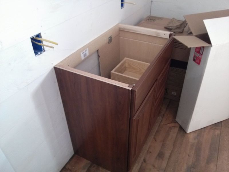

Another "land mark day" today. I finished all the DWV clear outside the foundation ready to hook on to for the septic system. Then, I built some walls, and installed the shower.Well, at least got it sitting there. The base is done, and plumbed. The walls still need glued in place.

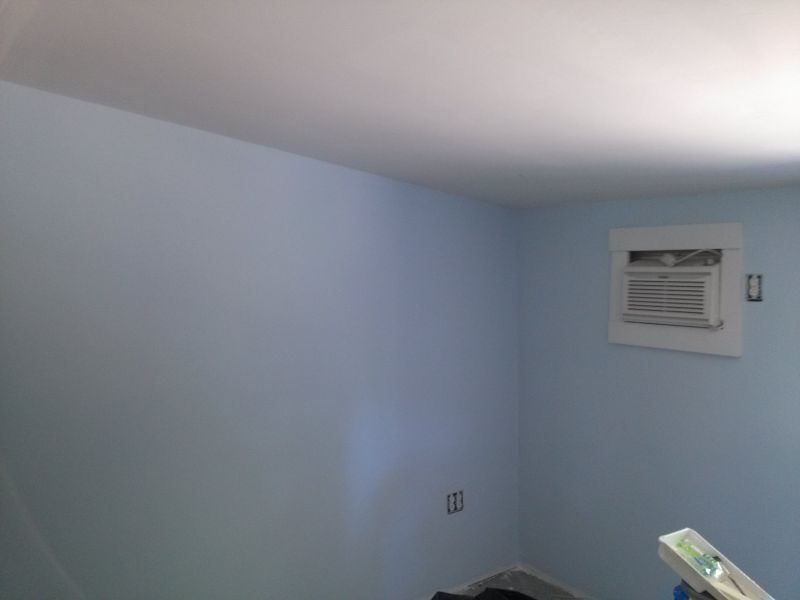

Oh, I also forgot to mention a couple of other things. The wife decided on a blue bed spread. That meant she wanted to do some blue accent walls in the bedroom. (he thing). lol

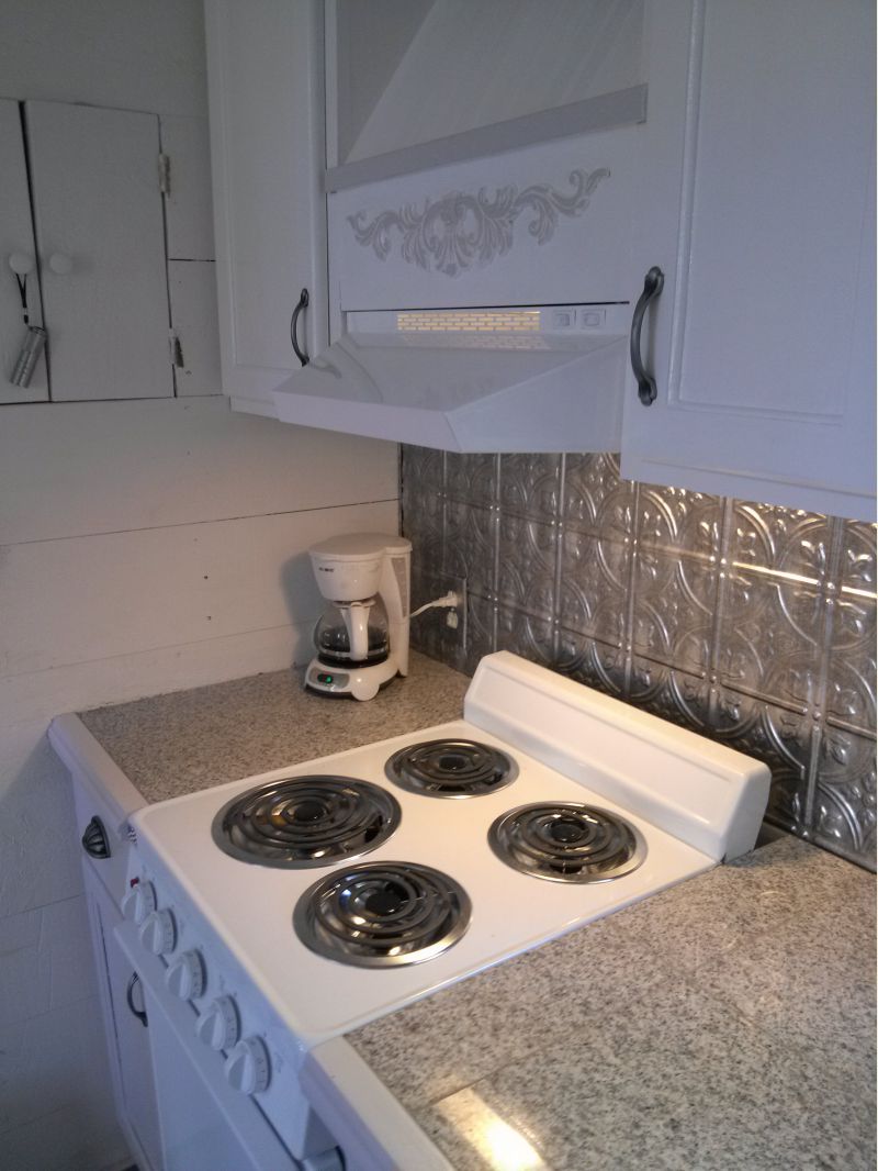

Also, the range hood arrived Friday and I put it in early Saturday morning.
the blue is just a protective film!

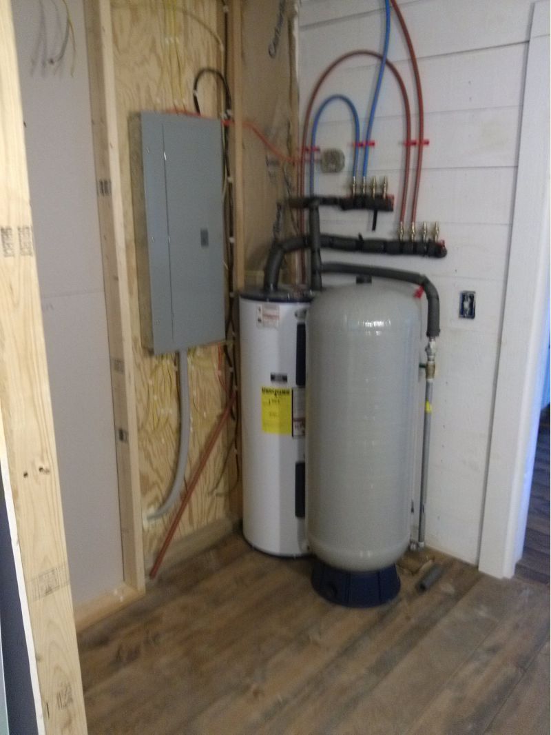

# Posted: 10 Jun 2012 20:52 - Edited by: Tim
more pics

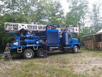

Notice the water tank supplied by the well driller. He says it is matched to the pump and has to be that big. lol......dang, the pump will only have to run once a week! lol
again, blue = protective film
washer hook up beside shower
The well driller doesn't get the "little house concept"!
Nirky
# Posted: 10 Jun 2012 21:20
Let me get this, the grey tank is pressurized by a pump that supplies adequate psi to both the hot water heater & cold water?
Tim
# Posted: 10 Jun 2012 21:22
Yep! You got it.
