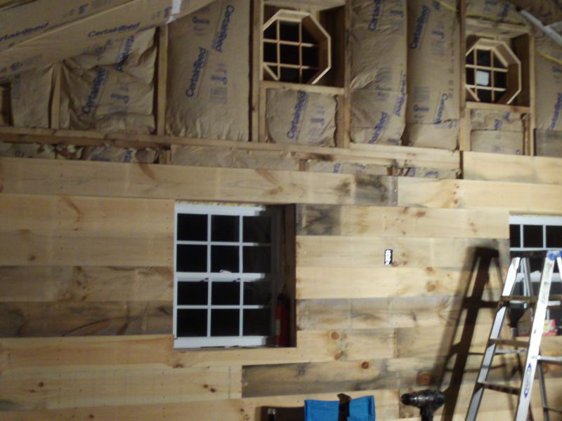

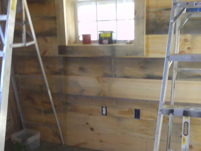

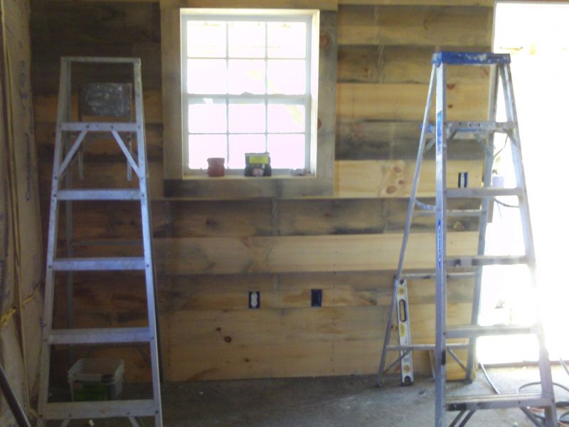

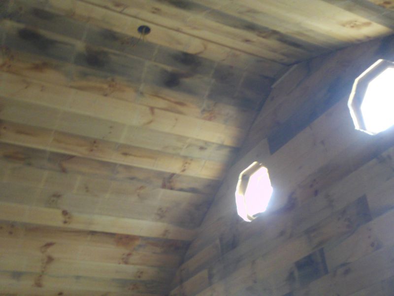

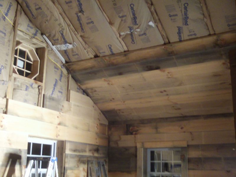

Ok......the lumber came today for the inside! I am so excited!! I got started as soon as the driver pulled out of the driveway from delivering. Here are some pics..............

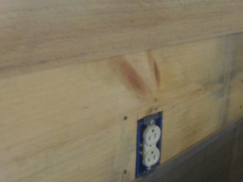

Tim...Wow! You are really going to town there and getting the job done fast! So did you hold your outlets out enough so that you don't have to add the outlet extension box thingy like we have to on each one? Hope so!

lol.....I had the electrical boxes every dept you could immagine. As I was mounting the boxes, the "final" decision on what we were going to put on the wall kept changing. One day I would mount them an inch out to allow for wood. The next, only a half inch out to allow for drywall.
As I hung the wood, I was able to pull the ones I needed to, out a little. No sense in doing it right the first time! lol
But, yes.........in the end, the boxes ended up being out far enough I won't need box extensions.
Tim
# Posted: 10 Mar 2012 22:30
LOL! Good for you Tim...you saved yourself $1.44 each!!!! The only positive we see is that there is more room to shove the wires into! LOL!

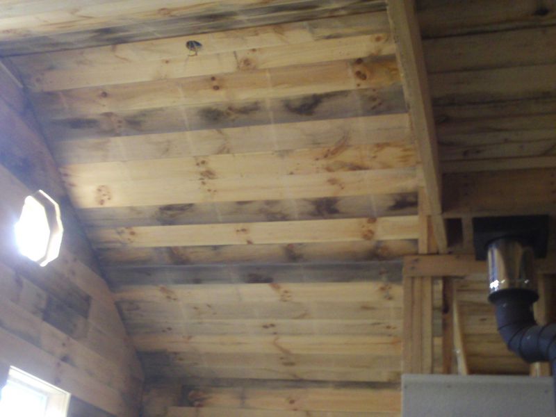

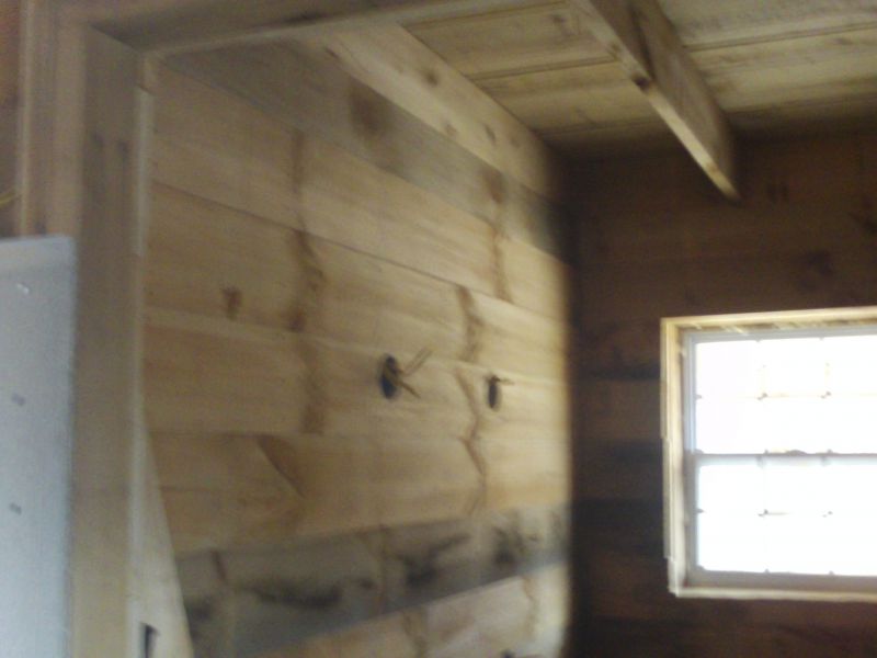

# Posted: 13 Mar 2012 06:19
I finished the rest of the living room, and the bathroom this weekend. Now, all that is left to do is the bedroom and loft.
Here are more pics:

For you! lol.........every dime counts!

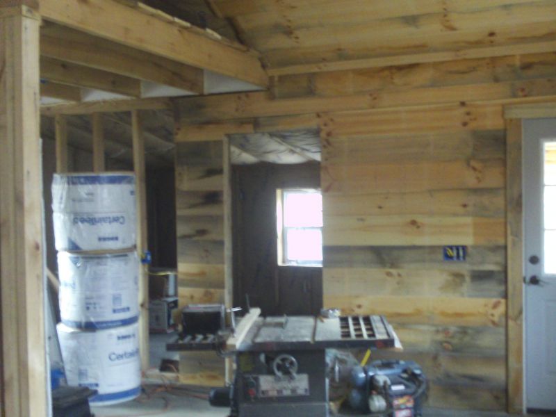

Is that rough cut lumber your using on the inside?T and G?
awesome cabin
Tim
# Posted: 16 Mar 2012 21:26
Yes, that is rough sawn pine. The mill I got it from saws with a band mill, so it isn't as rough as some. It has been stored inside at the mill for just over 5 years, so it is completely air dried and won't shrink like the green lumber will. It is not tongue and groove, just butted together tightly. She wanted the cracks to show when we paint it white.

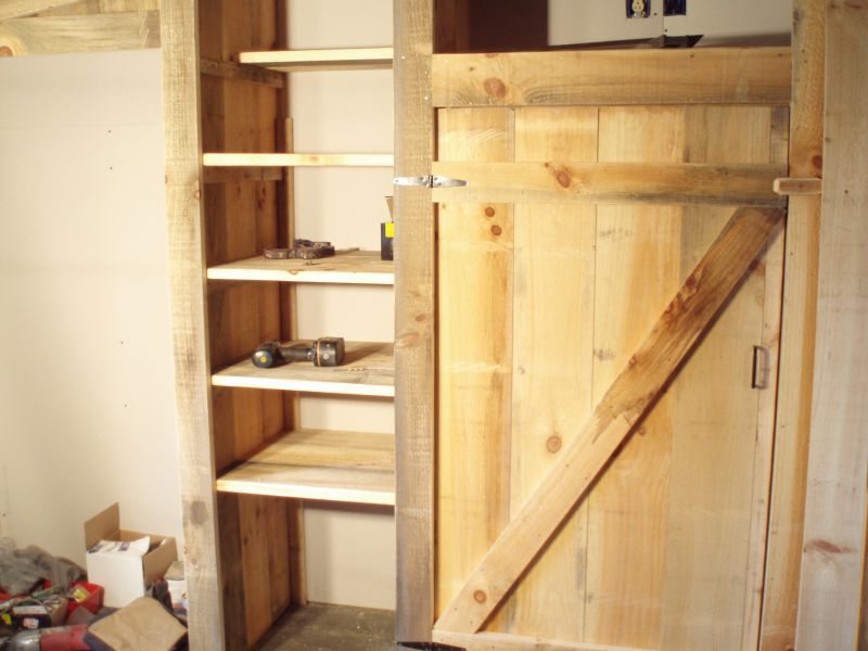

I have been working on the inside. Wow, is this time consuming! Here are some pics of what I have gotten done.

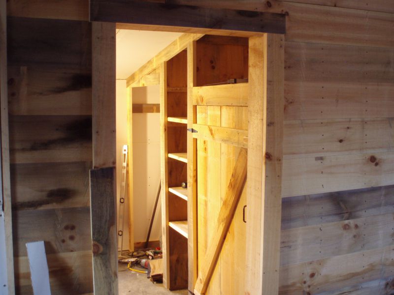

Bedroom closets and shelves

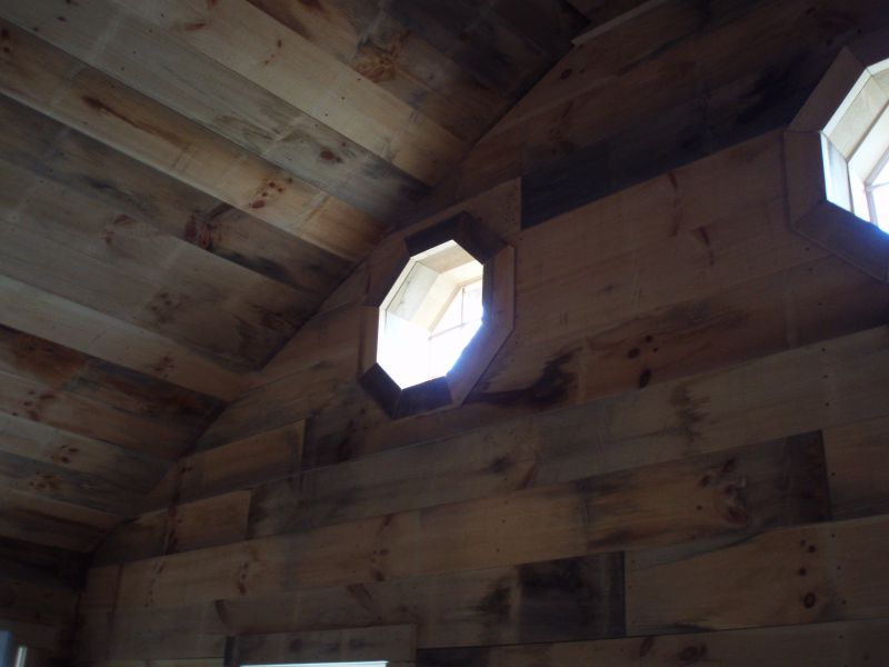

Octogon windows trimmed

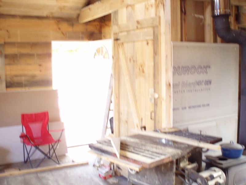

Bedroom door frame trimmed
coat closet door in livingroom

It sure is looking good inside your place.....I like your closets/shelving and the doors look great too!!!!! Good work Tim!!!

# Posted: 25 Mar 2012 10:00 - Edited by: Tim
Quoting: trollbridge
Thanks! She is planning on putting wicker baskets on the shelves for underware, socks, bras, etc. Kinda like fancy drawers. A larger basket will go in the bottom for a hamper basket.
The closet with the door in it will be mine. The one to the left of the shelves (no door yet) which (of course) is a little larger....will be hers. lol + the shelves will be mostly hers of course too.
# Posted: 25 Mar 2012 12:11
Those shelves will look spectacular with nice wicker baskets on them!! You have done a beautiful job!!!

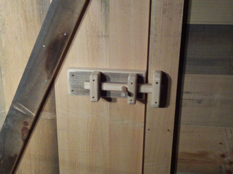

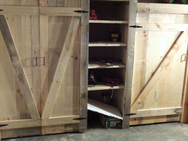

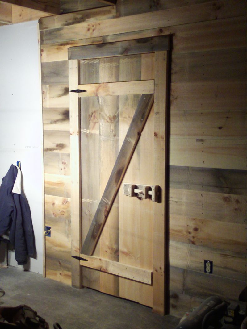

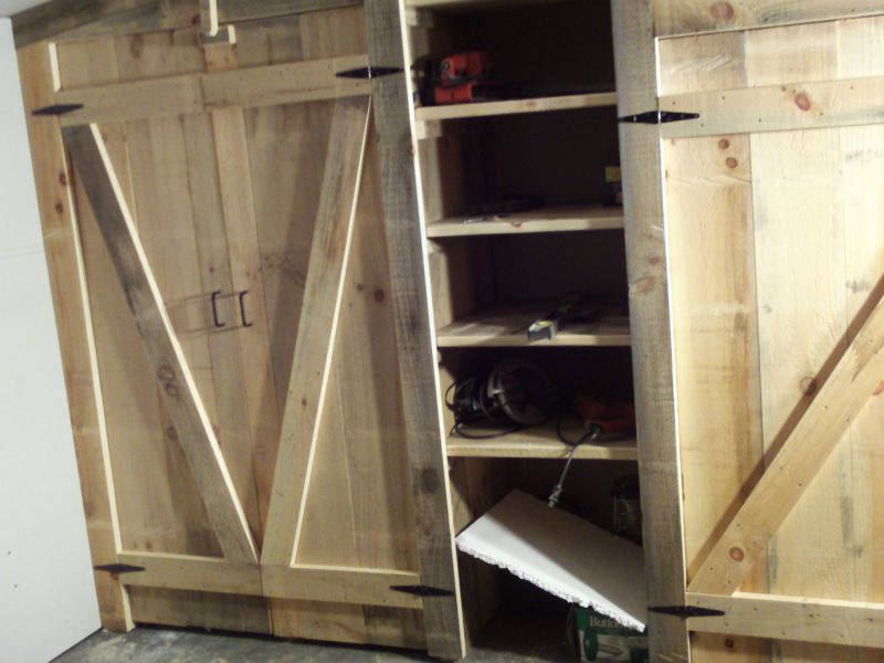

# Posted: 30 Mar 2012 21:00 - Edited by: Tim
More inside pics:
Bedroom door
Bedroom door
Door latch
Door latch
Second closet doors done
