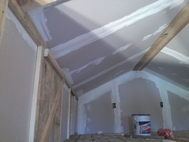

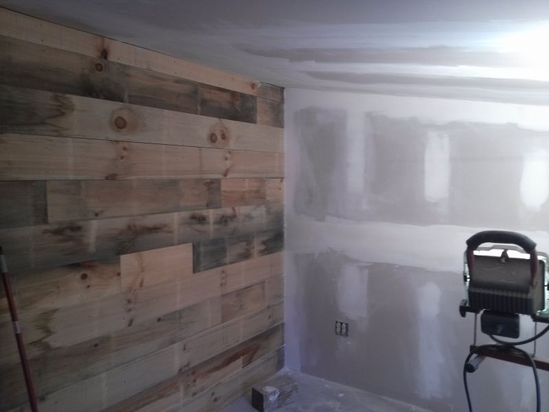

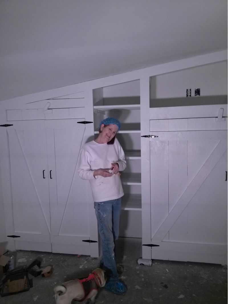

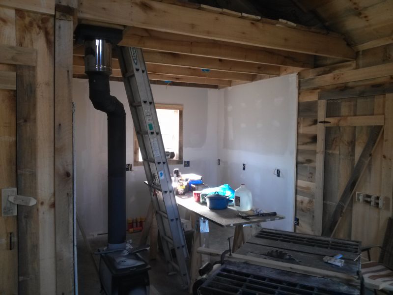

The down stairs drywall is finely finished. Now, all I have to do is up in the loft. Here are some pics.

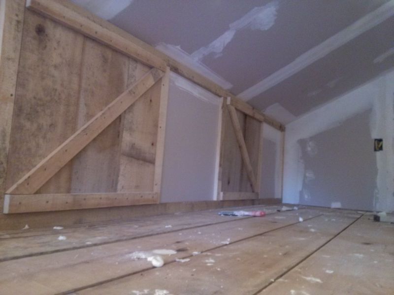

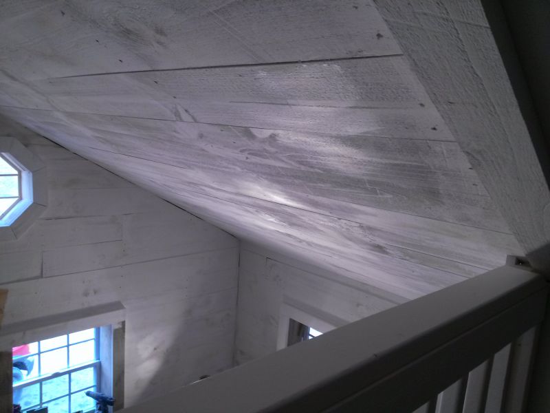

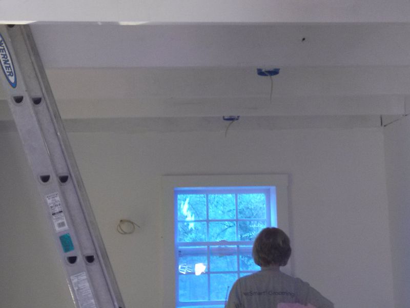

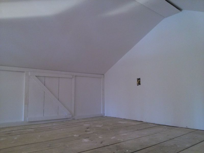

# Posted: 11 Apr 2012 09:41pm
I worked on the loft today. Trying to get everything done before the weekend for the paint party. Here are some pics I took just before I left tonight.
Tim

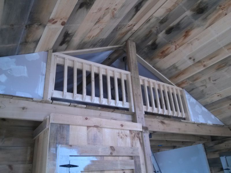

# Posted: 12 Apr 2012 09:27pm
I finished mudding the drywall today, then built the railing.

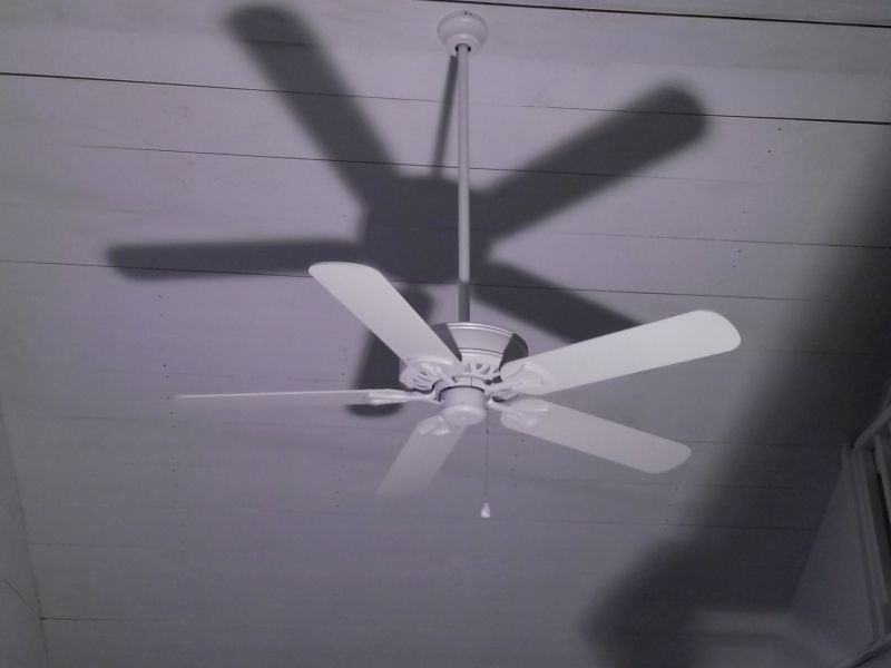

# Posted: 17 Apr 2012 09:20pm

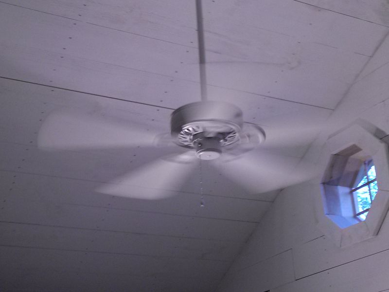

Tonight after work, we went to Lowe's and bought the ceiling fan and light for the kitchen ceiling. Here are some pics.

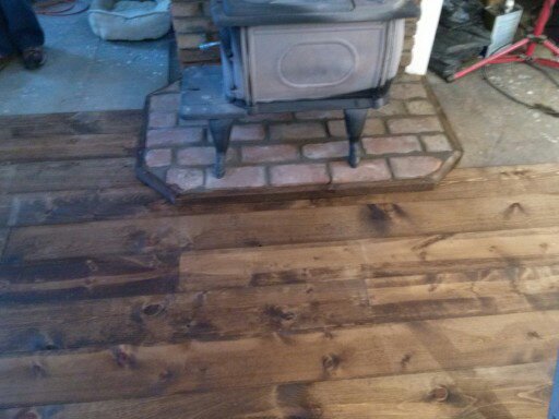

# Posted: 29 Apr 2012 08:29am
If I never see another paint brush, it will be too soon! lol We put on a total of 20 gallons by the time all the touch-ups were done.

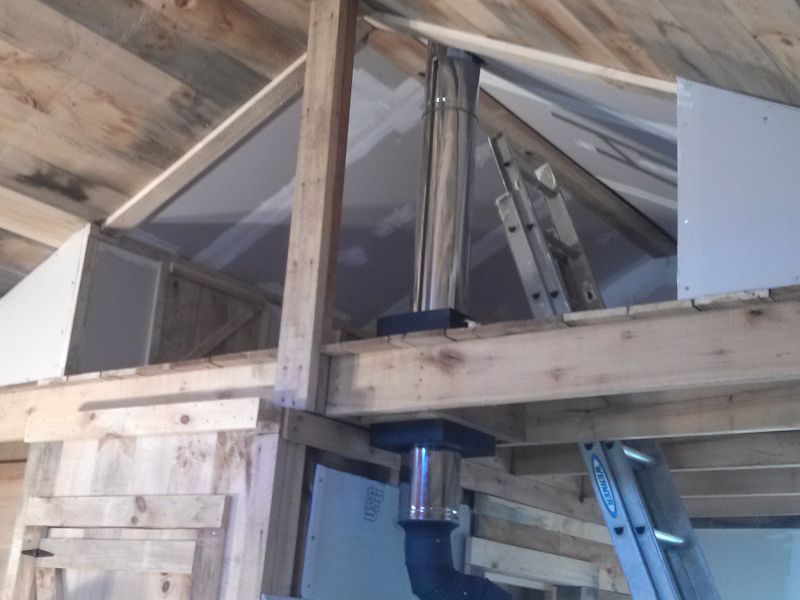

Now, it is time for flooring. We stained 320 square of floor boards yeasterday. While it dries, I started the wood stove hearth. We found a free source of brick from a historic building that burned down in the area, so decided to do brick instead of the stone we originally planned.
I should finish the brick today and get started laying the floor.
In the pictured, the stove looks way too close to the wall, but it isn't as close as it looks. I can lay my hand on the wall with the stove roaring. It doesn't get hot at all, just warm to the touch.

# Posted: 29 Apr 2012 09:07pm

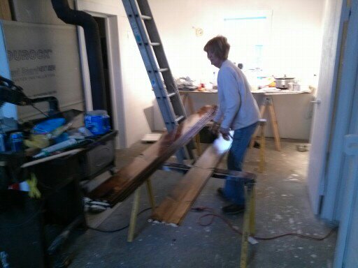

I'm just gettin' too old for this! lol....I'm beat! Here is what I did today:

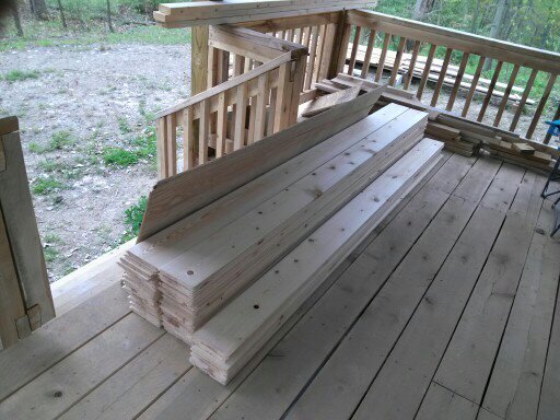

Tim
# Posted: 30 Apr 2012 11:02am
Thanks Troll,
Actually, I learned a little trick to save a ton of money on the flooring. That floor, is actually "V groove" tongue and groove barn siding. Like the stuff they use on a lot of storage buildings.
The local lumber yard has it in both 6" wide, and 8" wide. On the front, the 6" has both a "V groove" down the middle and a bevel on the edge so that it forms a groove at the seam. On the back of the 6" there are only the bevels on the edges.
BUT! The 8" has the groove in the middle of the front and a bevel on the edges....but the back is totally smooth!
So....that is what the flooring is......barn siding turned upside down.
It was .70 cents a foot. The 8" gives you 7 inches "net". So, that is a little under $1.40 a square foot. I don't think you will find any flooring for sale new for less money.
Leave it to old "tight wad" here....if there is a way to save a buck without it showing.................... lol
