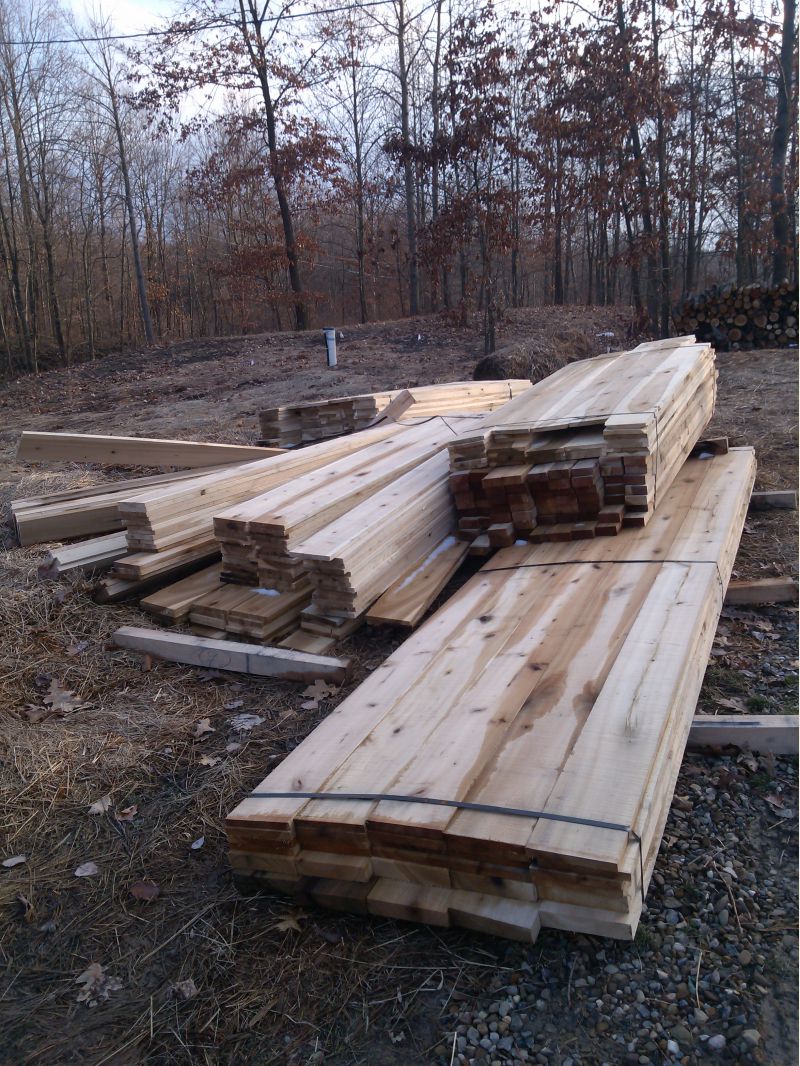

Hi everybody...... It's been a long winter! Our little cottage has been as warm and snug as we ever could have wanted. Now, the weather is getting a little better so, guess what. GARAGE TIME!
The poplar from the mill was delivered Tuesday, and the treated posts and skirt boards were delivered this morning. It will be a 20X20 pole building with a 16X16 shop attached to the back. Setting posts this weekend! Tim

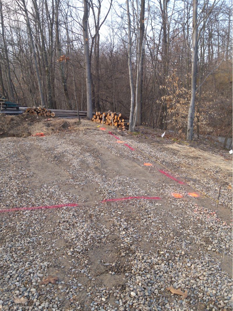

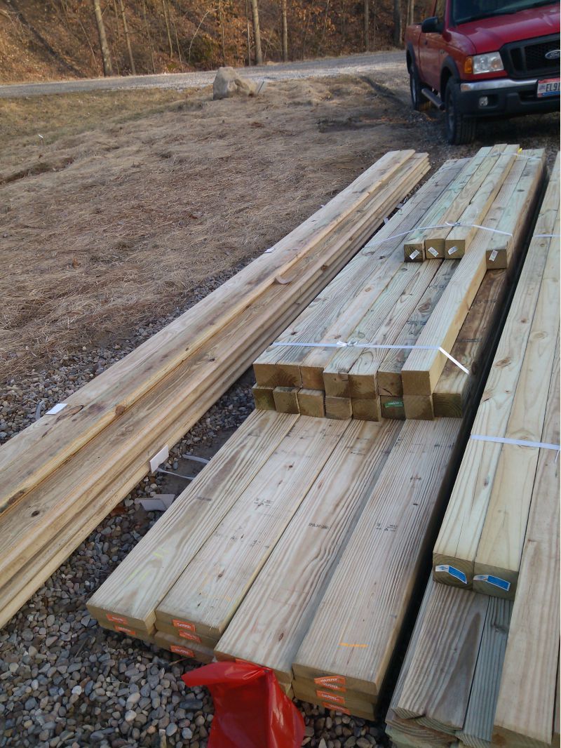

Here are a few pictures of our building site and materials ready to go. 0307131719.jpg

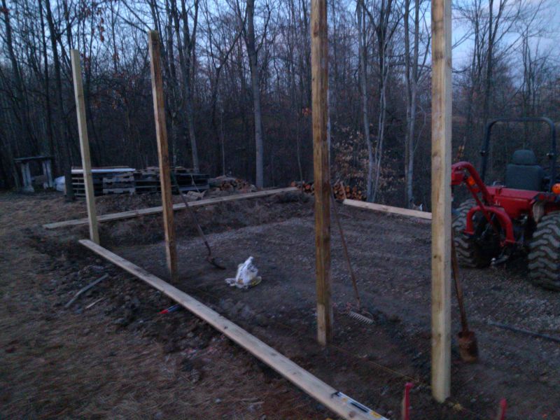

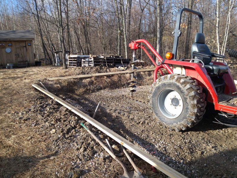

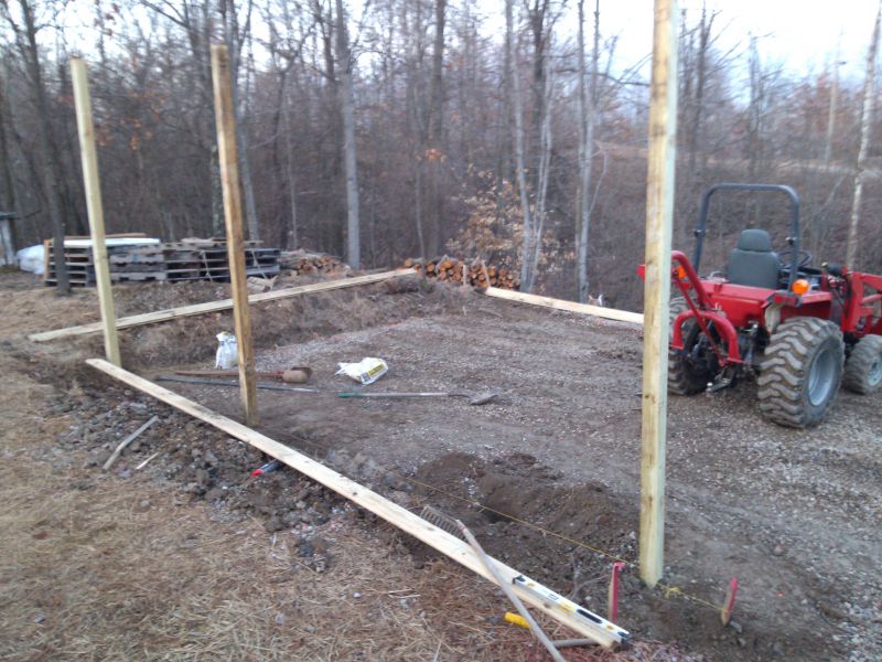

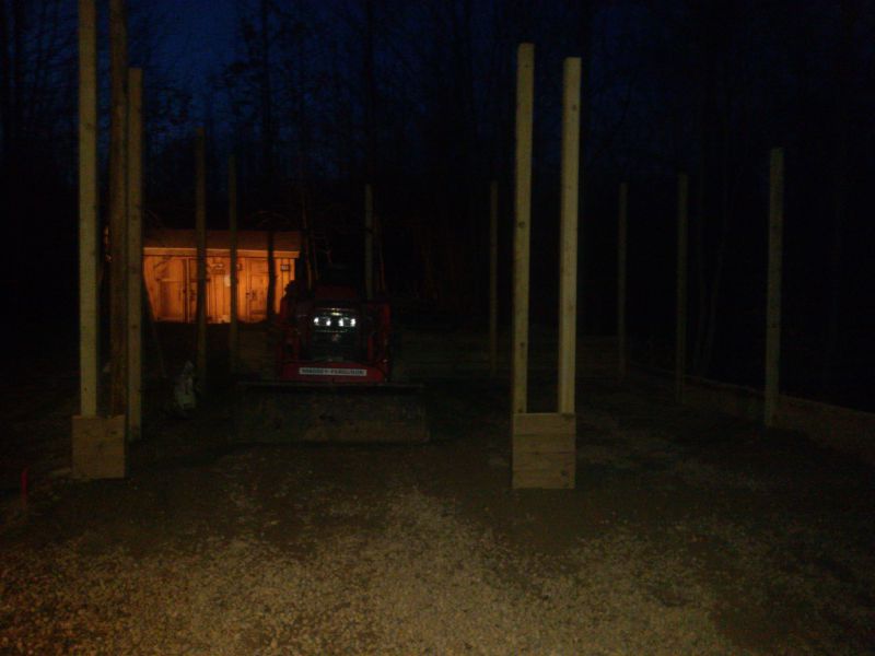

Tonight after work, I got some holes drilled, and 4 posts set. 0308131638.jpg

Hey Tim.....it's been awhile since I have written to you! Are you building this project at the cabin site or at home? Don't you ever take a rest?
I was in you neck of the woods last Saturday. I attended the birthday party for my 100th year old great aunt at the Sugarcreek Golf Course. It was quite a gathering. She was the last sibling of my grandfather (on my side). The oldest sibling died in 1965 at 72YOA, my grandfather was next at 67 YOA. Since then, the siblings lived to be 94, 96, 98, 101 and the last one turned 100 on Saturday. Sounds like a Guinness World Record for longevity doesn't it?
I'll keep up to date with your progress. I didn't see a spud-bar or post hold diggers in the photograph. I couldn't imagine how much easier an auger would have made our job with the 18 holes we "hand-dug.":-

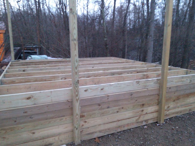

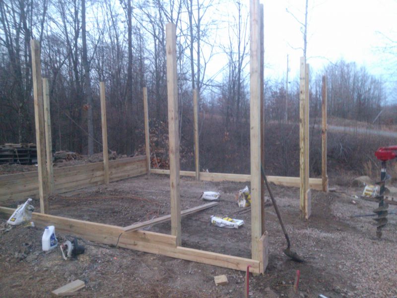

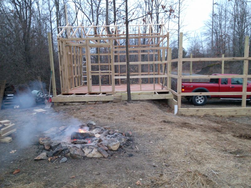

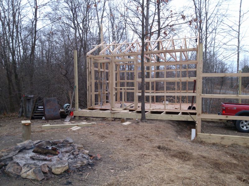

Tim
# Posted: 17 Mar 2013 08:09pm
Reply Quote

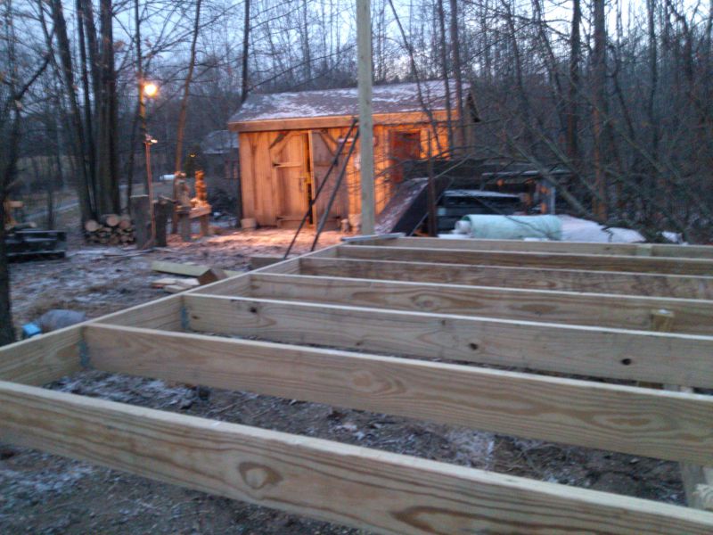

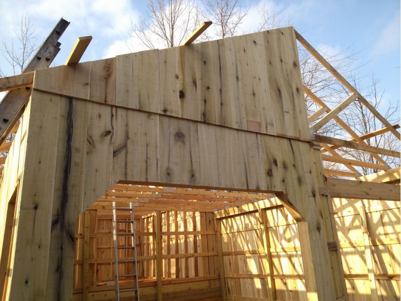

Here is a garage / shop update: 0317131910.jpg

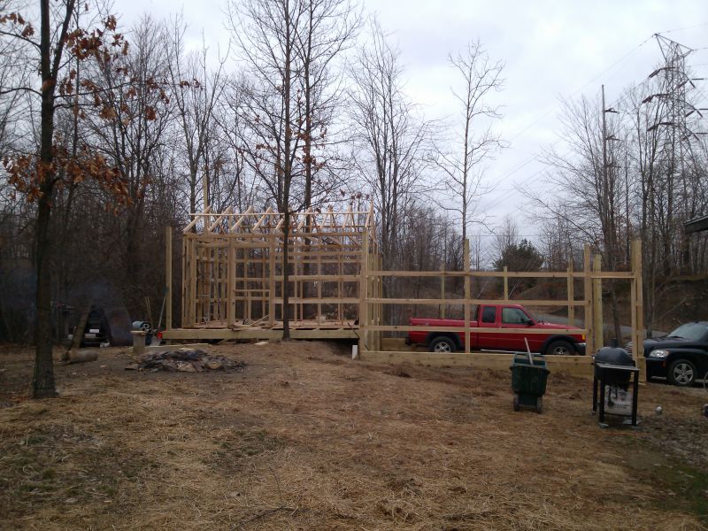

Tim
# Posted: 3 Apr 2013 01:05pm
Reply Quote

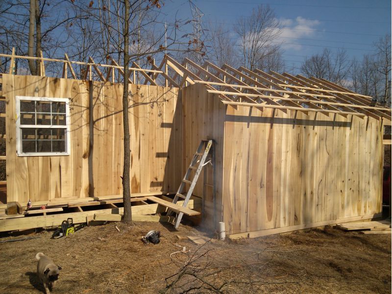

The garage and shop are coming along....if this dern weather ever gets warm, it will sure go faster! Tim 171127_orig.jpg
