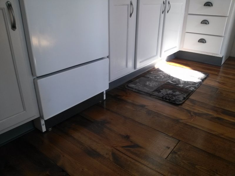

# Posted: 25 Jun 2012 14:24
Tim, I have to ask (even though I read through all 15 pages of this thread and miss the answer).... I have always resisted my partners idea of putting down dark stained wood on the floors at the cabin! I see yours and I think "WOW!" Yours are so nice looking I love it!! What flooring did you use??? I also see dfosson has also used dark wood flooring in his small cabin...Love it also! Thanks
Sustainusfarm
# Posted: 25 Jun 2012 14:29
Tim, I meant this question for rifraf...however, I see your floors are dark stained as well....so please feel free to answer as well....
Tim
# Posted: 25 Jun 2012 20:11
Quoting: Sustainusfarm
My floors are the same type of siding that Dfosson used on his inside walls. The type I got, if turned over, is flat on the back. I just turned it over, stained it, then glued it down with PL200. I urathaned it after it was down.

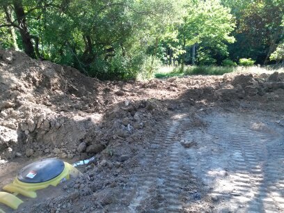

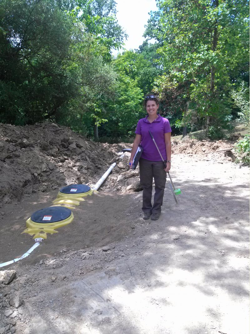

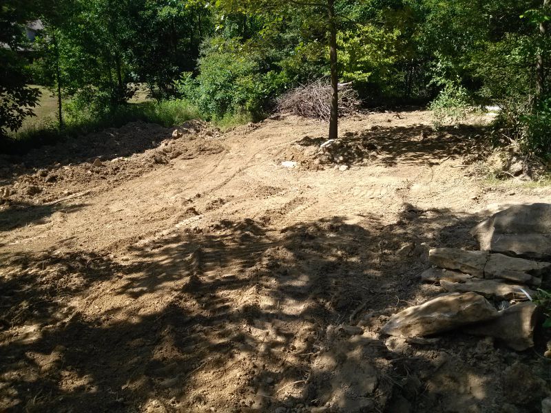

IT PASSED!
No problems at all.....she said go ahead and backfill. Before she was out of the driveway, I was on the track hoe!
# Posted: 25 Jun 2012 20:37
GREAT NEWS!!!!! Congratulations!!!!
# Posted: 25 Jun 2012 20:47
Congrats Tim!!!! And I see you got a picture memento to keep of the lovely inspector!!!! LOL!!!

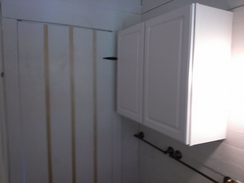

# Posted: 30 Jun 2012 20:57 - Edited by: Tim

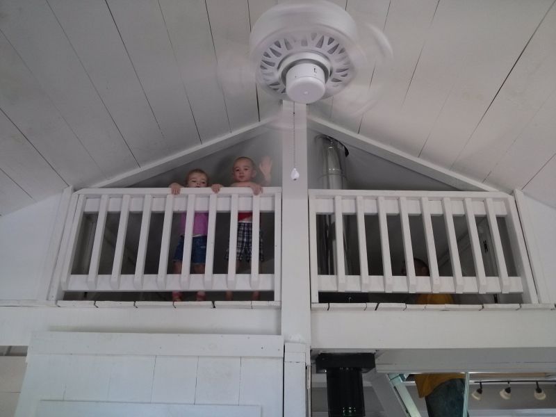

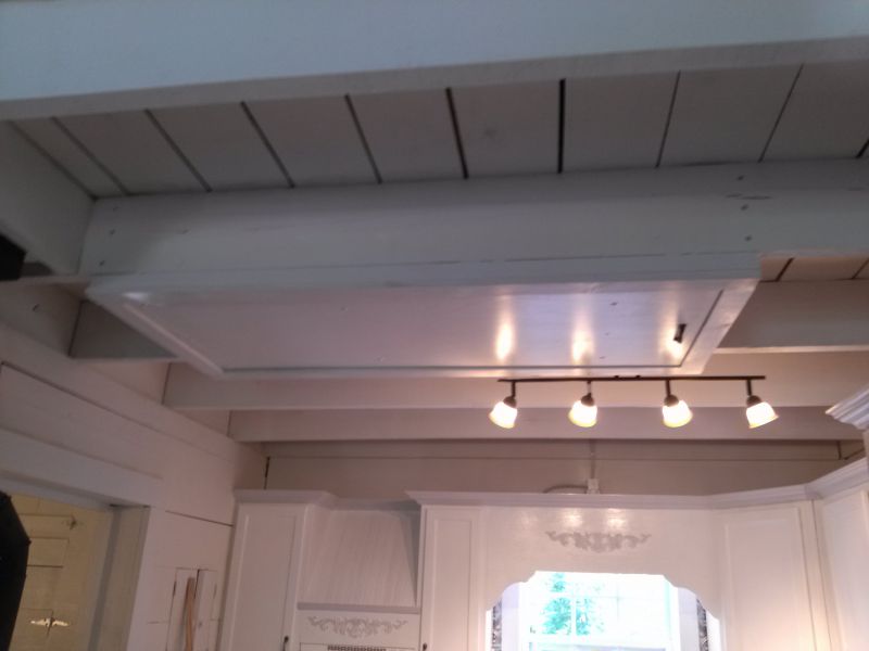

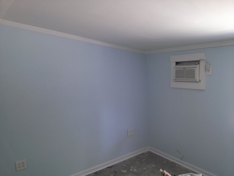

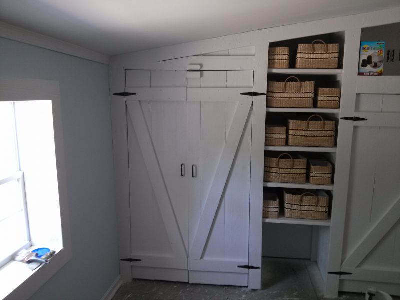

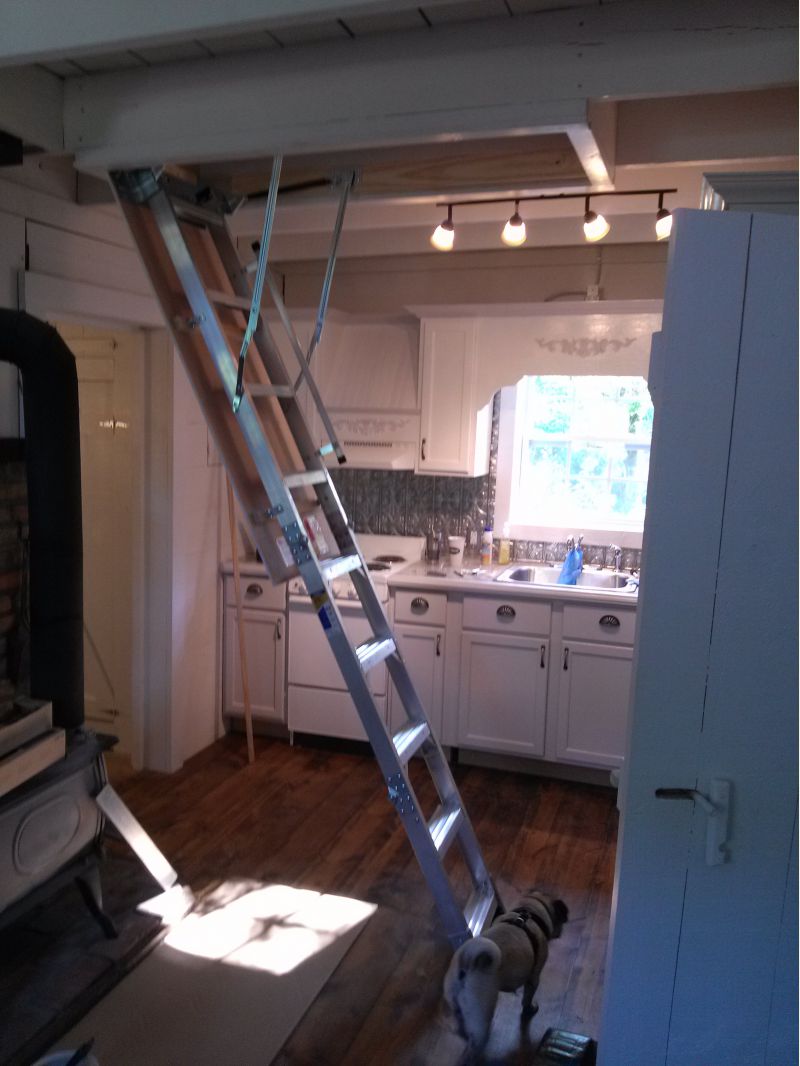

I've been back inside finishing all the little details. Today, I installed the dropdown ladder to the loft, put underlayment in the loft, installed the crown molding and baseboard in the bedroom, and did some touch-up painting in the bathroom.
"The guy" is coming monday to measure for carpet in the bedroom and loft.

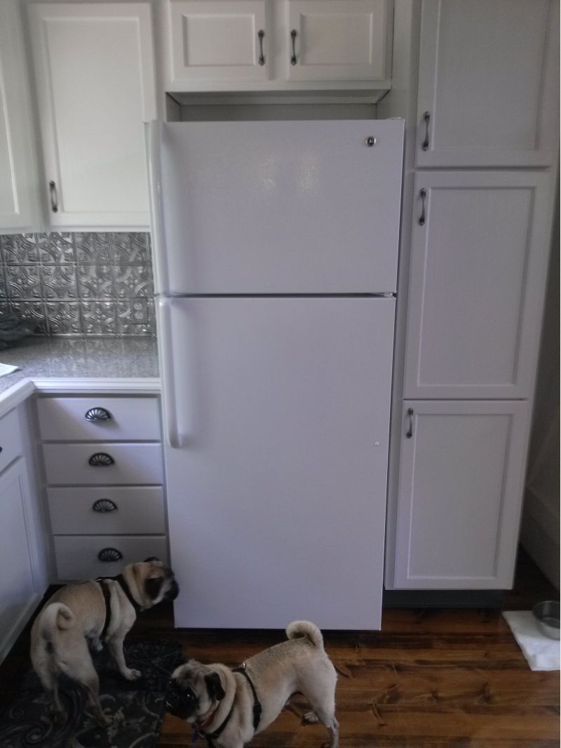

I am off the rest of the week. We spent all day today working on "the little things". Lowe's is delivering the refrigerator tomorrow between 8am and noon.

Oh, my daughter stopped today with the grand kids. They tested out the loft and said it will do just fine! lol

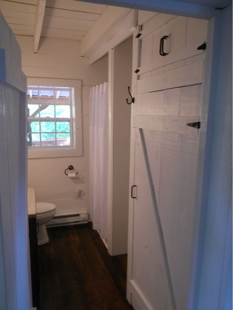

# Posted: 6 Jul 2012 22:58

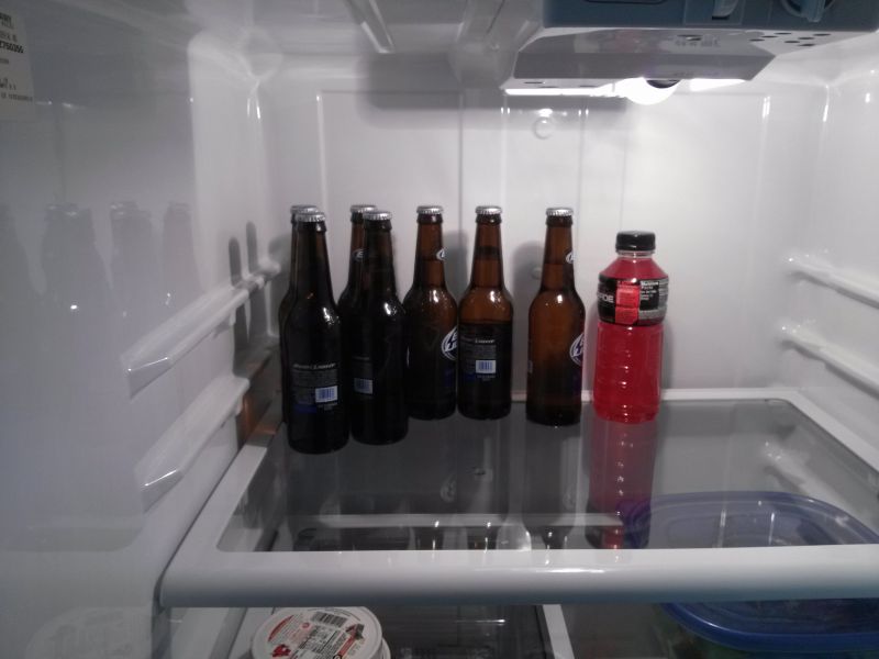

Running water..................check
Flushing toilet...................check
Working shower...............check
Refrigerator......................check
Beer in the fridge!.............CHECK!
Yep, the cottage is now livable!
Tim
# Posted: 6 Jul 2012 23:04
more pics.................
