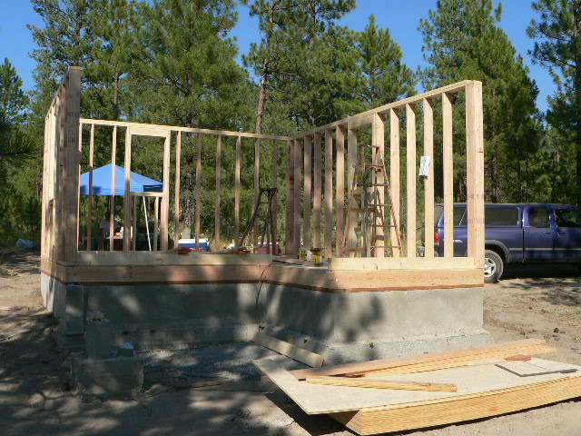

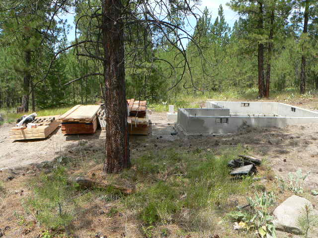

Ok, a few pictures. I sub contracted out the foundation. First picture is where I started from, foundation in place, lumber package delivered the day before.
Foundation in place, lumber pkg delivered
Floor in, some framed walls in place

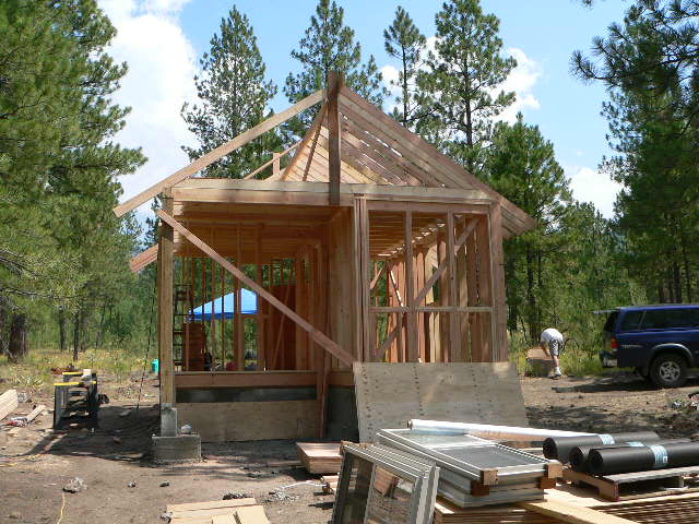

Installing rafters (2X6, 16" OC)

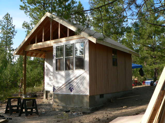

Rof in place, vapor barrier and sheating installing

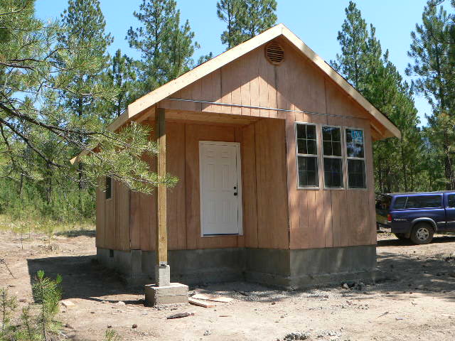

The dried in shell took 9 days to build, not including the porch. We ran into 3 quick lightning and rain storms which drenched everything. This set us back a few days. Should of been able to do it in 7 days instead of the 9 days. We did use compressed air for nailing. I made a trip back to finish the porch, steps and soffit over the porch area and collar ties in the attic. Along with some slight backfilling and hand grade work. Most backfilling was done with a locals tractor, I just did the finish work by hand with a rake and shovel.

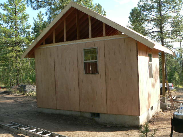

Sheated below, now the gable ends

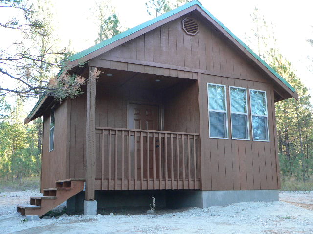

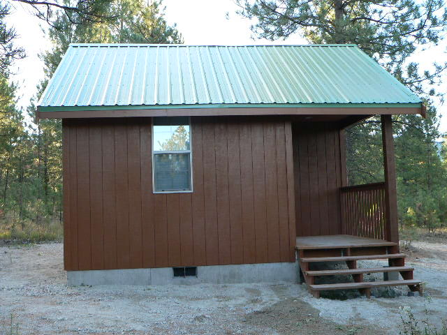

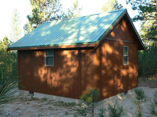

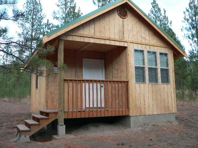

Bascial dried in shell, metal roof was subleted out. No porch yet

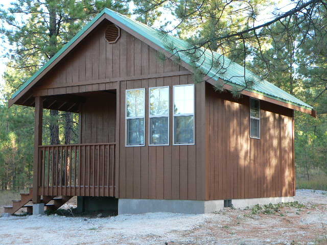

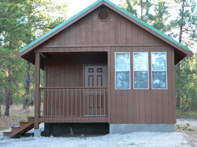

Metal roof in place, porch all built.

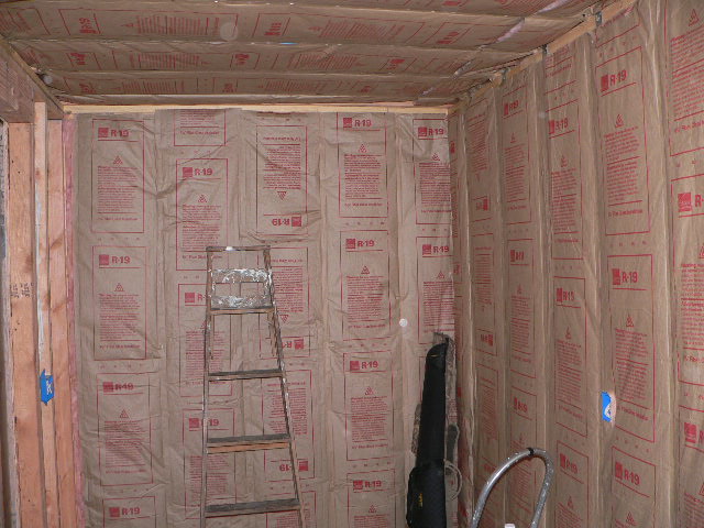

Its so well insulated and small, I can heat it with a candle.
Insulation in place

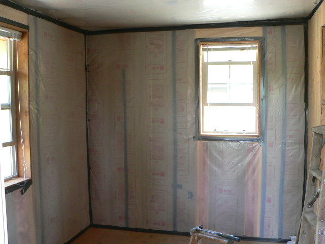

additional plastic vapor barrier in place, sealed air tight

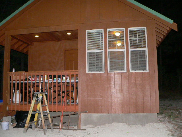

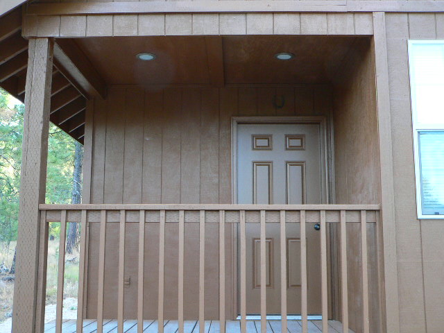

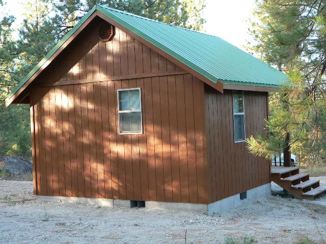

Ok, painted the outside in Forest Service Brown. Trimmed out all the wiring. Stone mason doing the fireplace hearth and wall next. I will install flue and start more interior work in the spring. Pretty much done for this year.

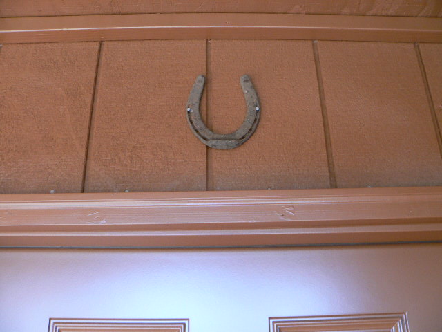

# Posted: 2 Oct 2010 11:38pm
Here are a few more pictures. The horseshoe over the door was the final touch.

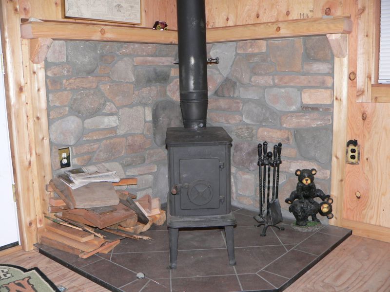

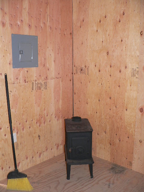

# Posted: 3 Oct 2010 12:40pm

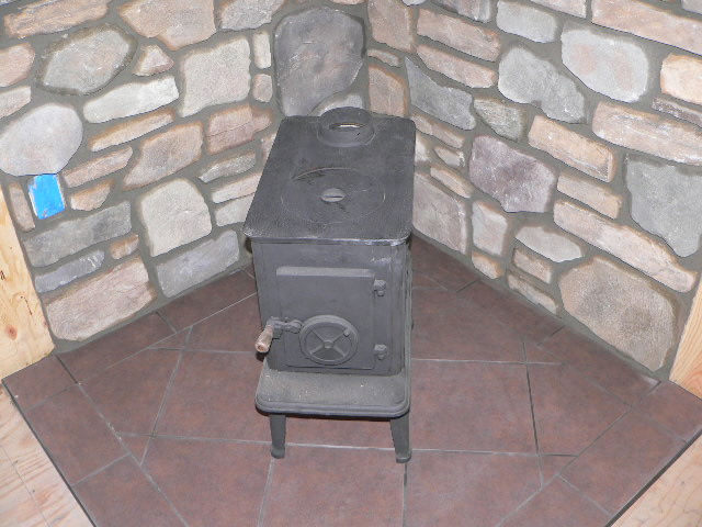

Here is a preview of the woodstove in its final corner minus the stone work and pipe. I just set it where I wanted it for the stone mason. I may ride over with him if he does it on a weekend. ANd I 'll add a picture of it lit up at night, power courtesy of a Honda EU2000i. That little generator has been a blessing. Without a doubt, the best purchase I have made in a long time. I liked it so much, bought the bigger Honda EU6500is, it has electric start and is just as quiet. But the little Honda has been so handy...
Fireplace in its final resting spot, stone work next...
Power by Honda EU2000i

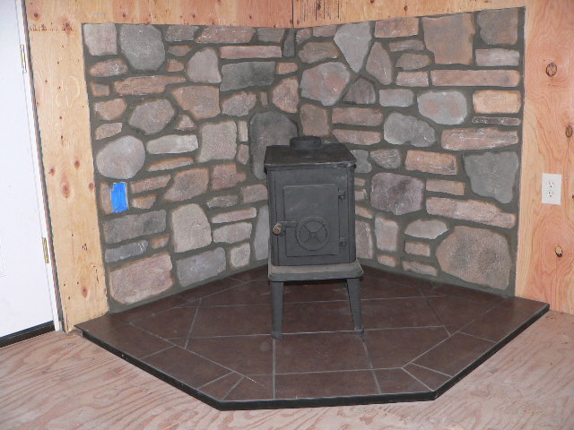

Gary, its done. I did some horsetrading. We have a motocross race team and I overhauled 3 dirt bike engines on a guys kids bikes. We have become great friends and he is a stone mason by trade (owns his own business) and we got it done all today. We pull out of my driveway at 4:15AM this morning, drive time was reduce because little traffic. Got there, stopped into Home Depot, picked up some backer board and screws. Headed out to the cabin. Got there at 10AM. Was done and all cleaned up and pulling out by 2PM. Got home at exactly 7PM this eve. First time i have went there and back all in one day. 620 miles round trip. He drove, used his Duramax truck. Anyway, here is some pictures. The mortar between the stones will turn more of a light gray. Mortar is still green. I will trim the perimiter of the stone work. The top will be finished with a wooden mantle. All the walls upper corners wil be finished in 2X2 cedar. I'm beat. I have been up for almost 16 hours now. Should sleep good tonight.
Here is some pictures. The hearth I called and just bought. Its code and has the fire protection it needs. These range from 300-500 each. He was locating one for me, tells me he has a damaged one he would sell for 150 out the door. I said sold. It has a crack in the grout, only noticeable in you bent it. Once installed, laying flat, it disapeared. I told him its a rustic cabin and all that give it character.
# Posted: 23 Oct 2010 10:46pm
Stove i s a Fjord and I bought i t off of craigslist. Its a little trashburner style. Got it late last year. Its small, and the cabin is so well insulated, its going to run my out of there easily.

I have always liked that color combination -- Forest Service Brown with the green metal roof. It reminds me of the state parks I visited so often as a kid. Really nice work on the cabin. Can you tell me who makes the Forest Service Brown? Do you have the paint code for it? I web search on this got me nowhere. Thanks.
# Posted: 7 Nov 2010 12:55am
I had it custom mixed. I have the paint spec tag on the can. I can take a picture of it and post it here if you like. You can take it to Home Depot and they can mix you up the exact color. I had it custom mixed from a picture I had taken just for the reason of duplicating that color. I have always liked National Parks and National Forest, so I went with the same color paint. You should see my driveway sign, I replicated the trapezoid shape also and the color scheme. Here is a picture of my driveway sign. I smudge it slightly to retain some of my privacy, but you can get the idea.

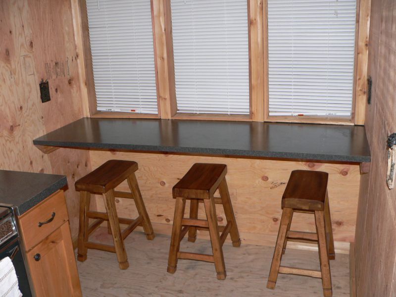

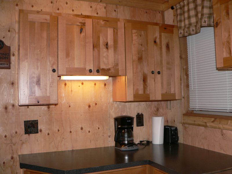

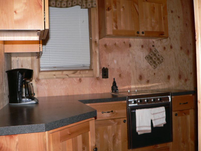

OK, I did post them, probably in another thread. I suppose i should of kept them in this thread on my project. I'm headed back in April for hardwood floors, then I will be technically done (not sure what I will do now, ie bored...)

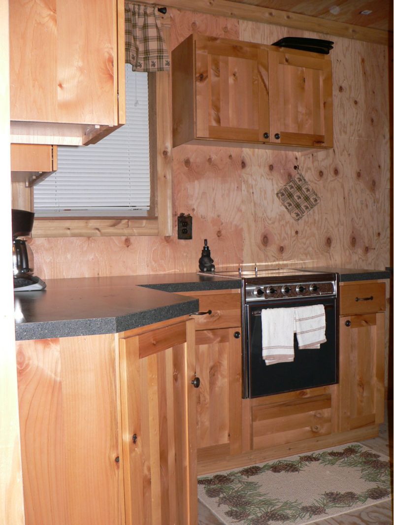

Kitchen
Kitchen
Kitchen
Kitchen
Kitchen
Kitchen
Dine counter
Dine counter

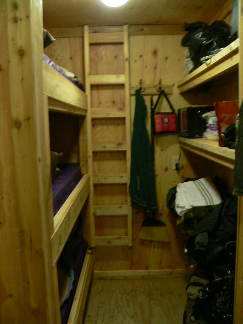

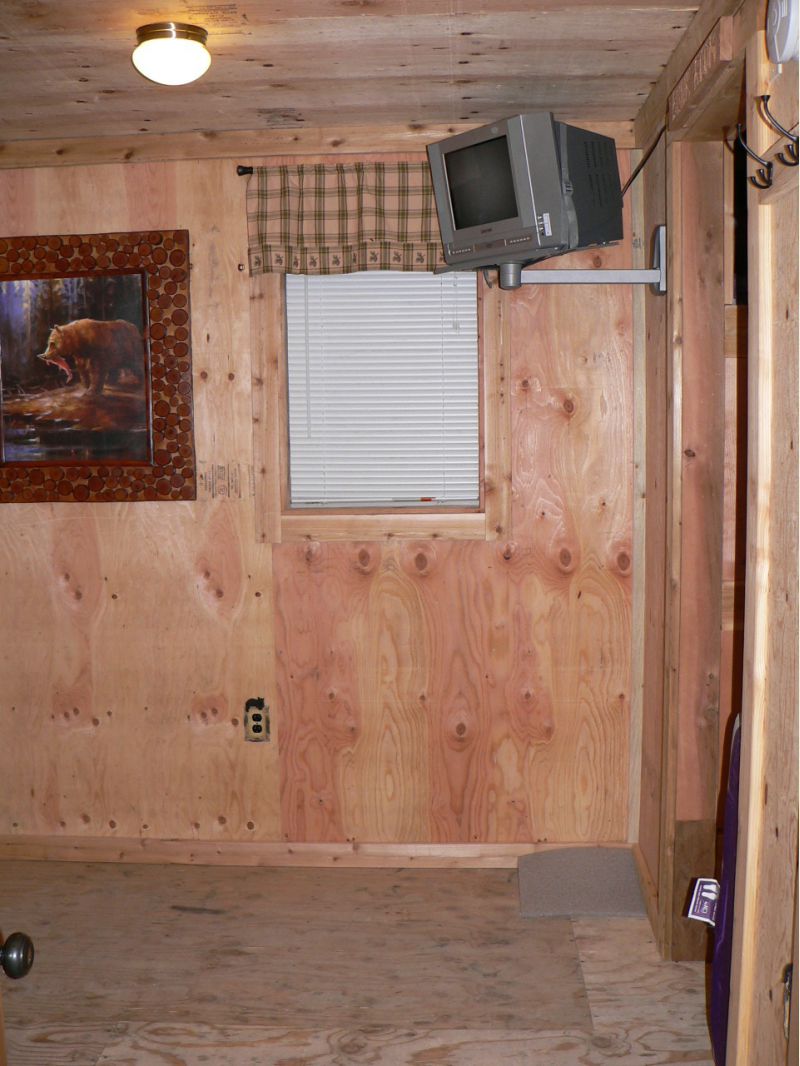

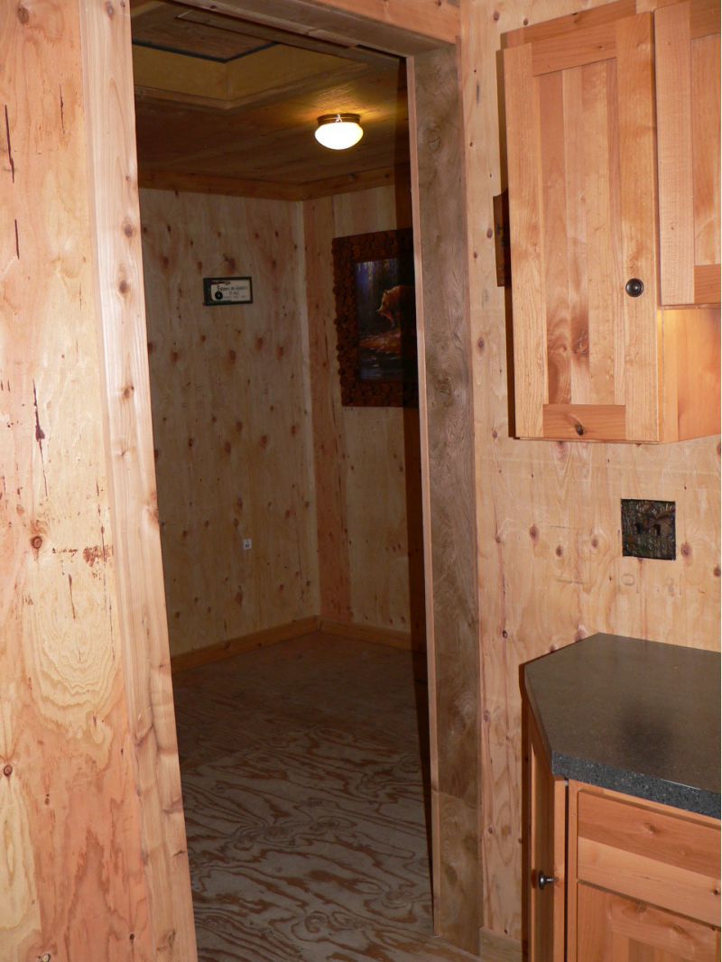

# Posted: 9 Jan 2012 09:09am
Few more pixs
Bunkroom (bunks left, ie 3, pantry shelves right

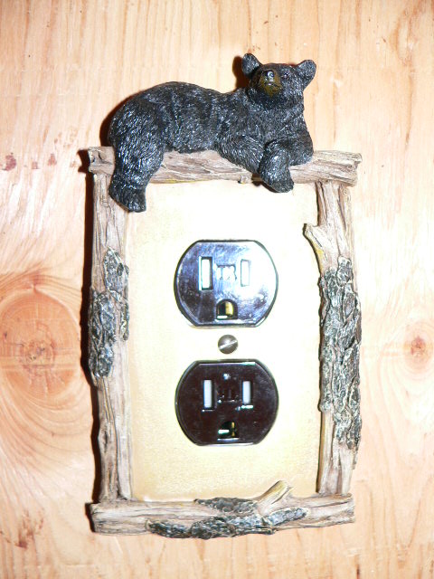

# Posted: 9 Jan 2012 09:11am
My outlet and switch covers varies, ie bears, moose, pine cone etc.
My Cabelas outlet and switch covers
