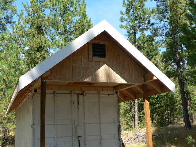

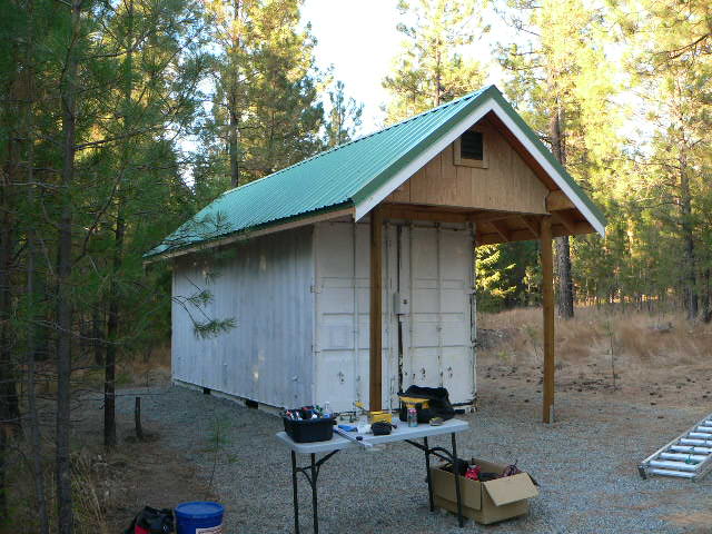

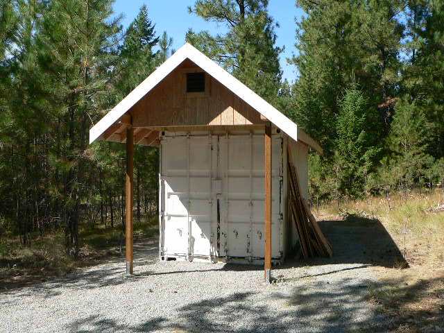

OK, aside from being stalked by a bear all day Tuesday, went well. My container roof is complete minus the paint job and the metal for the roof. I had pre made the rafter and bird blocks to make it go quicker, but was short quite a few rafters and bird blocks. Dont know where I screwed up, but I did. No big deal, brought all tools with me to the site.
Note the lack of OSB? Its wasnt by accident. And of course, H clips between all sheets. Really set me back, was $6 for a bag of 50
About $1200 into entire project. Could of been $1194 had I cheaped out on the H clips.
over built, but I am an HD guy. :D

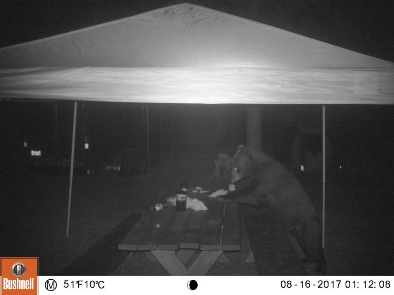

OK, I was hassled by a bear all day Tuesday...
All was fine till Tuesday morning. Woke up (actually was woken up by a crashing cooler, but didn't know it yet) and stepped out of the cabin to go to the bathroom and noticed my EZ up was moved and one leg bent over (shot) so I figured, wind, but none was forecast. Got dressed, put on my shoes, stepped off the porch and to my right, seen my cooler was tipped over, knew instantly, it was a bear. Found my trash (wasn't much) strewn over in the thick woods west of the cabin. Went and picked up all the ice, and food, put it all back in the cooler, nothing missing, but teeth marks in cooler. Then noticed bear footprints all over the picnic table from his dusty feet on my gravel.
OK, now I have my sidearm holstered, always bring it, but just left it in the cabin, now I am packing and would the entire rest of the time I am there. OK, used the same trash bag to pick up construction waste, ie caulking tubes, spray foam bits etc. Set it up by container. BBQ'd some Mariner dogs for lunch that day, decided to go inside to eat for safety.
Came back out, went to work on container roof and later on, can find my trash bag. Again, its now in the woods behind the container, strewn all over the place. No food, just construction waste.
I pick it all up, then secure it inside my enclosed trailer.
Now I go down to the well, about 250 feet away, just around the corner, being loud, neighbor guy is helping me. Just about done, hear a loud crash, we get in the Kawasaki Mule, rip up there in 20 seconds, cooler is drug away and tipped over, now 2 rib steaks are missing. As fast as we got up there, still unable to see him. But now have teeth holes in cooler.
At this time I call fish and wildlife. The bear was watching me all day, knew the area he was in. As long as I went inside or away, about 30 to 45 minutes, he came in to steal food so after talking to agent, he decided, he would bring the bear trap up. He told me they could issue me a special permit to hunt it, even though bear season didn't open till 2 more weeks. I wasn't interested and he also said you can defend yourself and recommend I pack a side arm. I was, he didn't like the 40 but it was all I had.

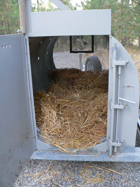

OK, I go inside around 8PM, ate dinner, window open, I had set up game camera, point it towards trap. In about 45 minutes, I hear the trap door slam shut. Its loud.
I shine my spotlight on it (creepy, its dark) but the trailer is not rocking and see no movement via the holes. I check, no bear, he hit the door and set it off. So I reloaded it per wardens instruction.

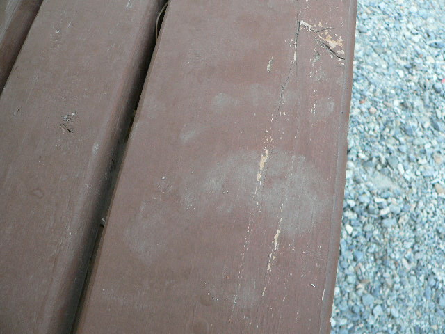

Checking my camera, the bear approached it, pushed the door with his nose/head and it probably came around and smacked him. He left and I thought he didnt come back. But he did, caught him on my game camera, he was snooping all over the place. He managed to puncture 2 of my 8 gallon water jugs (now shot at $25 each) plus destroying a leg on my EZ Up, but EZ Up sells legs, so I will replace it.

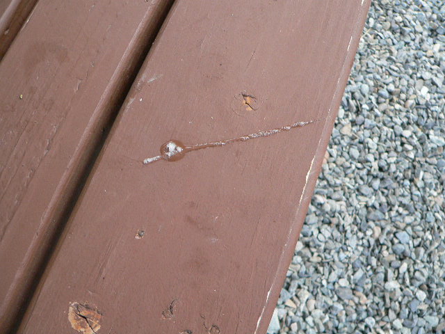

Even left fresh slobber

Bear pictures

few more bear pictures.

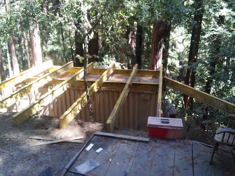

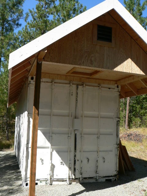

# Posted: 16 Sep 2017 09:19pm - Edited by: toyota_mdt_tech

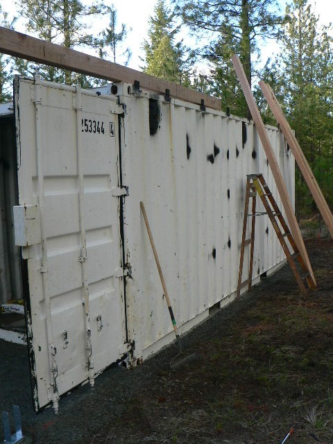

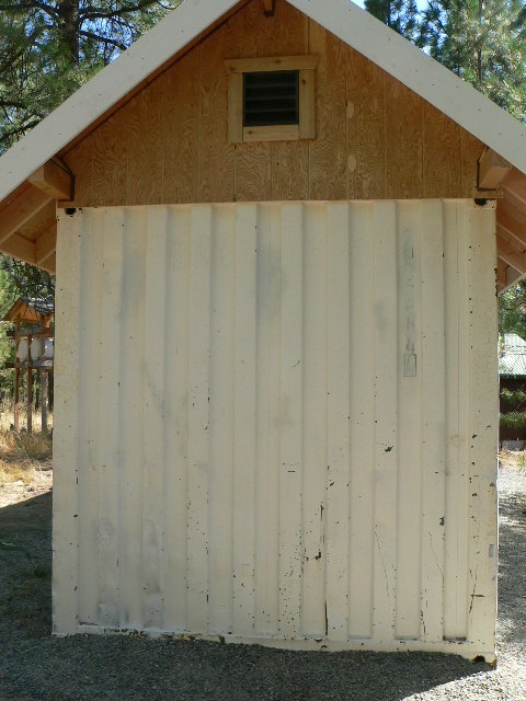

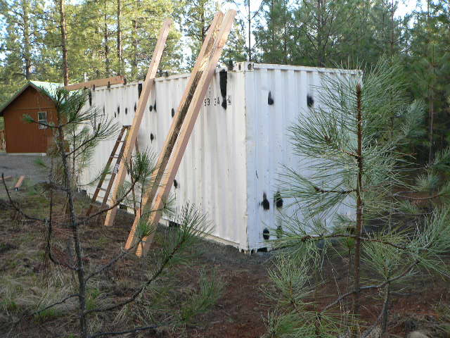

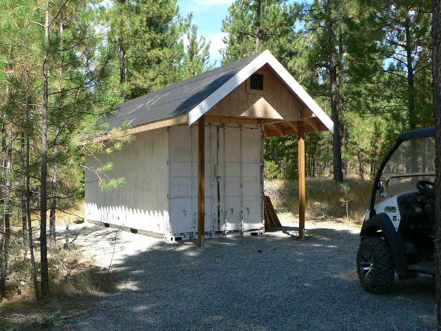

I welded on brackets along the roof edge, was angle iron, 1/4" thick, 2" X 2" angle, cut in 3" lengths. I put these in place about every 2 feet, made them so the end would be even with the container edge. Then I put the 4X6 across the edges, ran them long out the door end (notched for the corner supports, I did lag underside past the notch to give more strength back from the shallow notch) for the overhang. So when I pre built all my rafters at home, I knew it would be a 5/12 pitch and I measured the width from outside edge to outside edge of my 4X6, think of it as the top plate of my wall. I drilled holes in the angle iron and used timberlocks to secure it to the 4X6.

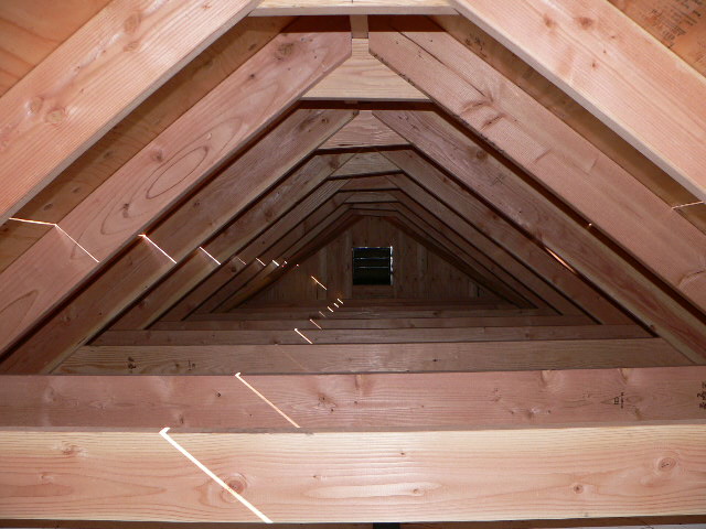

Went across the front and back with 4X4 to secure the gable wall too. I shimmed under it with plastic shims and locked shims in with pink foam. I ran all the T1-11 just to the bottom edge of the flat part above the top of the corrugated sides. It looks and fits perfect.
Closed in overhang and added an access door
Below is a few different pictures of it with the timbers lagged to the roof, this was done in spring to give you an idea. Black primer was paint over the welded areas. The spots on the side was holes I had welded up. The 4X6 timbers were 3 10 footers for each side. I just butted them up and toe lagged with timberlocks where they met. I trimmed the 4X6 edges with T1-11, so its not visible at all and blended the wooden roof perfectly with the metal. I used firefoam to fill the gaps to keep bugs out.

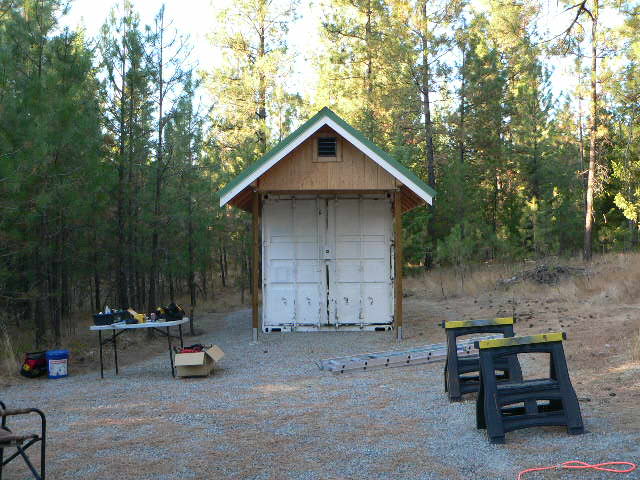

I just picked up all my metal for the roofing today, including foam enclosure strips (top and bottom, plus the eve, gable and ridge flashing today. I head over next Sat to install it. I will take plenty of pictures for the finished project, then not much more activity till the snow melts next spring. Then it should be new Kubota time. Going to be a fun visit.

Is that access to above in the front overhang?
# Posted: 17 Sep 2017 03:00pm
Quoting: ChuckDynasty
Yes and the rest of the inside of the roof. The access is full length, front to back.

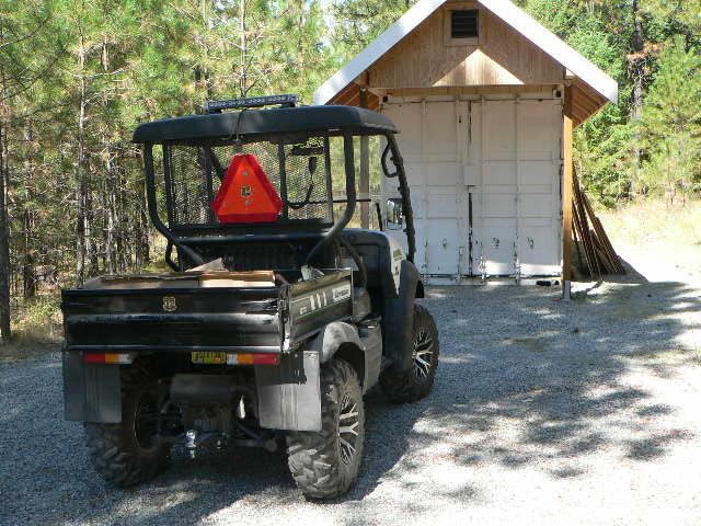

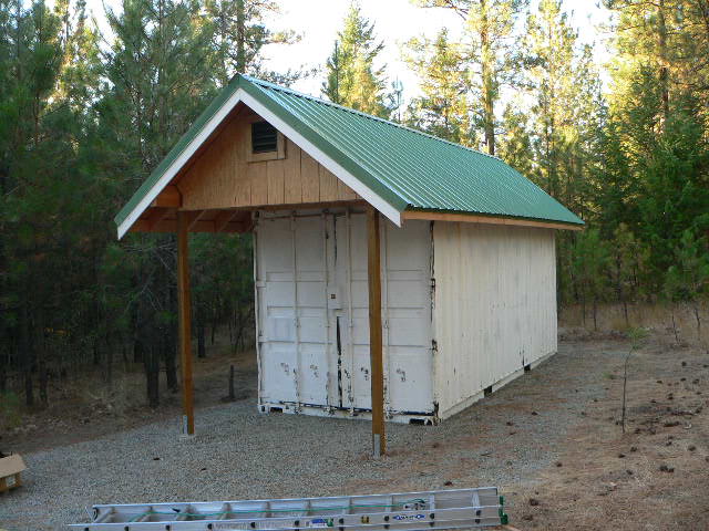

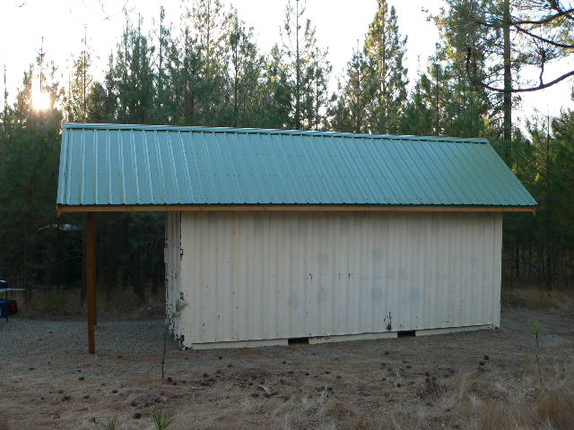

OK, final project complete for this year, we are done with projects till the spring thaw next. Metal roofing is all on. This was my first attempt at installing metal roofing. It went well. Took half day for one side, then half day for next side and a few hours more to button it up. Went over with a few good friends, all who went, this was their first visit. Forest Service Brown paint will have to wait till next year, or the spring thaw. All closed up for the winter now.

I love your attention to detail in everything you do! Nice work, it looks great!!
# Posted: 25 Sep 2017 09:39pm
Looks outstanding, as usual, like skoot said
