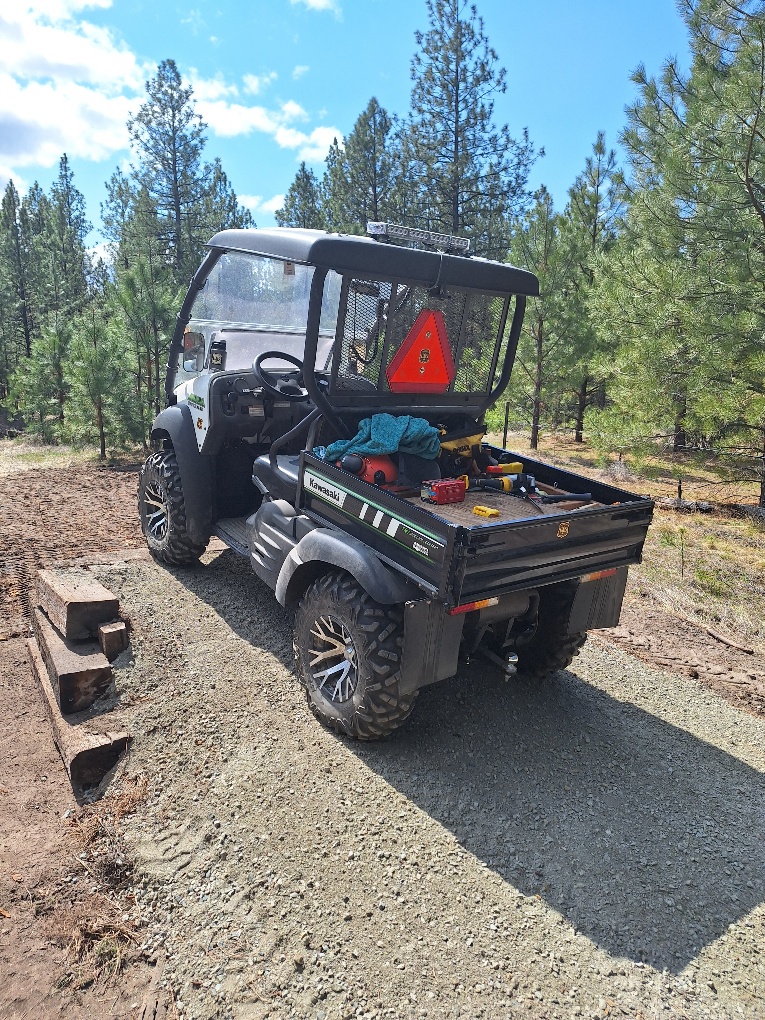

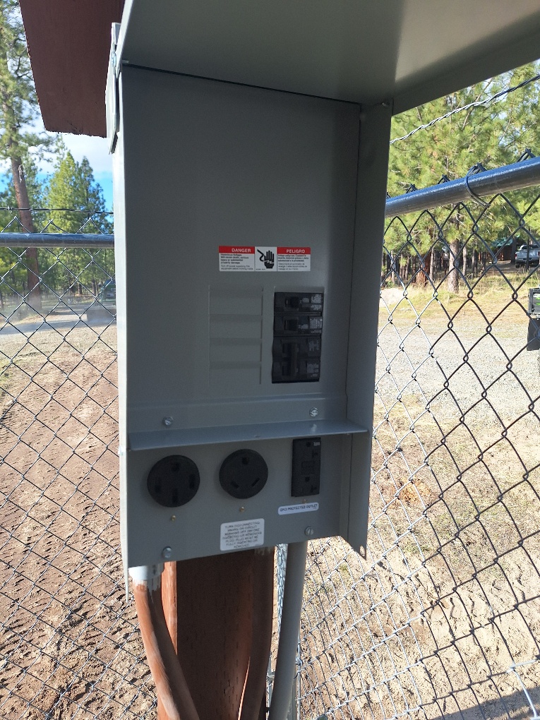

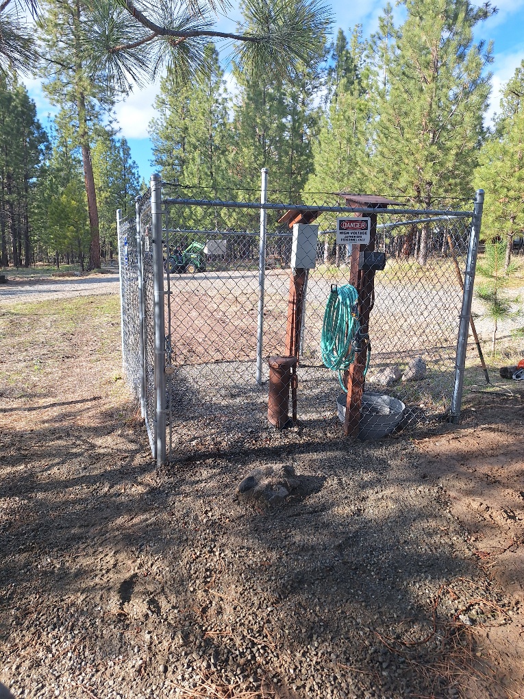

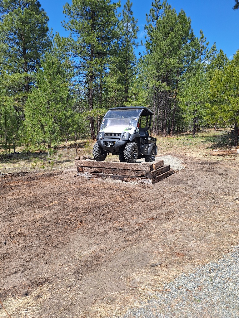

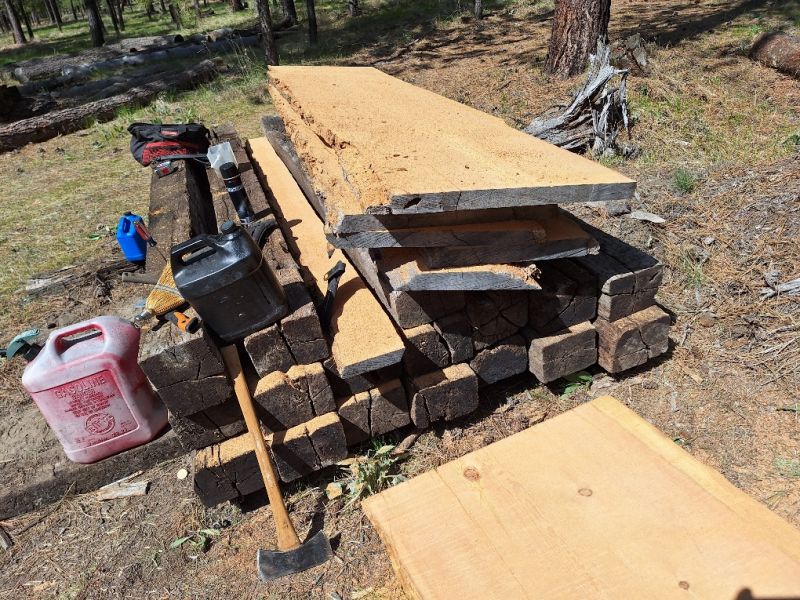

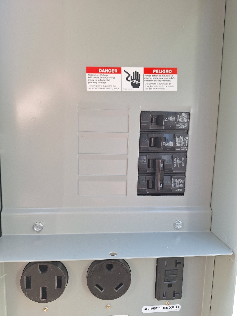

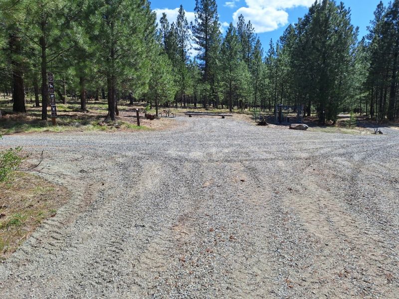

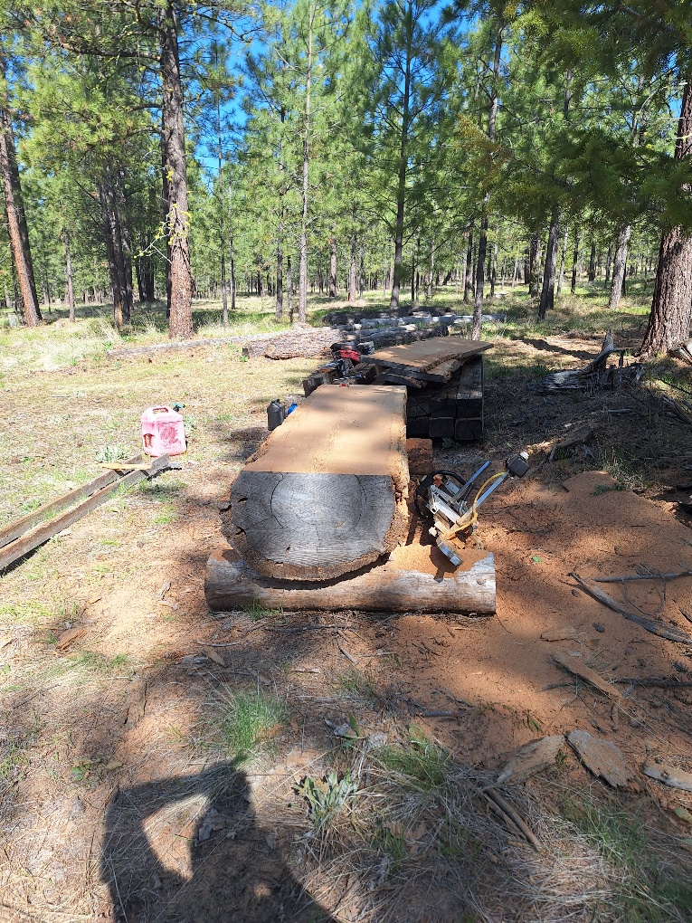

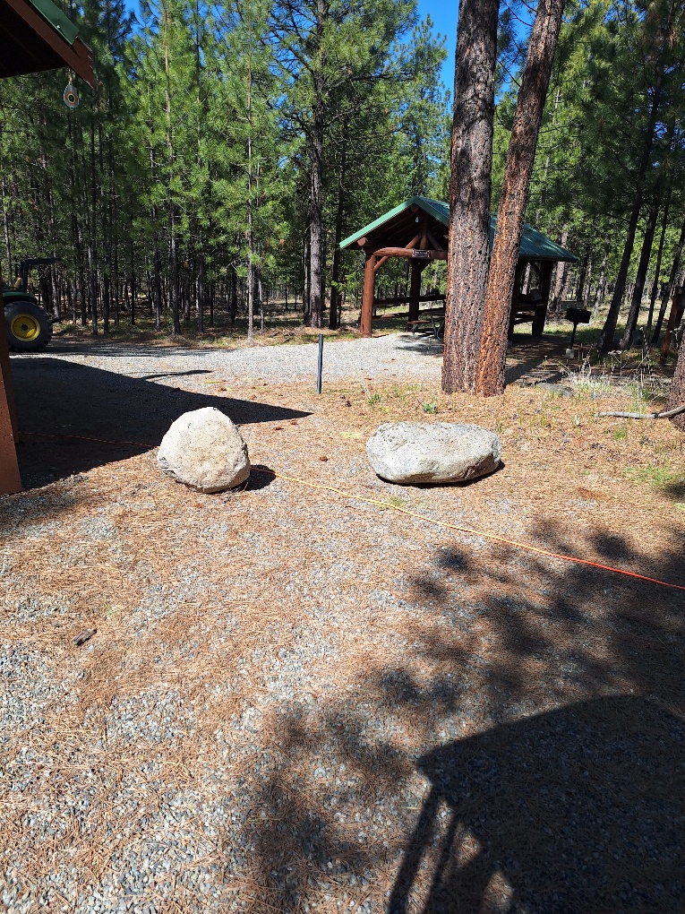

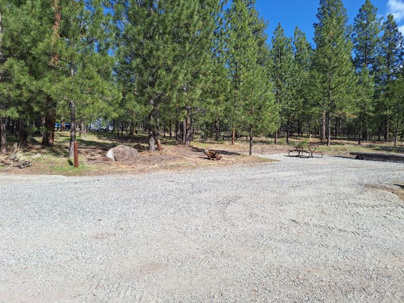

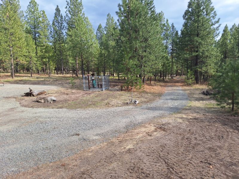

Man, beat, trenched in full 220V 50A service to a large RV site, then 30A RV hookup to another site, well guy lowered well pump down 20 feet deeper, leveled and groom or opened up 3 sites, added log bump stops, large rocks around cabin, built a loading dock, picked up forest floor for about 5 acres around cabin, slabbed an old log I found several years ago.secure window covers installed.

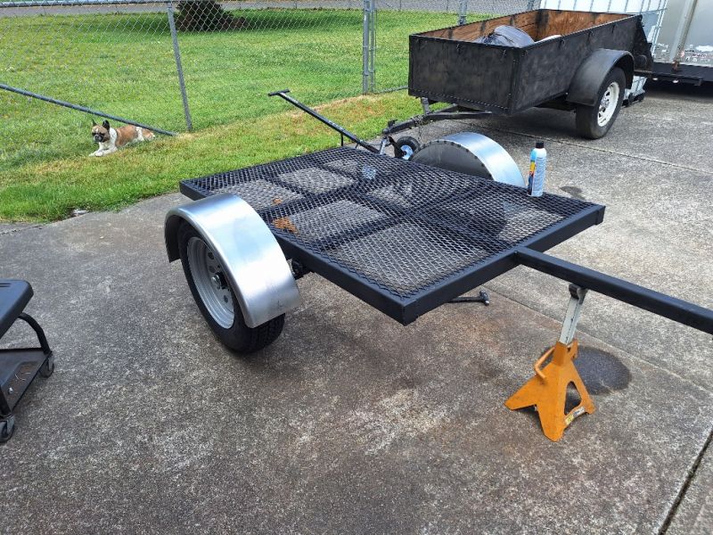

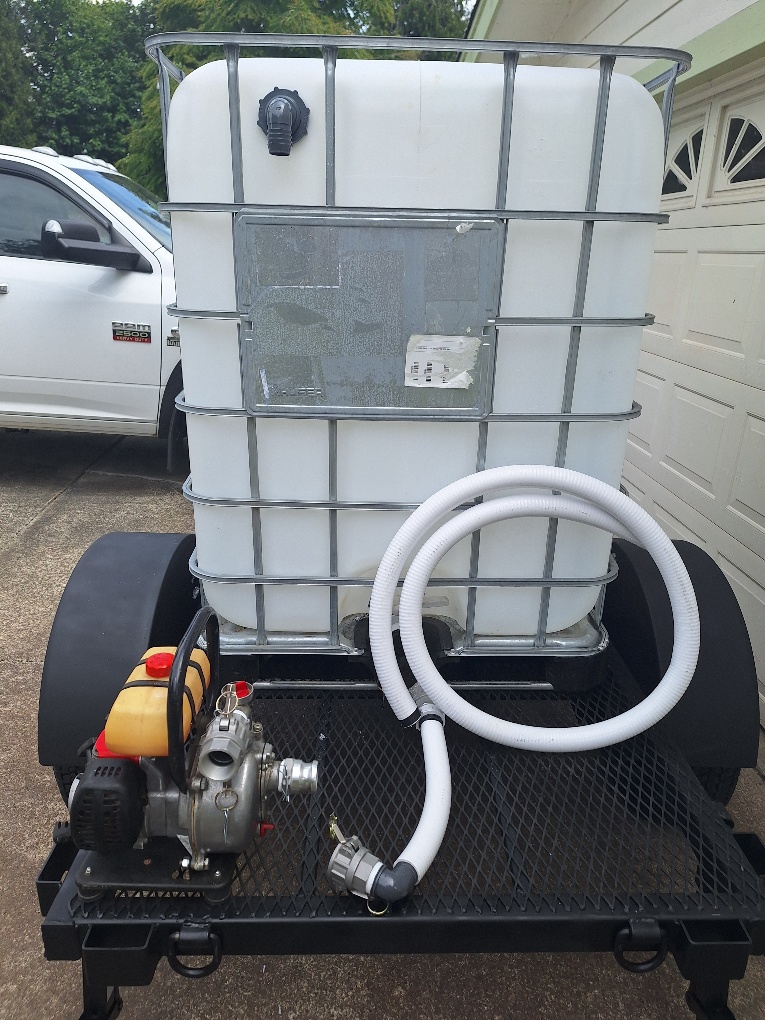

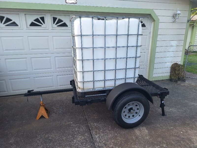

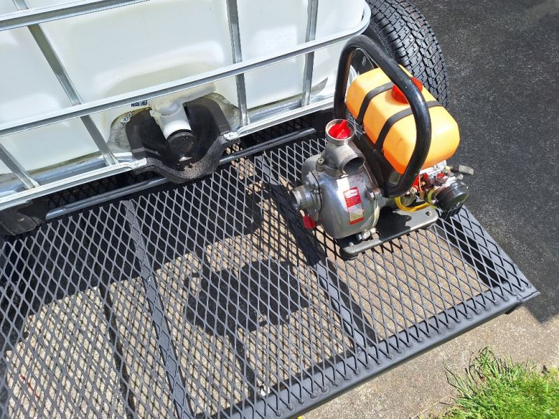

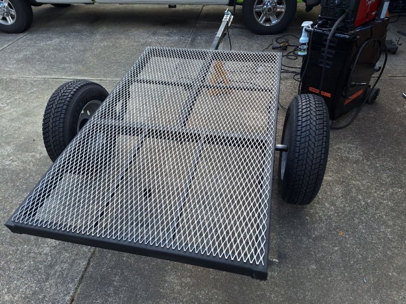

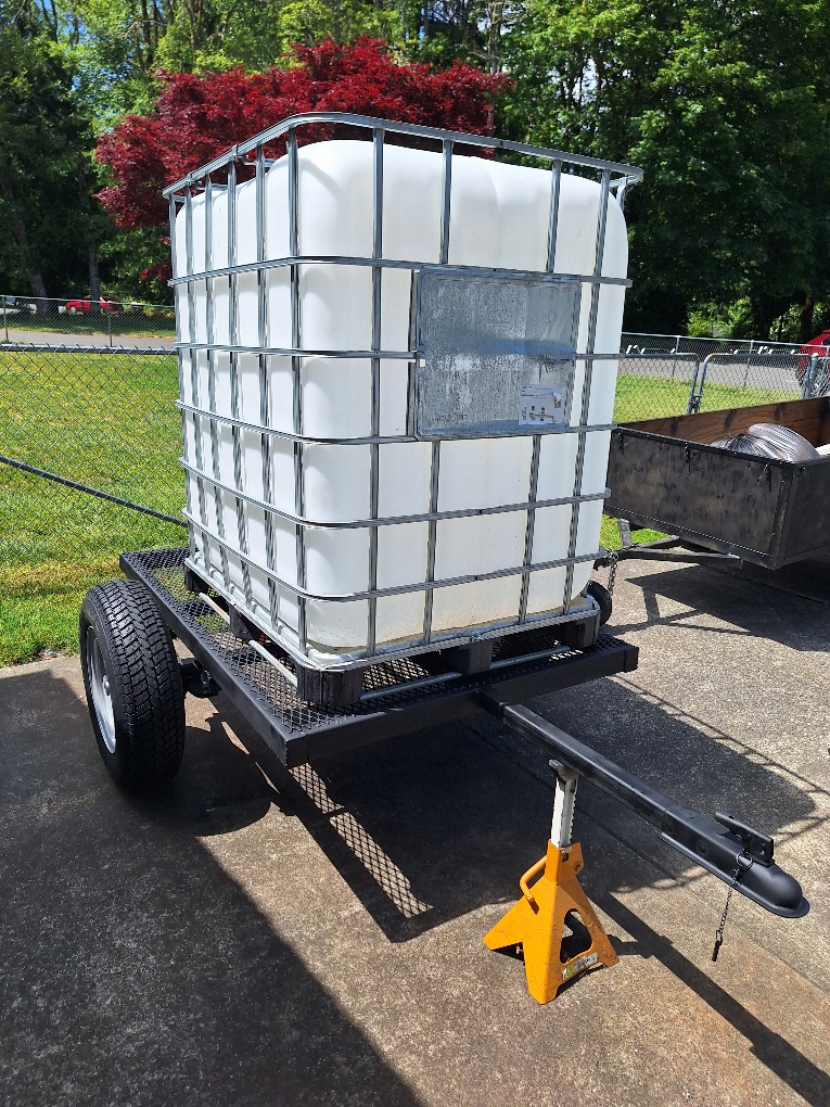

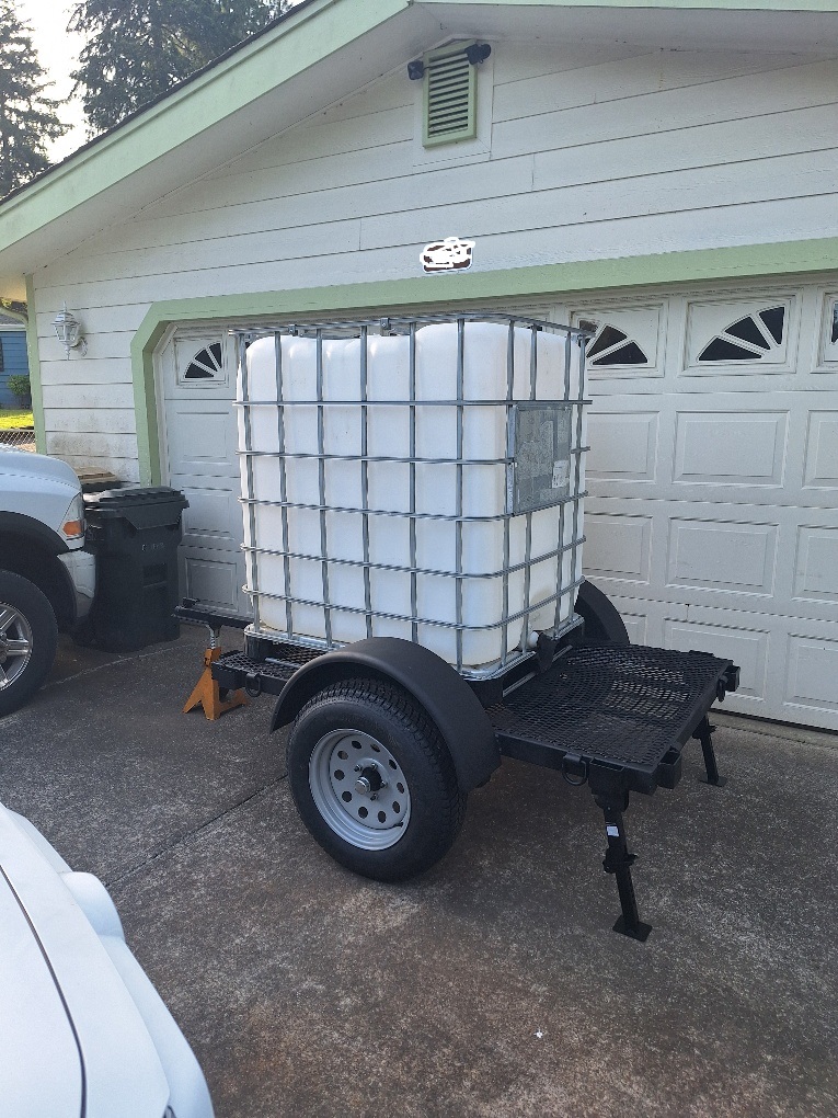

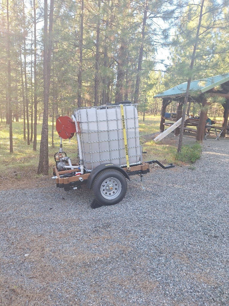

Started on my fire fighting trailer. I've been thinking about this for a long time, designing in my head, looking for water container.
Settled on an IBC tote at 275 gallons. This works well with my operational well at property. (power all underground) and the well pumps out water at a fast rate.

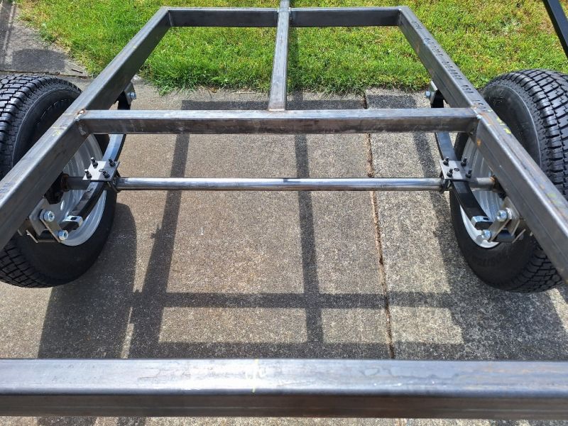

OK, started to collect axle parts, ie spindles, leaf perches, U bolts, hubs, bearings, leaf springs and shackles, rims with tires.
After all gear collected, bought metal, built the perimeter frame last week. Needed more metal to finish design and grabbed some expanded metal for decking.

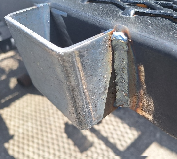

I have weld on stake pockets, I will build some wooden sideboards, weld on D rings to strap down the the tote.

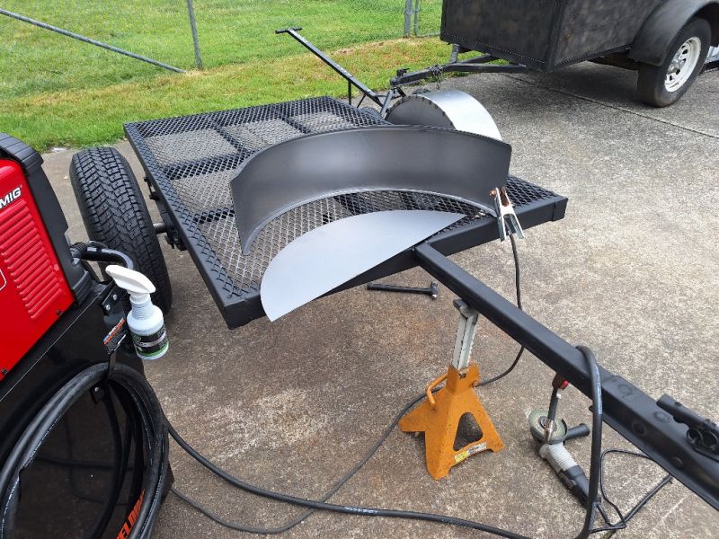

Weld on fenders next weekend, stake pockets and D rings, should be completed except now gathering plumbing parts.

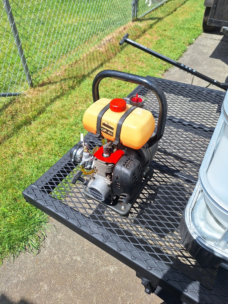

I have a pump already, sized for 1.5 inch forestry hose, I did have 100 foot 1" forestry hose with fire nozzle now.
Ran out of gas today, yeah, me too. But MIG welder ran out of shield gas. Well, almost out, watching gauge, quit while it was still operational.

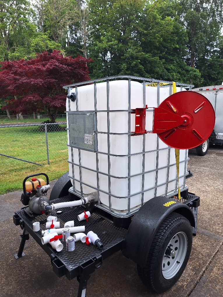

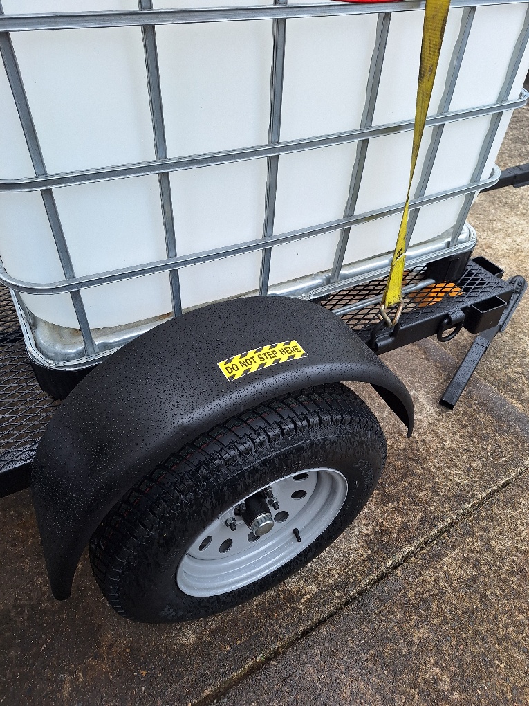

Stake pockets on all sides, large 12K D rings (I had them I know, overkill) and setting up pump and plumbing now. Bypass or return will be in top left of tank in rear, bung and elbow already installed. Finish plumbing tomorrow and tongue jack on its way.
I sure love my new Lincoln 210MP welder, butter smooth welding... Its a dream machine.
Had to refill shield gas, upgraded from my 80 cubic feet to 150 cubic feet.

Should be completed this weekend, will snap some final pictures and then load it into my enclosed trailer, tote will be strapped down into back of my truck.

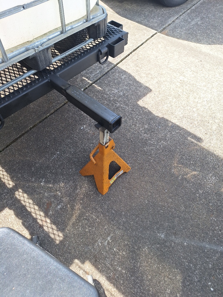

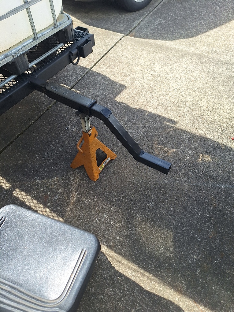

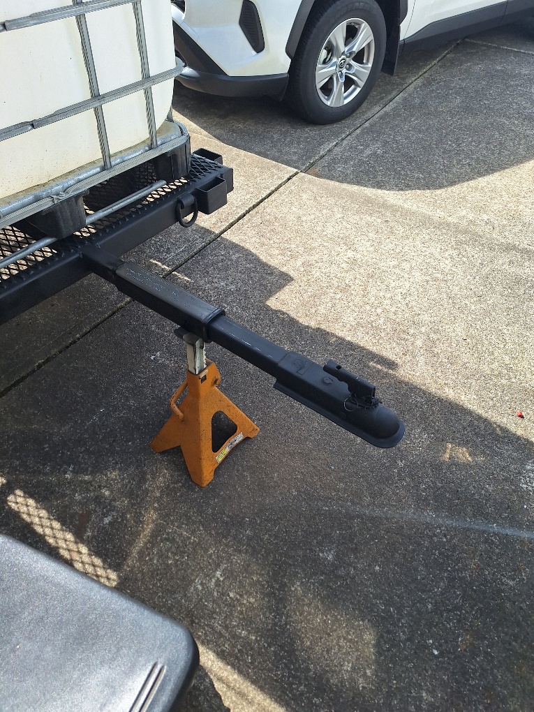

Tongue was high for my Kawasaki, so I cut the tongue off, installed a receiver hitch on the trailer, part I cut off now pins into receiver and if I tow it with my Mule, use special drop down hitch. I can remove them both to prevent theft too.

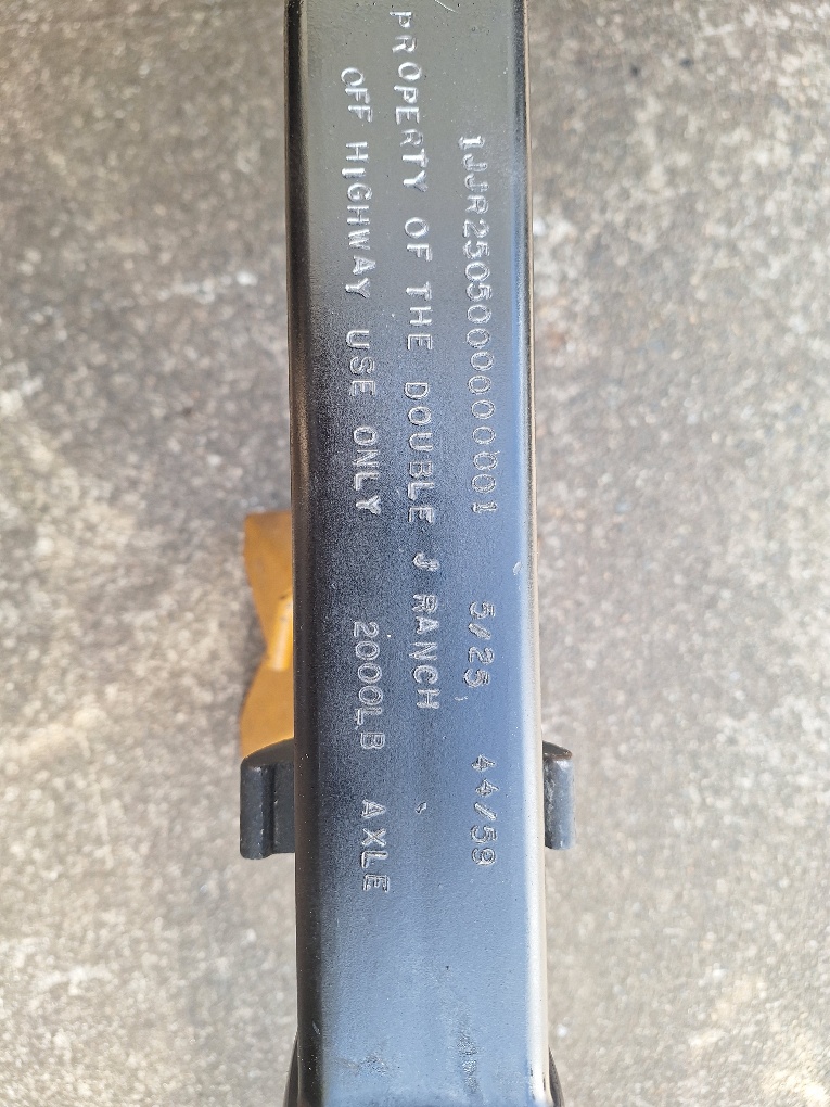

I gave it my own 17 digit serial number and also stamped "not for highway use"
# Posted: 31 May 2025 09:22pm

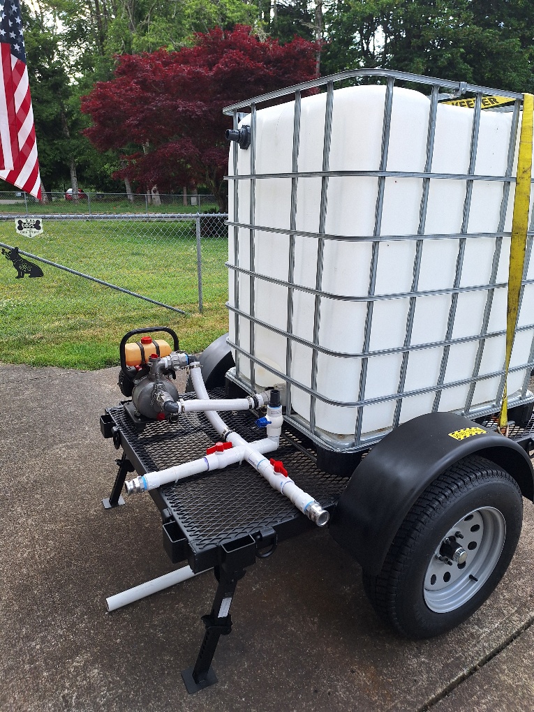

Well, all done except for a chunk of plumbing for bypass/return line. This is the one ran by the blue valve back to the top of the tank, this sill remain open when pump is running but not using fire hose and when using fire hose, this will almost be closed off, but throttled open a bit to create an internal leak to keep the pump cool when not spraying water. Lower hitch coupler is welded on. Tongue jack is bolted on. I mounted it to the frame vs toungue because I wanted a sidewinder and with the space required to rotate the crank, be a tight squeeze.

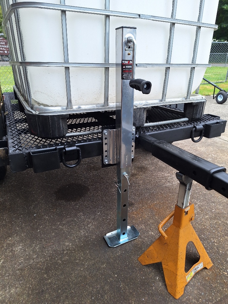

The tongue jack is a "drop foot" type, the foot by pulling the pin will drop to the ground and then I still have the full lifting distance of the jack, so works with my truck or the Kawasaki Mule. The back has 2 stabilizer legs that fold up, this will keep the trailer in place and from flipping.
The 2 house couplers on the back are with for a hose, other is a drain. I can make them either or. Depends of I need to peel the hose off to the side or out the back. Hose reel clips on to the tote framework.

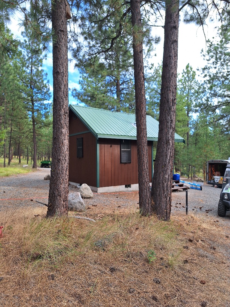

OK, back from final trip this year, all closed down for the harsh cold winter.

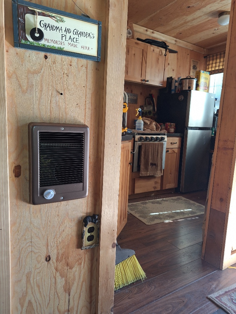

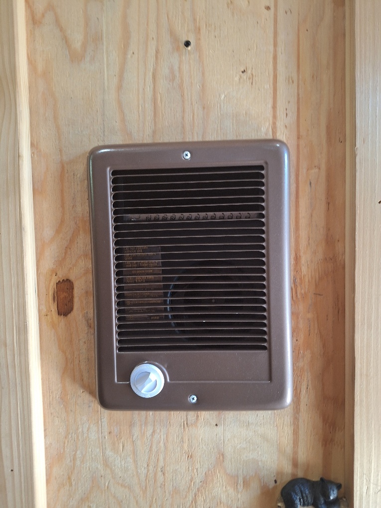

Did get my electric heater installed, this is a Cadet 220V, small unit, at the line voltage I have, ie 240VAC, consumes about 8.1 amps, so 14AWG (14-3 with ground) was used with a 15A double pole breaker.

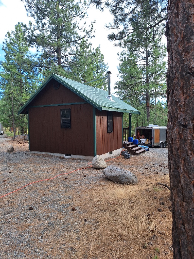

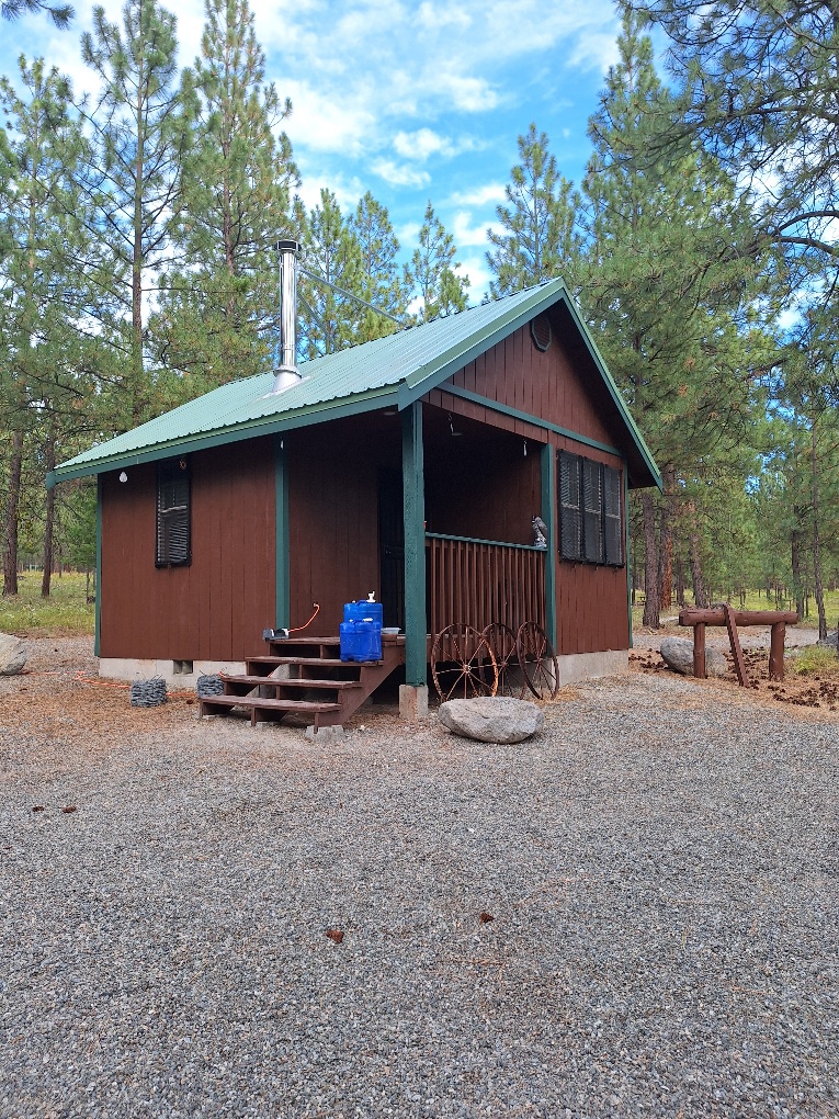

Works great. Also painted all the trim, first time I painted trim, it has been just body color. Wanted a dark green, went with my Behr stain tinted to M440-7 Rain-forest is the number and name of the color. I always use stain vs paint, the stain has sealer in it.

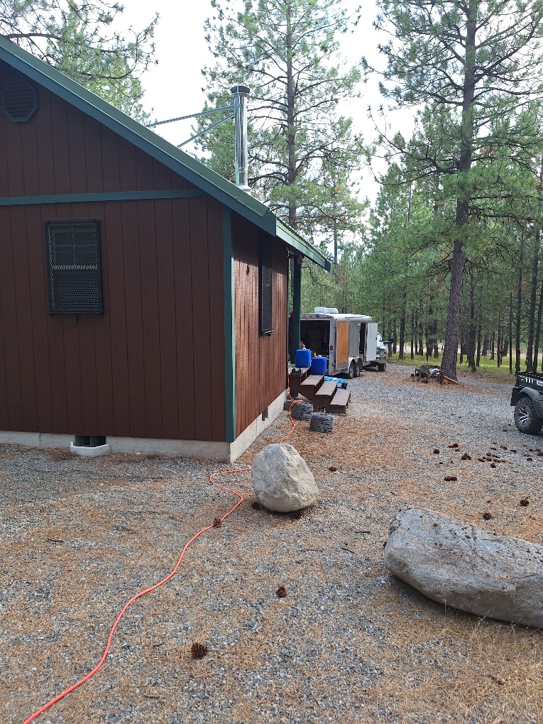

I did cut one chunk of cement board and painted it body color and slid in over the metal window covers, looks great, so got dimensions, will build the rest for the other 5 window, next trim install.

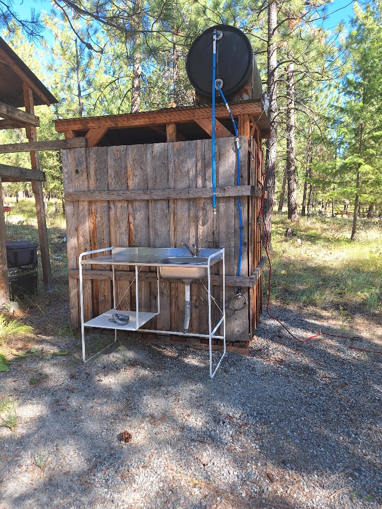

My son in law does deconstruction and hazardous waste and he ended up with a nice stainless wash basin, so plumbed it in using the shower water barrel.

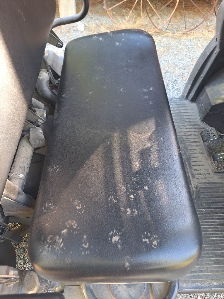

and the cat. I did find some smaller cat prints on the seat of my Kawasaki Mule

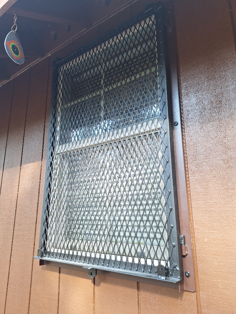

Window security screens look great.
# Posted: 17 Aug 2025 05:54pm
Quoting: DaveBell
Dave, I dont even take them off except one for the ingress/egress. Just leave them on. I have brackets to slide in a cement board, 2 seconds to remove, slide up, lift out at bottom, drop down, its out. Keep blowing embers off of glass in a firestorm. Worst of the fire season is over, winding down, no activity near me.

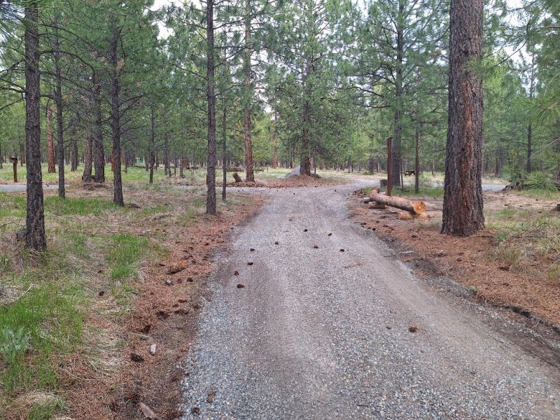

OK, just got back, trenched in over 400 feet of wire, a long run up to the last 2 remaining campsites, installed a 125A subpanel just before the Y in the turnaround loop. Had enough heave wire, sife 5 now gets the big 50A service and site 6 with a 30A service, so now all sites are wires, the largest sife have 50A + 20A and the other sites, including camp host site has 30A RV hookups.

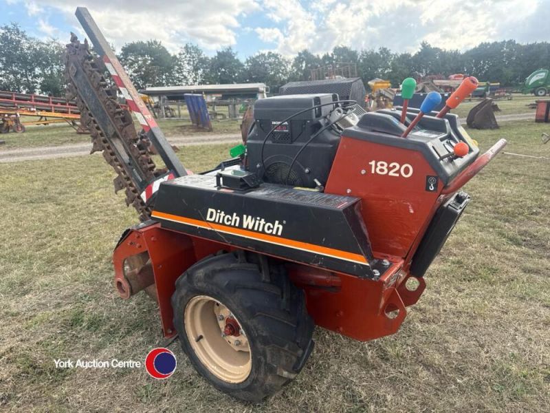

Pal has a 18HP ditch witch, that thing is a game changer, carves a nice narrow strip, then he had a neat attachment for his 3 pt to drag all dirt back into the ditch.

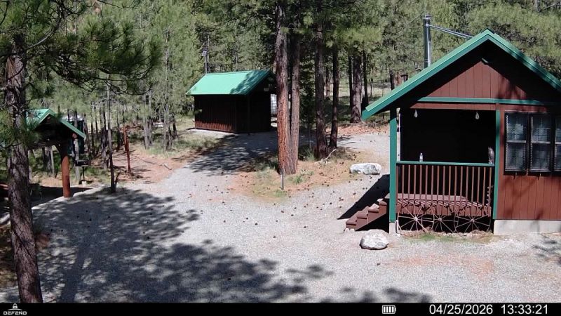

Added a great security camera, man is this thing slick. Defend360 by Tactacam. Has its own Lion battery back and solar panel, mounted camera high in a tree, solar panel on other side facing afternoon sun, camera battery is solid at 100% still. I instructed it to check in twice a day, morning and evening. Plus motion. I can do live views, control the view, pan, tilt, zoom. I have it set to where I can see cabin, container and shelter. Can rotate to watch power panel, some campsites, view a vehicle etc.

I'll post a picture of A ditch witch, not his, but identical.
Ditch Witch, not his, but identical
Looking down from upper area, trenched in middle of the road

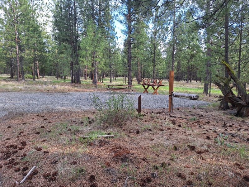

site 5 with 50A service and added pilot rock picnic table

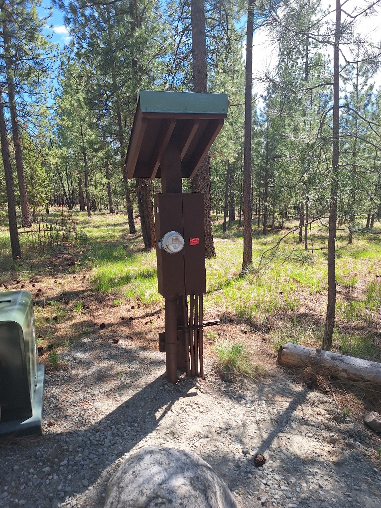

meter base where trench began

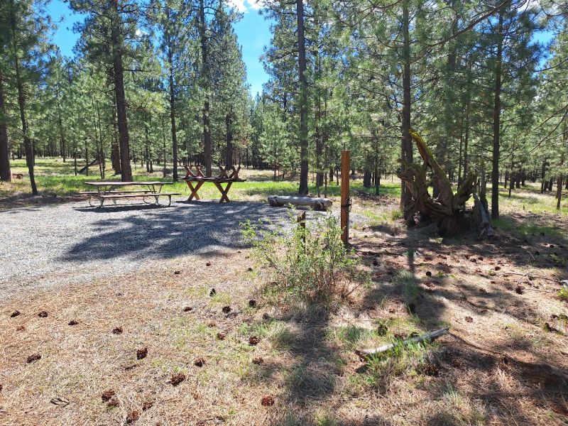

Site 5, notice panel not it, changed plans when we had enough heavy wire for 50A service, trim out l

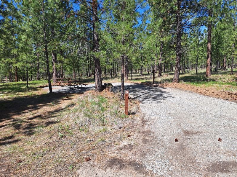

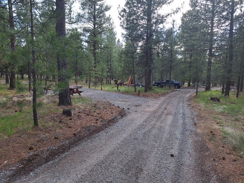

Looking up the road to loop turnaround, site 6 to left, 5 right

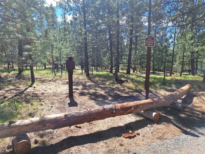

Site 6 best vies of camp and prettiest site and private

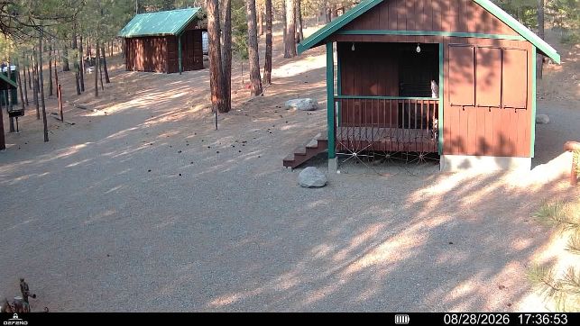

Here is a view from my camera.

I had built my cement board (hardi board tile underlayment) to fit into metal security window covers I had built.

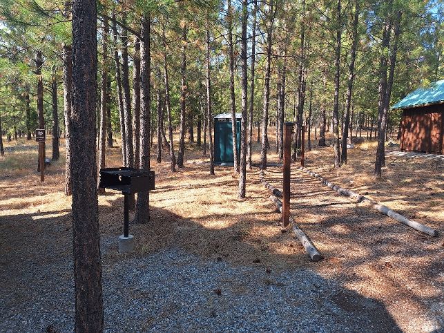

view of cleanup
view of cleanup
cleanedupandtrimmed.

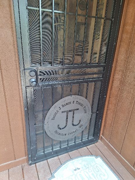

Medallion for door/screem
