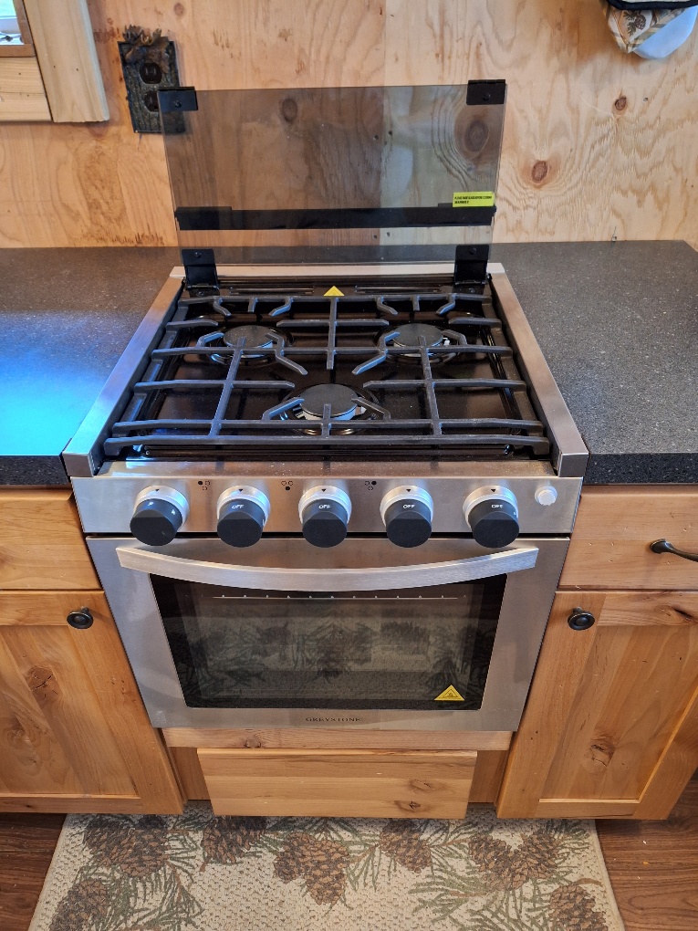

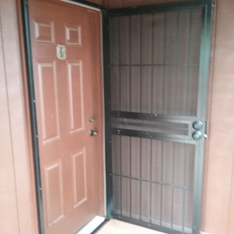

OK, installed security screen door, how nice, keep door open, no bugs, super HD unit.
Also installed brand new cooktop stove/oven, moved propane bottle to under porch vs under cabin. Much eaiser to use and also much safer, added a 2 stage regulator too.
New unit has all electric ignition via a magneto, a round knob on the front that rotates and clicks and sparks the oven and each burner. So which one is on, it lights first time. Requires no battery, but does have an illuminated front panel and button to turn it on if you want one.
I did, by mistake, order a shorter oven, 17" vs the 21" I needed. So my custom cabinets where designed for the taller oven, so ordered another new gas range.
I will not show a picture of it until its final. I did make a nice panel to fill in the void for now, next trip, new range goes in.
Screen door, we can show pictures of that.

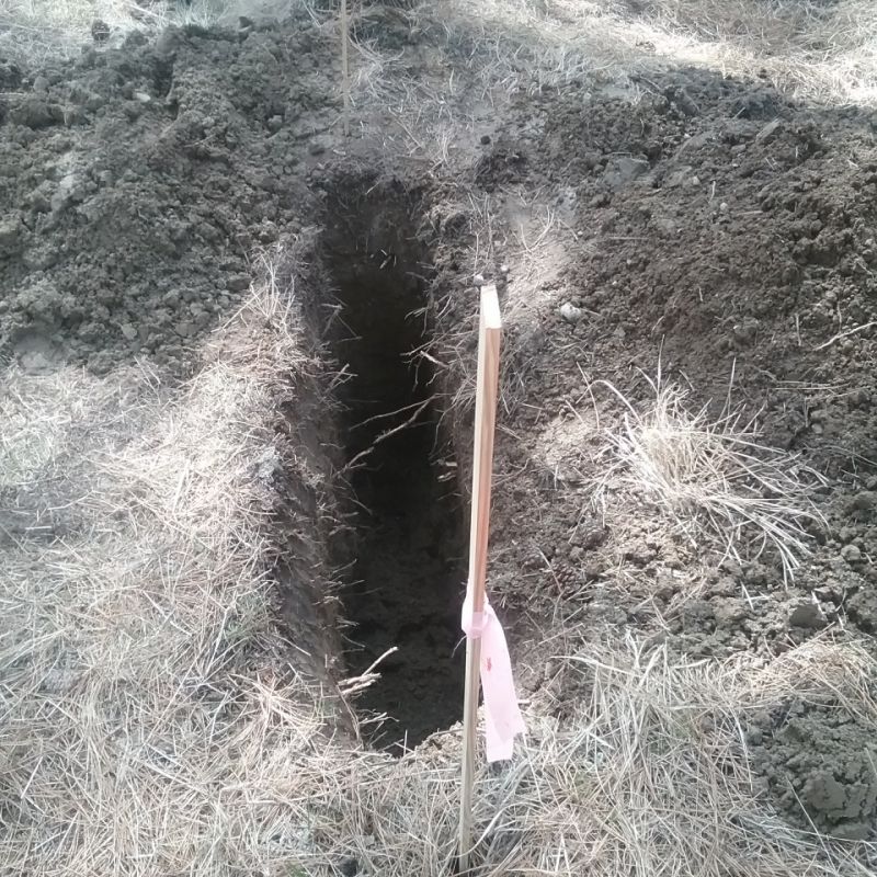

Located a spot for transformer and panel and meter base will be about 5 feet from that. I did have to dig a trench 36" deep between the 2 points, I will also need to have a L&I inspected panel all set up on a 6X6 treated post, several ground rods and L&I signs off, then when power comes in, they hook up, install meter and done and I have power.
It will be 72 feet from cabin, 175 feet to campsite 1 and solar well. And about 110 feet to campsite #3

trench between TX and meter

Security screen photos

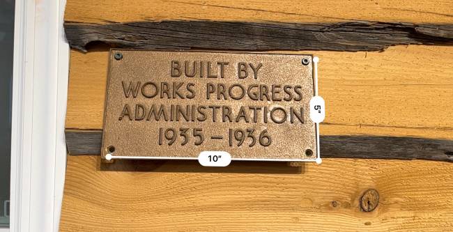

And a little gem I picked up from ebay in my ever lasting search for USFS stuff, USNPS and now CCC stuff.

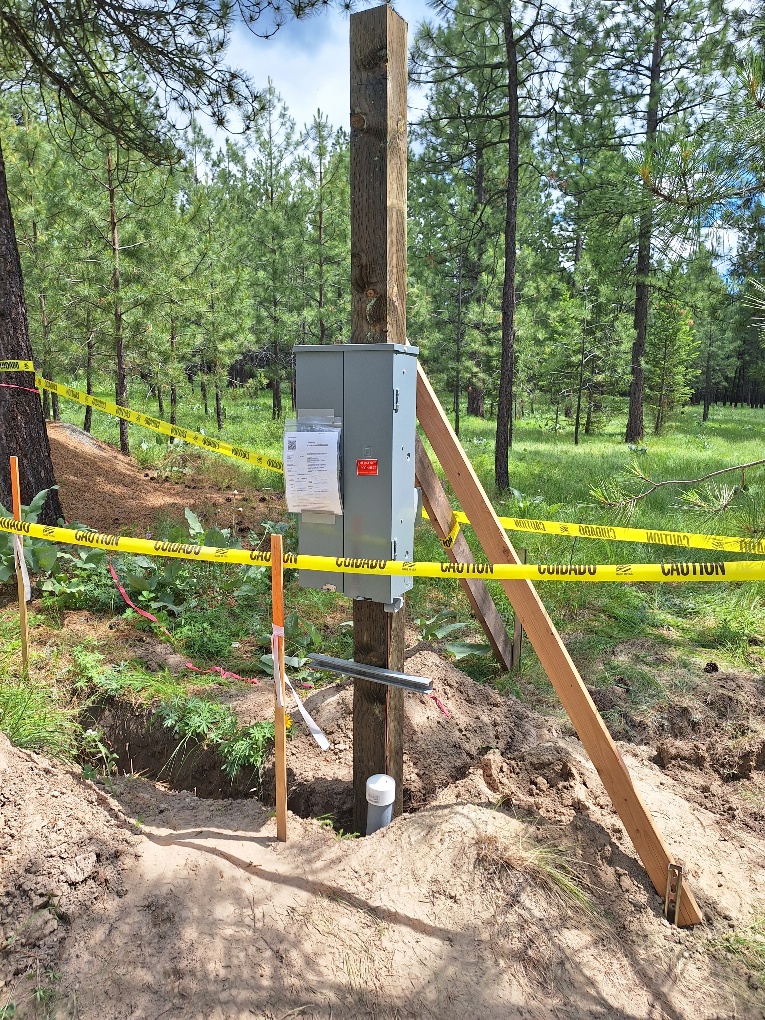

OK, back from trip, installed meter base, pounded in 2 ground rods, 8 foot copper clad 5/8" used #4 solid copper wire and hooked to both using direct burial gear, installed them 6 feet apart.
I pounded them in with an industrial jackhammer i have with a ground rod bit, make short work of that task.
Used 6X6 post, treated, trenched down 3 feet for wire to transformer location. Called in for my inspection Sunday, should get it no later than Wednesday.
I did add a 20A GFCI outdoor duplex outlet on the panel post

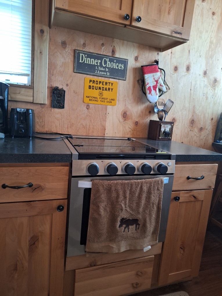

OK, new cooktop is in and a nice sign added to wall behind cooktop to keep in step with my USFS theme.

That looks like a solid power pole setup you have. I like that you put a 120v outlet on that pole, they always seam to be used.

Brett, the post is a 6X6, min required by the power company. Its a 10 footer, so some will be trimemd off but not before I figure out a little roof system, shed, gable or hip, not sure yet. I would of done 8 foot, but the center of the meter needed to be 36 to 48 inches and I wanted it up as high as allowed, so have to get the 10 footer.
I only added the outlet because I thought it was required, but as it turns out, it wasn't. But it was signed off. I will add another. I also added "strut bar" across the post about 10 inches below panel to secure the conduit runs exiting bottom and then underground to various locations.
I'll trim off the surplus at the ends later.
