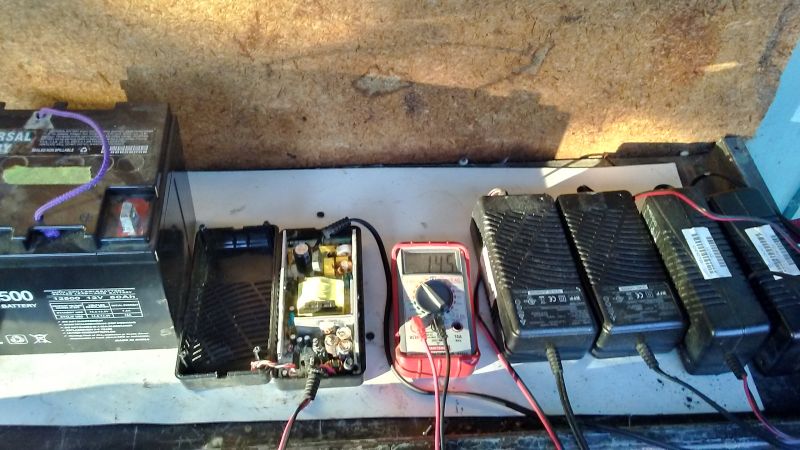

Back to city life for a day (my cabin is only a half hour away in case I haven't mentioned it), much needed to rest from my never ending carport project. While I was looking at 14.6 chargers online I noticed two things: One they look like some 12v chargers I already have and two, they mention having a potentiometer inside to adjust voltage. Hmmm.
I take auto shop at the local jr. college, they have a class in electric cars and auto electrics (I'm in auto body) and several months ago I noticed a bunch of these batteries and chargers sitting there that had been donated. The power strip they were plugged into had been unplugged. Knowing my old batteries were dying I asked about them. They said take them. Brought them home 2-3 of the batteries hold a charge, others dead. But there are all these chargers..
Anyway when I got home last night I pulled one apart, sure enough there is an adjustable potentiometer, and with a twist it goes right up to 14.6v on the DVM.
So I am about to try one on the Valence but thought I'd check in first. These chargers have a built in cutoff, don't know how changing the output affects that but I will keep a close eye on it. They are 7 amps each, I could conceivable hook up a couple.

Looks like my tweaked charger worked, I just went out there and it was at 14.6. I took it off and it has gone down to 13.4. The spec sheet says 'float voltage' is supposed to be 13.8, does that mean off the charger? Also don't know how long it's supposed to be charging at 14.6.

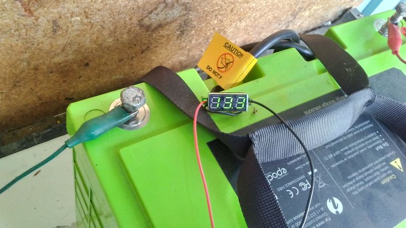

There is no way to gauge SOC on an LFP other than voltage. Because there is not a huge working range use the best meter you can afford. Some of the cheap chinese ones are actually pretty good. If looking for a new meter consider a clamp meter if you don't have one. Sears Craftsman also has one they often have on sale for less than $40 that I like. Clamp meters allow current measurement without the need to disconnect wires. Make sure what you select works on DC current. Many less expensive ones do not. They might read DC volts but not current.
Watch the green light and the resting voltage to get an idea of when the led changes color. That will be good to know.
Overnight, now it measured 13.4, or 3.35 per cell
3.35 per cell = about 90% charge/capacity.
# Posted: 19 Oct 2019 04:06pm - Edited by: paulz
Thanks ICC. I use these dime a dozen little LED meters on my trucks, tractors, motorcycles to monitor batteries. Seem to be fairly accurate enough for that. As you can see, (well maybe not from the flash) the Valence has gone down to 13.3.

I find it really tough to use voltage as a indicator of charge level on Lithium batteries, compared to using that on Lead Acid.
Lithium tends to hold voltage pretty consistently until it drops like a rock. Kind of like when using your cordless drill. In the old days they would start to slow down as the battery got weak, now they work just great until they don't work at all.
You need to adjust your thinking from the old lead acid ways as a cheap volt meter won't provide you the detail you need to make accurate state of charge with lithium. The good news is you can discharge them much further than you ever could with lead.

Voltage is the only quick method of measuring the SOC of a lithium battery, so the accuracy of the meter is very important. Accuracy with lithium batteries is more important than with lead acid batteries where the voltage variance is greater from full to empty. Better batteries also benefit from better tools.
# Posted: 21 Oct 2019 03:16pm - Edited by: ICC
I have seen some of the little voltmeters advertised as plus/minus 1% accuracy. That means that a reading of 13 volts could be anywhere from 12.87 to 13.13 volts. Round that off to one decimal place and we have probably 12.9 to 13.1. Quite a difference for a lithium battery but not as much a diff for old lead-acid.
I have several of these cheapy meters scattered about. I have checked them against my Fluke meter and they seem more or less correct but some vary by a tenth if a volt. One was off more and I tossed it.
I have owned my Fluke for years It is rated for plus/minus 0.05%. Much better than these little things. But its replacement costs more than your battery. For a lot of stuff it does not matter all that much.

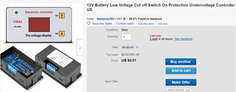

I ordered a programmable low voltage cutoff switch. I've been nervous that the voltage would drop off quickly into the danger zone during the night. Should fix that.
