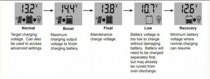

I'd still like to feel confident hooking up mine to my 100w HF solar controller instead of dragging it home to charge. The programmable settings are still in the default positions as shown for lead batteries. I'm guessing it would not hurt the Valence but may not charge 100%, which I don't seem to need anyway.
But if anyone has better parameters I'm all ears.
# Posted: 27 Feb 2020 11:36am
can't read you diagram Paul as it won't blow up, but lithium batteries don't like or need a float charge. Lead does, so if you can take that out of the charging profile that would be best. If you can program your controller search for the charging profile for your batteries and program it to match.
I wouldn't use a lead program on a lithium battery
# Posted: 27 Feb 2020 05:20pm
Yeah I did that from my phone, here is a better photo. Dang, I left Valence on the solar charger when I left today but from the limited sun I get and only 100w panel hopefully it won't hurt it. I'll remove that float next time. Thanks

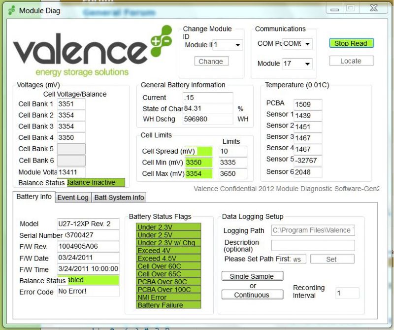

# Posted: 28 Feb 2020 11:02pm
Update... I matched up the voltages on the two U27 batteries separately and then paralleled them together. They are now tethered together and everything looks good especially the two batteries cell voltages. I apparently was overcharging with the Progressive Dynamics camper lithium charger. It hit them at 14.6 and that seems a bit high at least for my cells.. If I could somehow control the charge to 13.5 max I would be golden as they would hardly vary in balanced charging. I guess I got keepers

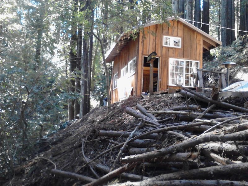

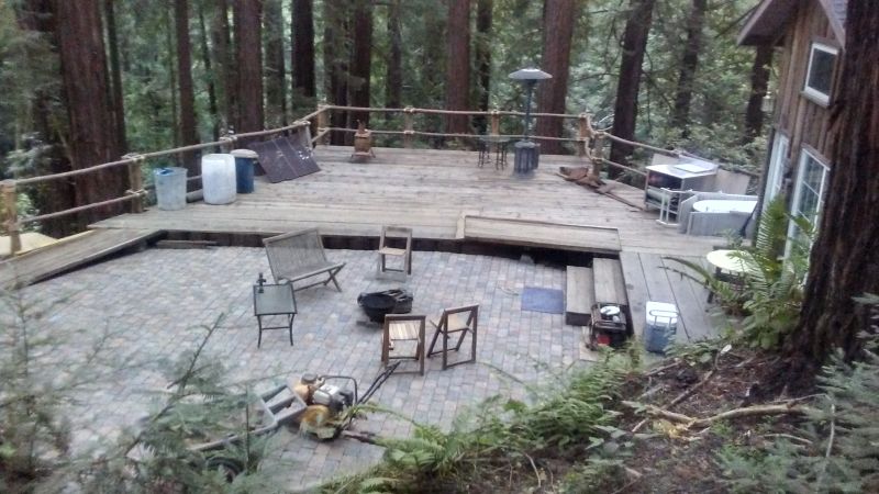

My solar capability is very marginal. They sit out on the deck, as in this photo. The trees surround my cabin 360 degrees and are 150' or so tall. Anytime they are in the sun it's only for a brief period. Plus I'm on a north slope. So I haven't invested much in solar. Believe me, if I could figure out a way I would, I have been lugging batteries around for so long my arms are a couple inches longer.

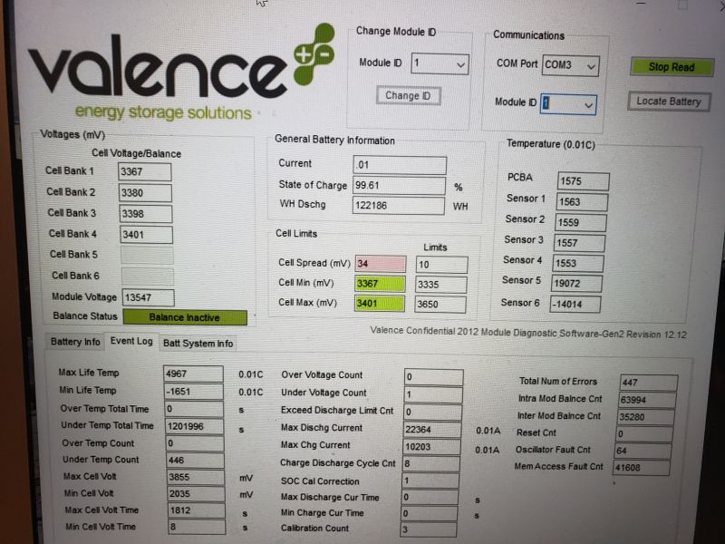

# Posted: 8 Mar 2020 02:27pm

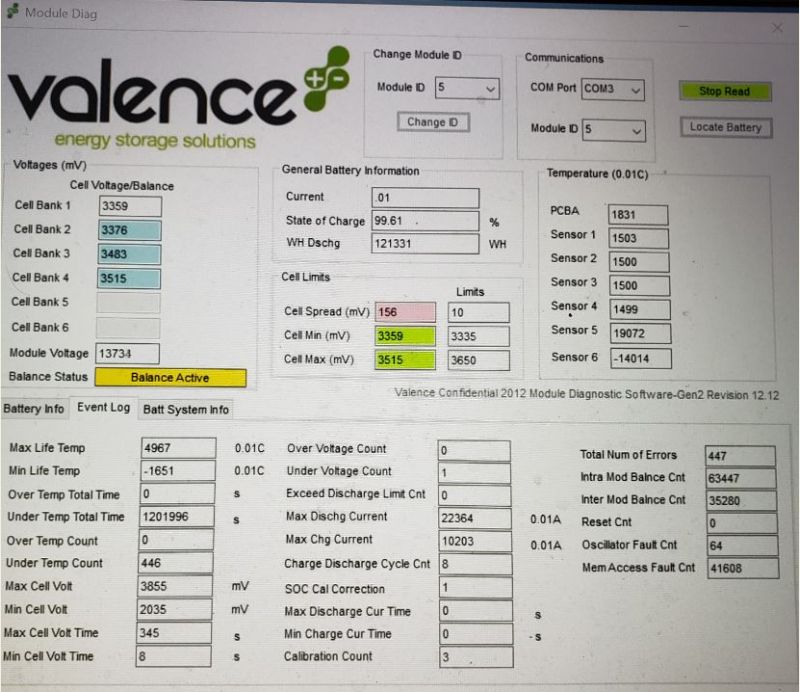

Data update information and question(s).
I paralleled my two U27's together in my camper and got a couple cycles through them. Surprisingly I have noticed the SOC has aligned together on both batteries at 99.61.
I confirmed that when I charge at 14.6 with the on board camper Progressive Dynamics converter LIfepo4 charger it is too much voltage as it overshoots by approximately 400mv consequently commencing a long rebalance down to the weak link cell bank voltage in bank #1. Which is the case for both batteries (cell bank #1). I ordered a 10A charger (from Ali) that will be here one day maybe which allows up to a 10% variance in charge amount. Hopefully I can throttle it down to low 14 volts area? Ill advise. I got the 10 amp charger so I can use it with my little 2000 gen out in the field.
All that said I am wondering if this is the "Valence" normal for charging numbers to end up with around 13500 volts (see pic) and around 3.35 per cell. Someone else mentioned 3.34 ish is approximately 90%. Being 90% is better for batt life so I guess this could be a good thing? These batteries have an unfortunate history in the minimal voltages log of 2035MV per cell (see pic). So way below 10 volt minimal drain recommended. But seemingly ok...? I guess I am just looking for confirmation these are good numbers? I paid a grip for these batteries and have a week left to where I can return them if they seem damaged, which I really still don't know. My first camping trip test with these batteries is next weekend. Ill advise how they hold up.
So back to Paulz question of being at 13.4 after a good drain. I think you should be ok. Plug in the software and see if you beat my minimum cell voltage of 2035mv (if that data is even accurate?). If you didn't and you have what you started with (3.4) you should be golden again. My old rc LIPO batteries would do weird stuff after over drains but I think this chemistry can take a lot more of a beating. Just try not to beat it any more

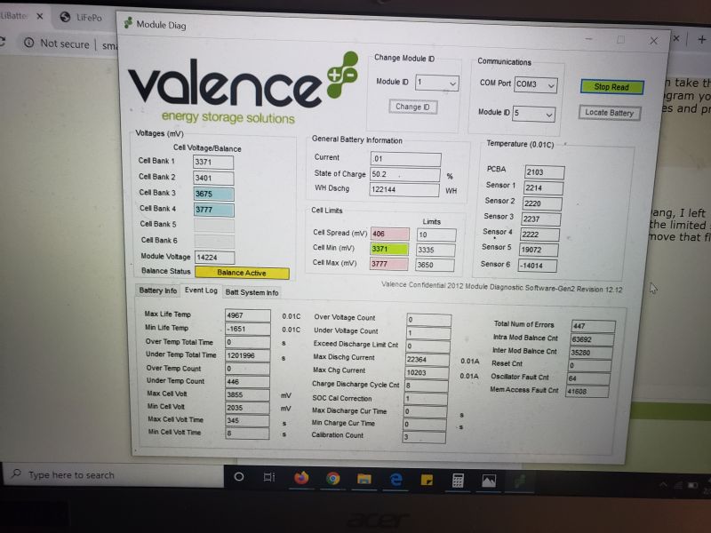

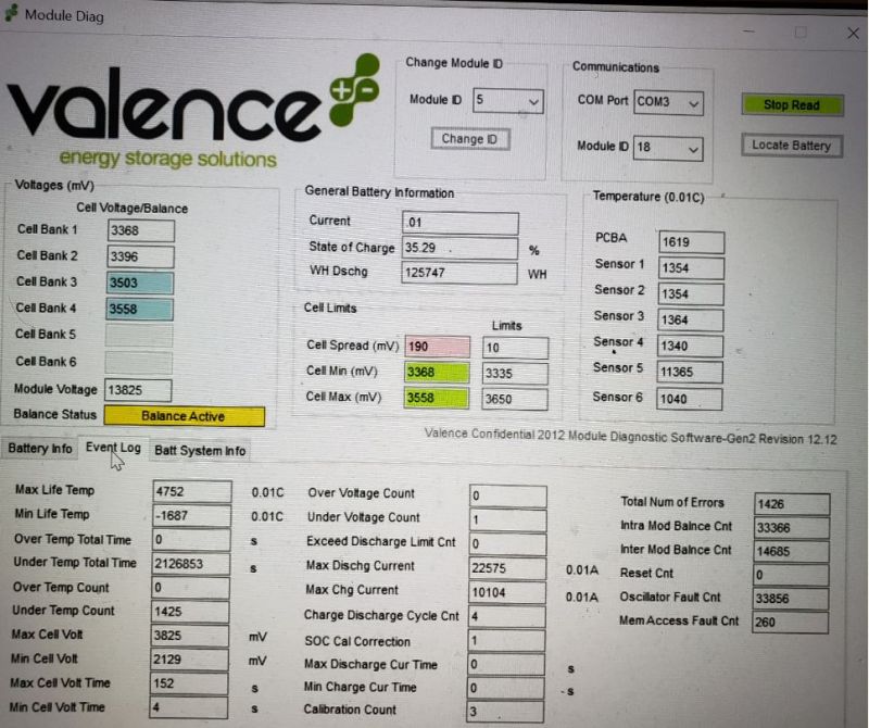

# Posted: 8 Mar 2020 07:51pm
Here's the readout from the battery that went red, unused since recharged. Mostly Greek to me but I see 1 under voltage count.
SHACKENIT
# Posted: 8 Mar 2020 09:46pm
Looks like you beat me at minimum cell volt of 2000mv. Cells look nice and balanced at 3.4. So I think were lucky to have this Valence software. I would monitor the battery while simultaneously testing a good draw, like a heat gun pulling 40A. I havent heard any horror stories with this chemistry but then I havent looked. Now regular LIPO batteries I could tell you some stories... Go for it
