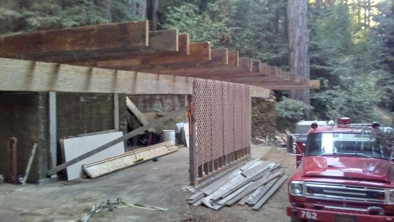

Thanks for the links and ifo guys. Well the Valence has been getting a workout, 60 hours powering the cabin. Grid power still out in the region. It's still at 13.0 volts, amazing compared to my old lead batteries. Looks like grid will be down at least another day, on the bright side I'm getting a lot done on my never ending carport project. I brought the Valence charger along, may run it with a genny if voltage starts dropping.

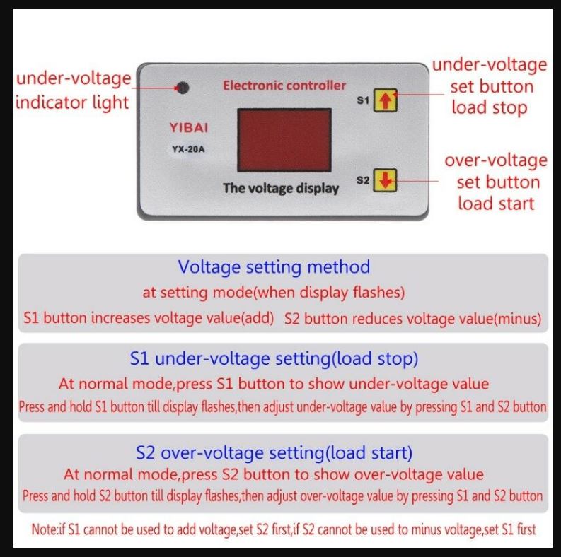

Well they turned the power on temporarily in the ghetto so I rushed back to charge the Valence and check out the low voltage cutout that had arrived.
May have a problem..the cutout is basic, set low cutout voltage, set high voltage cutout. I had my wife watch the meter at the cabin while I ran the pump for 5 seconds, 11.7 volts. This with the battery showing 13 in normal state but having been powering the cabin for a few days. Assume this won't hurt it?
If I set this voltage cutout to 12-12-5 volts is it going to shut off power every time I run the pump?
# Posted: 29 Oct 2019 03:09pm
Yes it will shutdown if you set it that high. I wouldn’t worry to much about a temporary drop under a load as long as it comes back under no load that shouldn’t be a problem. Ever watched the volt meter when you start your car. It drops a lot as well.
My low voltage alarm goes off on my fishfinder every time I start my boat but the batteries are fine. Just a drop under a load
# Posted: 30 Oct 2019 08:06am
Thanks FH. I'm familiar with lead batteries having that much voltage drop, just wasn't sure about lithium. Sounds like the voltage cutout isn't going to be much good unless I toggle around it for times of high draw.
