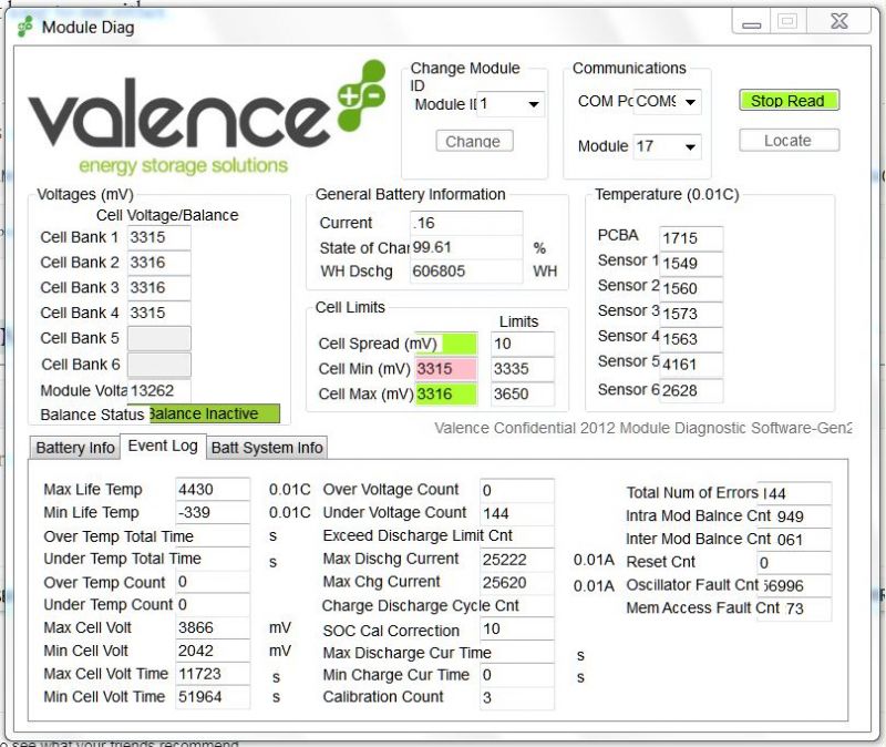

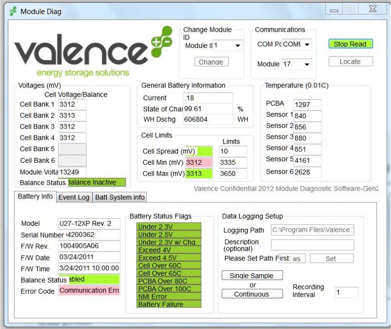

# Posted: 30 Nov 2019 16:14
OK, my USB port adapter arrived in the mail, got it hooked up and low and behold, here's my reading. I was only at the cabin for one day and night though and didn't shower so it didn't get it's usual workout. SOC says it's still almost 100. Everything else to me at this point in gibberish so if you see anything unusual let me know.

Quoting: paulz Everything else to me at this point in gibberish so if you see anything unusual let me know. That looks about what I see on mine. Things don't change much when not discharging or charging. Temp sensors 5 and 6, from what I can tell, are irrelevant since you only have 4 cell banks. Module volts is what your battery is. If you look at the event log tab you can see how many total times your module has been from 100% to, I think, 20% discharge. "charge discharge cycle cnt"
# Posted: 30 Nov 2019 19:29
I don't see anything it that field. Does say it's been under voltage 144 times.
somewhereinusa
# Posted: 1 Dec 2019 09:39
Quoting: paulz I don't see anything it that field. I think it's there but covered up by screen resolution maybe? I haven't figured out what all of the boxes indicate This is what one of mine looks like.
