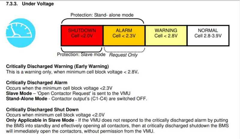

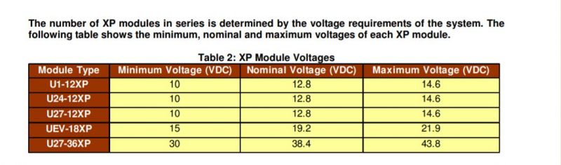

Been reading the user manual a bit more, found these regarding minimum voltage. If I have it right, the normal range is down to 11.2, warning range down to 9.2 and alarm below that.

Since the Valence batteries don't have any protection built in (only cell balancing),
My understanding from the manual diagram I posted above, 'stand alone' means the battery is not connected to a BMS, and Shutdown means it will turn off contacts if cell voltage falls below 2v. Is that not correct?

# Posted: 2 Dec 2019 10:31am
I think the internal BMS only does cell balancing. The UBMS, the unobtainable box that Valence won't sell to the likes of us, takes the information from the internal BMS and uses that information to control charging/discharging and safety disconnect. I bought one of the control boards out of a truck. It had a UBMS and some really nice 500A solenoids. Unfortunatly the UBMS was the high volt model and not something I could use.If I knew how to read the data from the CAN bus I could control my stuff from that data.
I'm just using external sensors to accomplish the same thing(I think). I'm not able to read cell banks, just the entire battery.

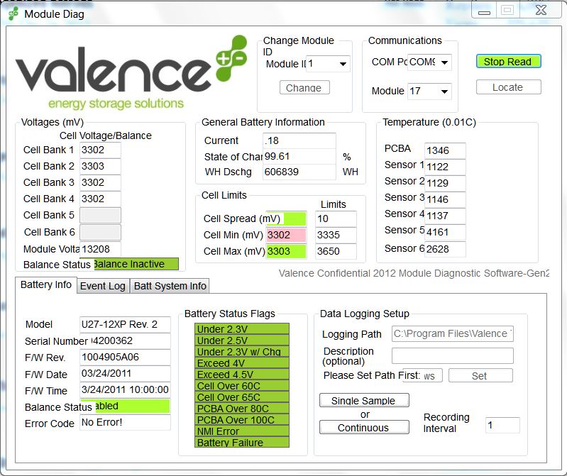

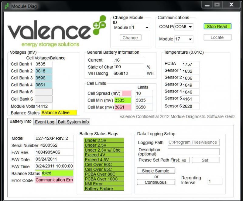

I took my battery off the charger yesterday, been sitting unused. Plugged it into the software just now, this is what it says. First time I have seen 'balance active'. Obviously cell 1 is different from the others..

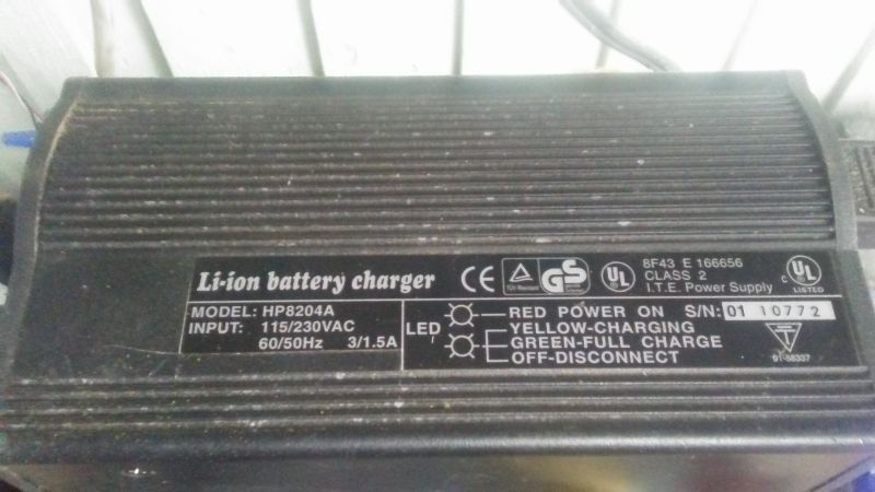

A lady gave me a charger, said it was 12v from an E bike. I could only find one reference to an HP8204A, on Ebay. Says it's 12v but I am skeptical. Lots of references to HP8204B at 24v. I thought I might leave this charger at the restaurant down the road from out cabin in case I needed to charge my battery without going back to the city (where my main charger is).
It does not say what the output voltage is on it, so I hooked it up to an old half charged 12v battery. Within 20 seconds it had gone up to 17 volts on my DVM so I unhooked it. That's too much for a 12v Lion charger, right?

# Posted: 20 Jan 2020 04:22pm
Yes that's too much. Do you have more than one battery? You could hook two in series for that charger. Although 24V at 5A is going to be slow and you won't get a full charge at 24V. You should be able check voltage with a voltmeter between the charger leads.

So this E bike charger I mentioned above, I'm sure it's 24v. Now that I have multiple U27s, if I hook two up in series I could use this charger, I assume, and charge until the green light on the charger lights.
I've never crawled above 12vdc usage so new territory.

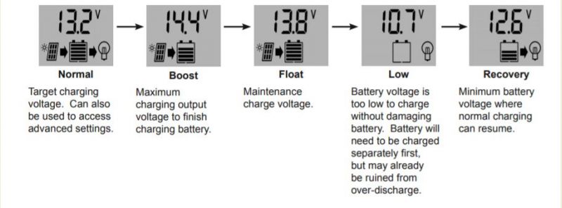

Any solar controller will charge lithium. Its only about the voltage settings.
If you can change the settings. You can charge lithium.
I like the Victron controllers as they have bluetooth programming (by a phone app) and give lots of reports which can be useful for tracking system/battery health etc.
# Posted: 29 Jan 2020 06:04pm
OK, I thought there was something special about the rate related to voltage. My controller is programmable, what would you suggest for these settings?
